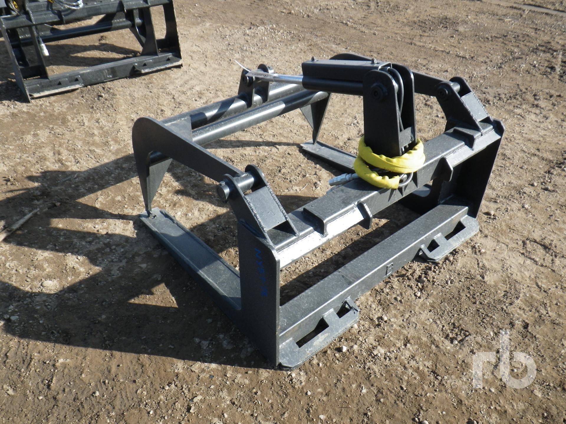

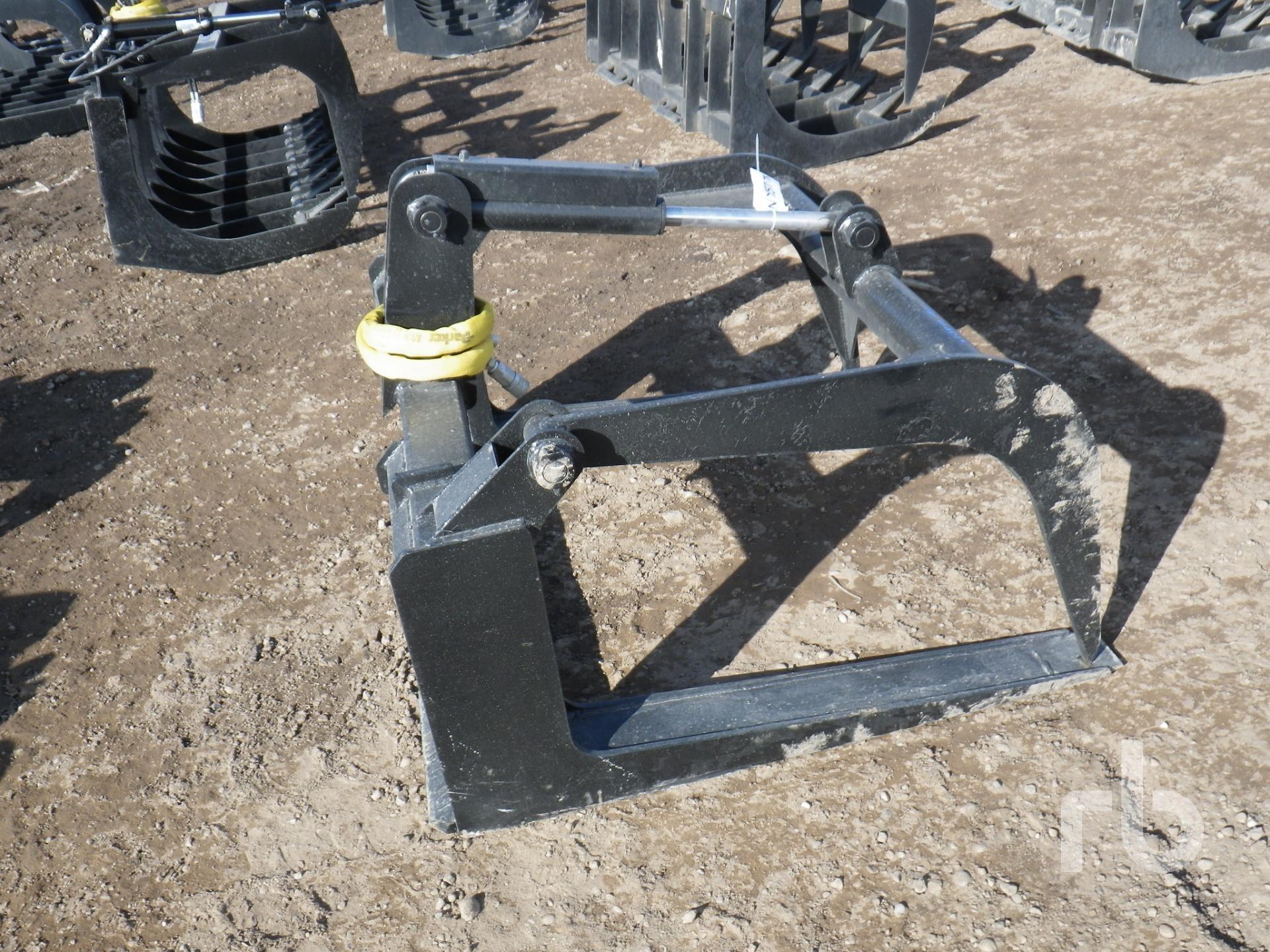

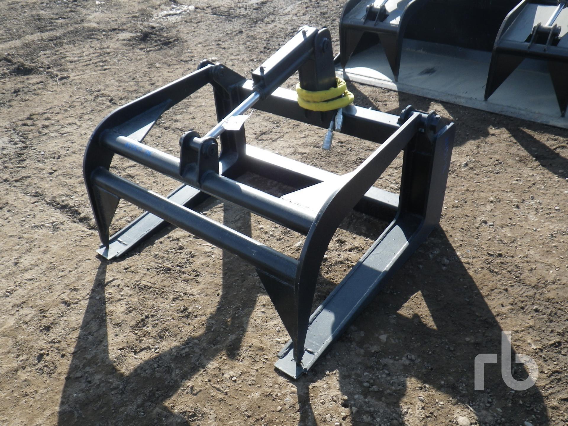

Very interesting idea. The ones I saw are essentially the same thing, only as a one piece design. The disadvantage would be that the forks are not adjustable and you always have the grapple. Still, $1600 is a little steep unless you need to use a regular set of pallet forks extensively and only want the grapple occasionally. The disadvantage of what you're looking at is a good piece of the fork length is used up by the grapple attachment and the load will be further out front, affecting the stability and the lift capacity of your tractor. I can't find how much they went for in the last auction, but here's what I'm talking about.
I bought my pallet forks in the auction. They always have a dozen or more new sets of SSQA pallet forks and almost as many grapples and grapple boxes. I had to pay a %10 admin fee on top of the $475 and then I had to pay the regular sales tax, which is %13 here.
