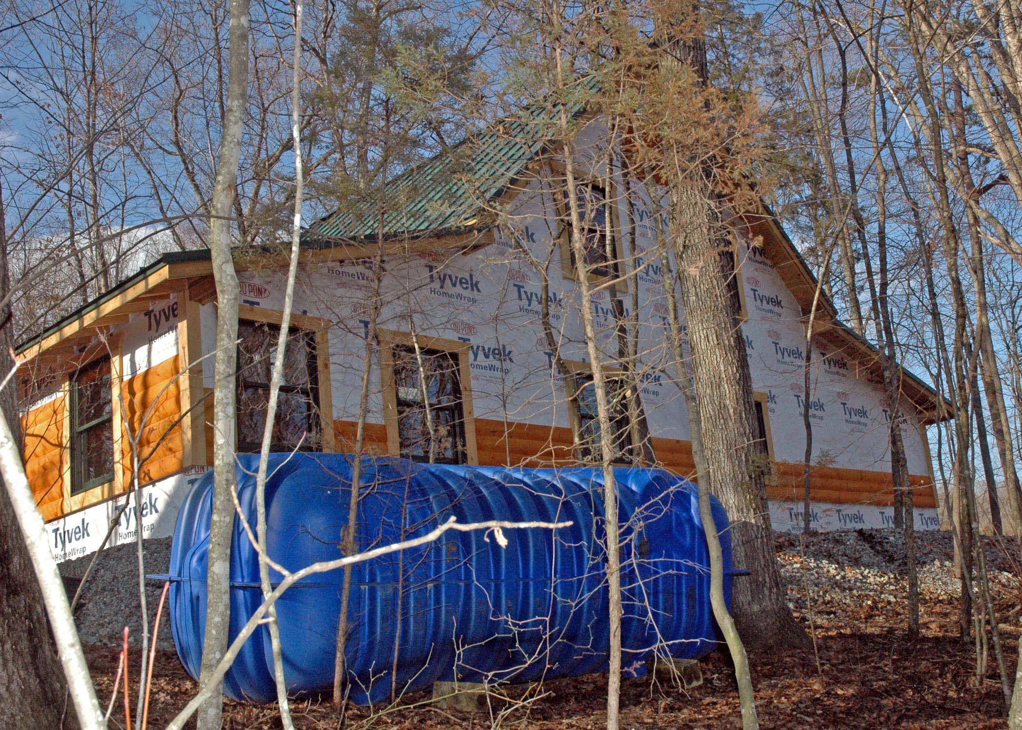

Richard,
You might consider a plastic septic tank. This spring I had installed a 1060 gal Fralo septic tank (FRALO Branded Tanks - Plastic Septic Systems - Roth Global Plastics) and drain field for a guest house in the woods. The tank weighed 520 lbs., cost $900, and has a 50-year warranty (purchased from Blalock's in Seviervlle 865-453-2808). I picked the tank up using only a 4'x8' trailer. The tank was 11' long and 5' diameter--nearly a perfect fit. A mini track excavator (Bobcat) was used to dig the holes for the tank and drain field. Because the tank was so light and made of slippery plastic, I was able to push the tank into the hole without assistance from the excavator. The total installation (including digging and filling 120' of chamber drain field) involved 7 hrs of excavator time and essentially no soil compaction. Just a thought.

Nice concept but wouldnt this be even more fragile than the old fashion cement septci tank. If I used something like this I would figure out a way to mark EXACTLY where the tank and field are located.
