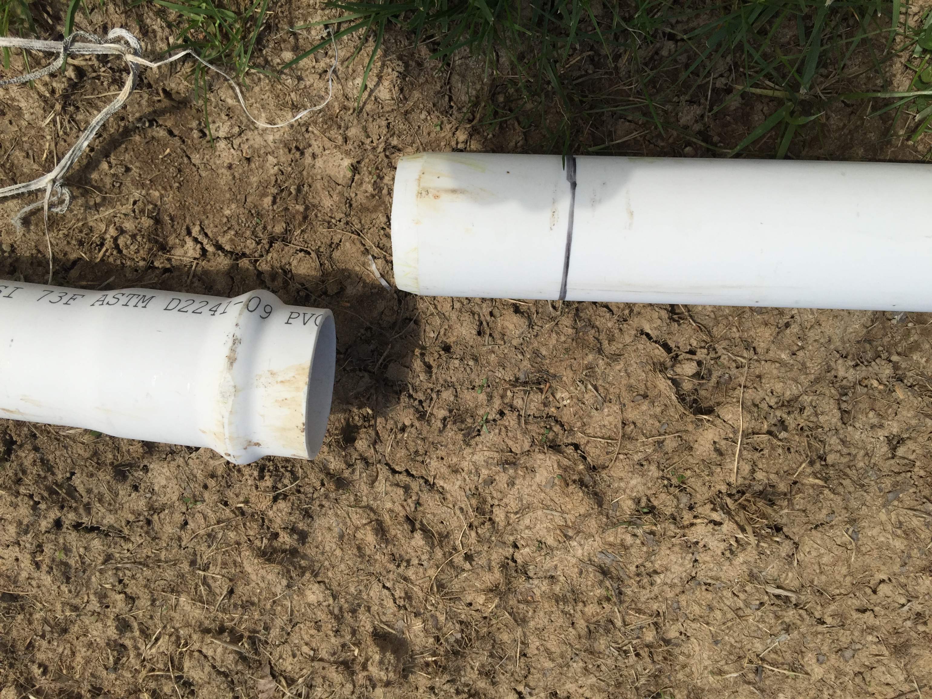

2)When I cut section to fit do I cut off beveled,filed end and use a cemented coupler to reattach it or do i file the end down and use no cement on anything except end cap at end of run?

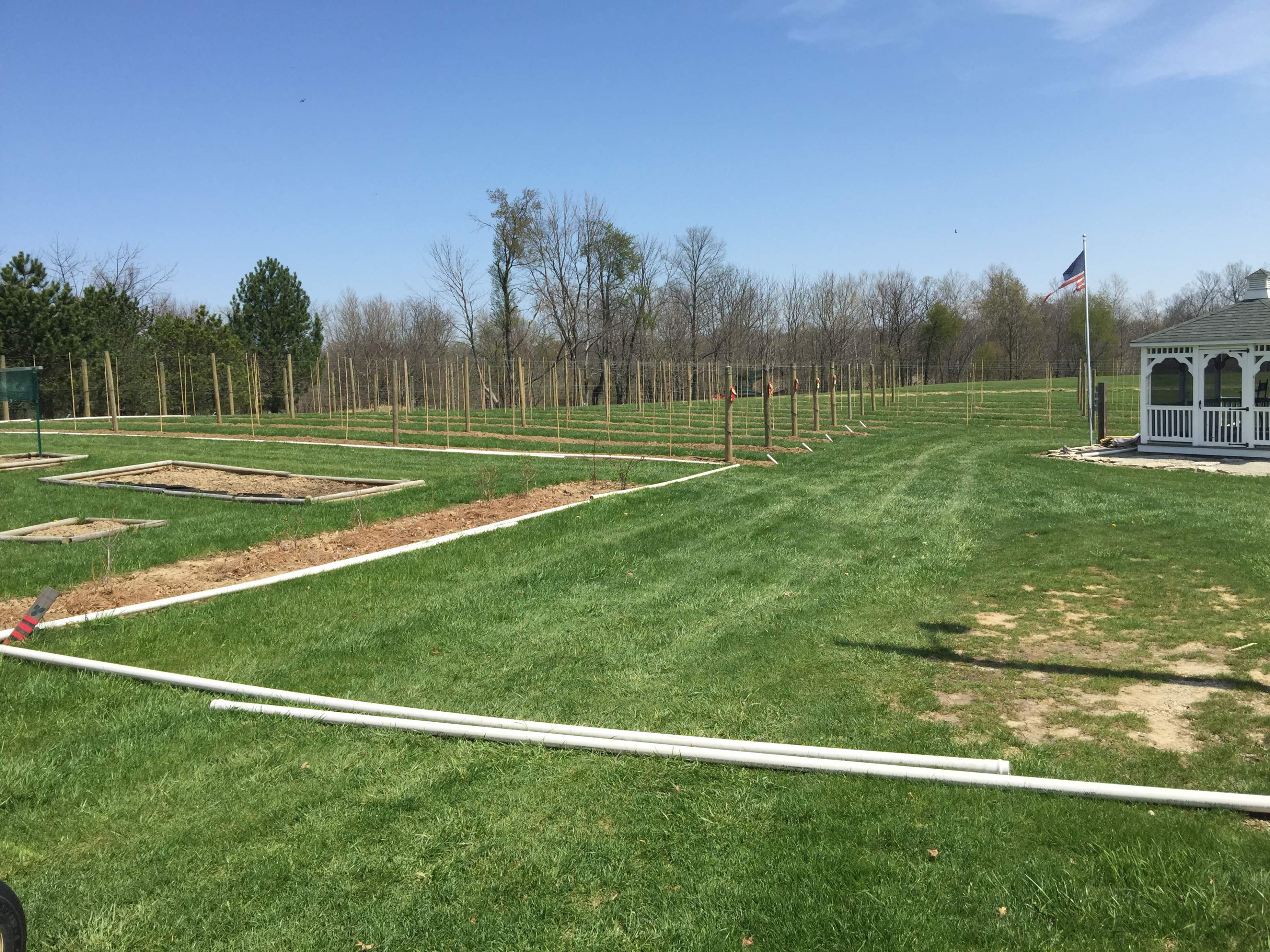

4) As I will be blowing out water end of season does it matter how deep I bury the pipe? I just don't want to see it, it's a vineyard in the backyard- few hundred feet of buried pipe, just as soon bury it 1-2 ft?

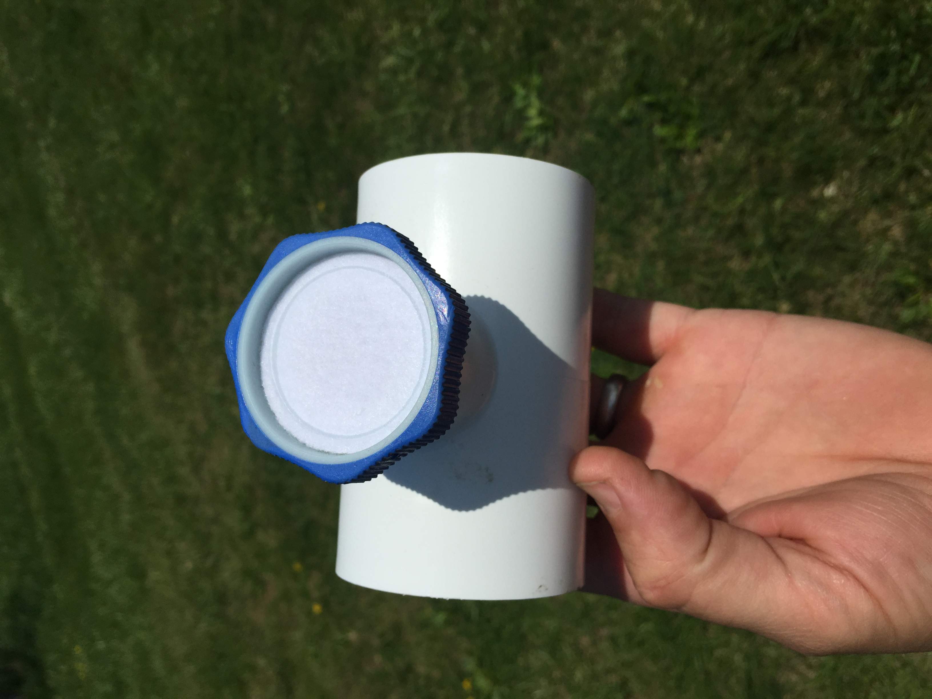

5) The King Drain pictured is supposed to go at lowest point, not sure where to put that, as end of PVC header row is low on one run, but lowest point is near spigot? Should I add another at each low point on the 3 runs? Do I
just use tape on thread and hand tighten that blue drain piece?
Cement is only used on non-gasketed connections.
That's fine.
The lowest point can be near the spigot, that's fine... it would "drain back" towards the spigot and empty there. Realize that you only need it IF you want automatic freeze protection and IF you angle all the pipes so they drain back towards the drain valve.
Since you'll be blowing it out/draining, you technically don't need the valve at all... but it's good insurance you never forget or a freeze doesn't surprise you.

I sure do appreciate you taking the time to respond ishiboo!! so on 2) should I use a file to round off end going into gasket like it looked before I cut it where i need to shorten 20 ft sections or would you cut off end and use a coupler to put that end piece back on to fit into gasket?
Thanks again for answering EVERY one of my questions!!
