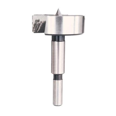

I want to make a couple short sections of fence [ 25 to 45 feet ] with 8" treated posts and running a 2" pipe thru them. I have 2 3/8" [ 2" rigid conduit hole saw ] that I could use, but it only will go about 1 1/2" deep before you would have to clean it out... then try again. Which would be a pain. I can get a 2 3/8" Forstner bit on Amazon fairly cheap.. and use that with a guide form to keep it from wobbling while I started it into the post. But was wondering if anyone had done this before and come up with some better way to drill something that big. Thanks...!!

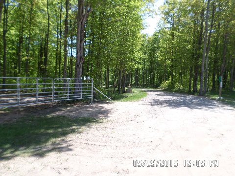

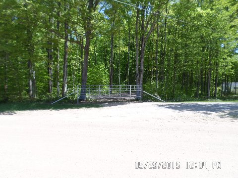

Sorry, I did not explain it clearly. Going to dig holes about 7' apart and install about 8" treated round posts. Snap a line about 42" up [ still up in the air on this height ], then drill the holes. Going to run 2" pipe at a height to keep horses/ATV's out around my new gate area. So the holes will be not be lengthwise in the post, but cross grain. I have quite a bit of 21' long sections of 1 1/4" galvanized drop pipe I pulled out of an old well, and I am thinking of maybe inserting this in 2" PVC to make it look better thru the years. Still in the planing stages... trying to figure out how I can do it stage... [ not quite in the buying stuff yet ].
Here is a couple pictures of the gate area, a new access road I put in for future logging/etc. trucks. The gate was overkill, but got them at the Amish store north of Mio Michigan for a lot less than a cheap gate at Tractor Supply. I still need to fill in the gate area later on when my dirt guy gets the time... It's mostly woods area, so just want something that will take a little abuse but look substantial enough to deter people wandering in my nice trail system.

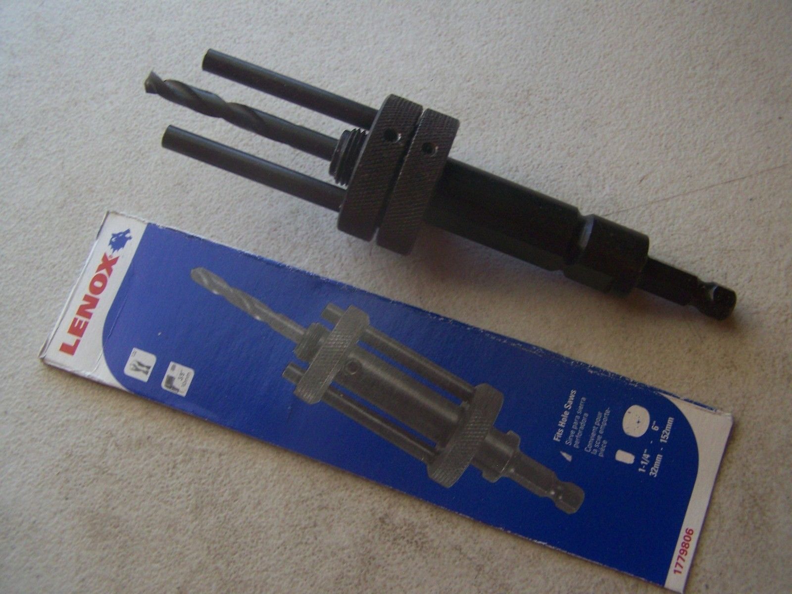

I just ordered a Lenox 2 1/2" thin nerf hole saw and a ejecting arbor from Ebay. I had a couple hole saws for 2" pipe [ being an old has been retarded electrician I got " stuff " ], but never saw an ejecting arbor before. After MANY YEARS of cussin' and cleaning out the plugs. Anywhilst, the arbor will fit all my old Milwaukee hole saws... so, maybe I will get some use out of it. Plus, it is longer than a normal arbor, so maybe it will reach mostly thru the 8" post. With using a hole saw, I can line up and drill a good centered 1/4" pilot hole before I start digging wood with the hole saw. AND, with the pilot, I can drill from both directions. Thanks for all the info... maybe later in the month I will start accumulating posts and digging holes. Thanks again, Jerry

a forstner bit will work, if they make them that large. i know wood furniture people use them all the time25e84fff-17e8-47c1-ba24-49ffb886891e_400.jpg
