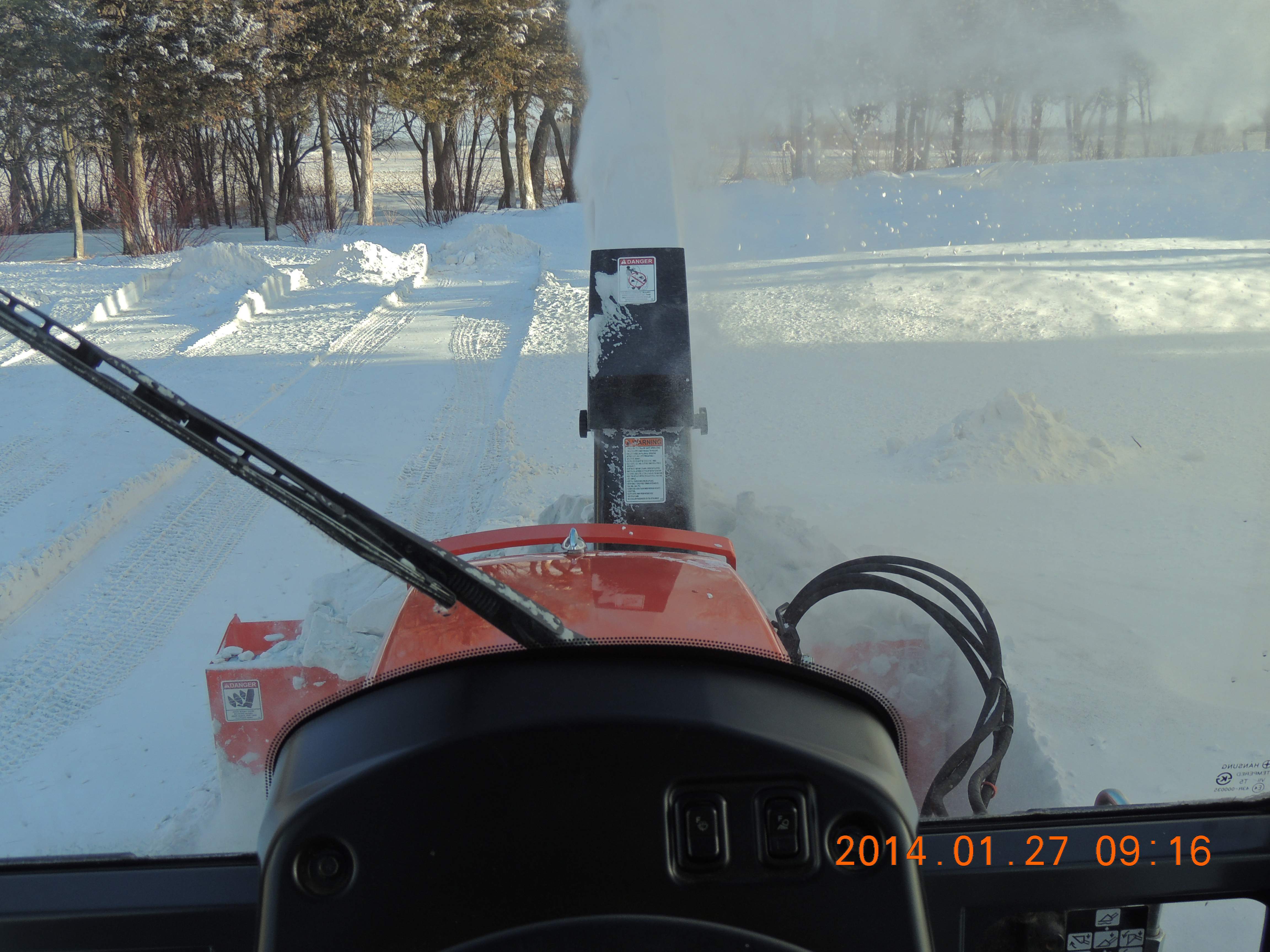

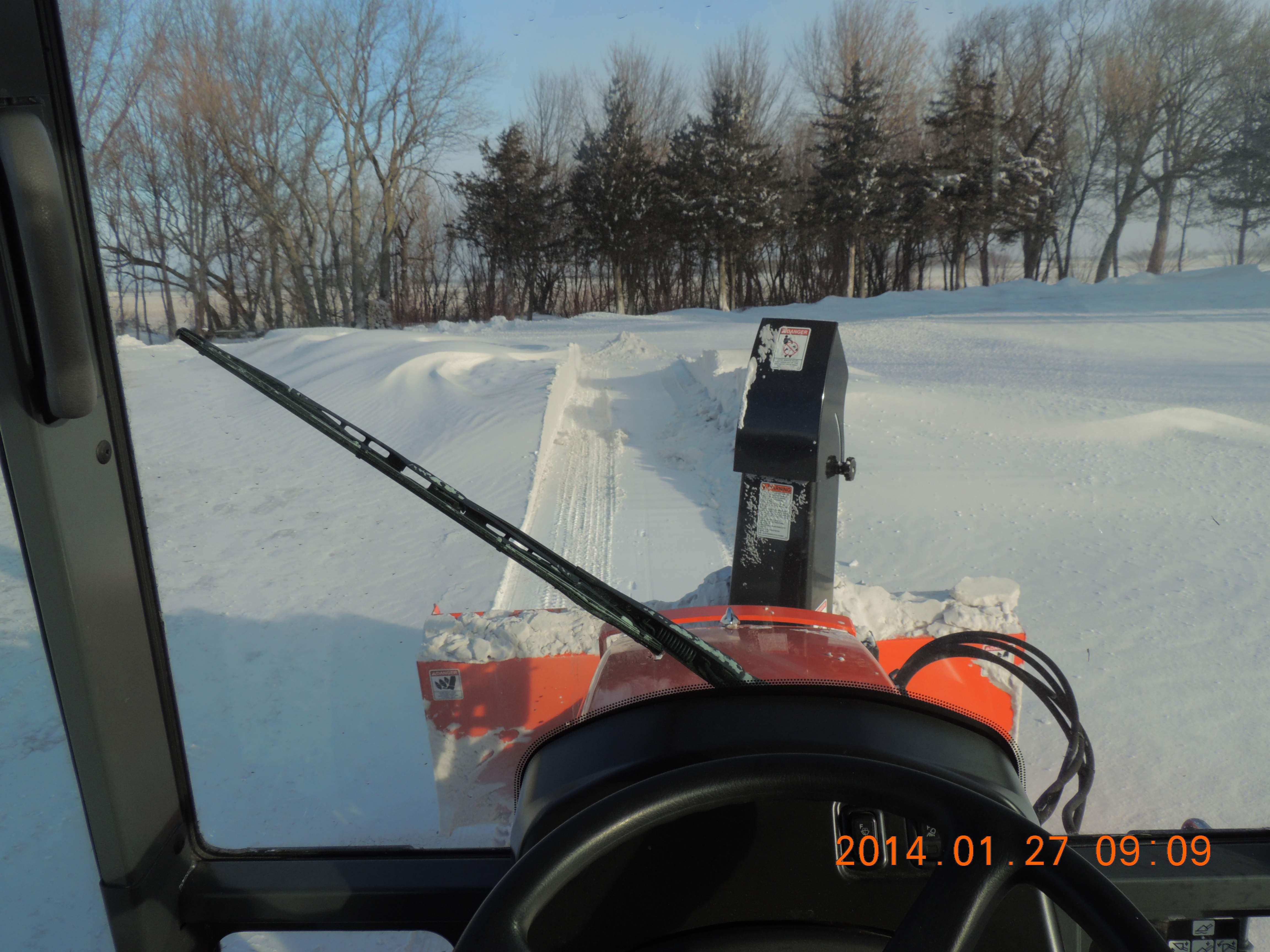

Cutting through this mornings hard packed drift....The right equipment makes Winter snow blowing a pleasure.

I have a long driveway that also gets drifts, although nowhere near what you get. I run a 60" rear snowblower with a 6 1/2' power angle snow plow on the FEL.
I love this setup as I can plow pretty quick with the blade ( up to 4" ) anything over 4" I use the rear blower and move the snow only once. No snowbanks or big piles or mounds.
Get the blower and you won't regret it!
