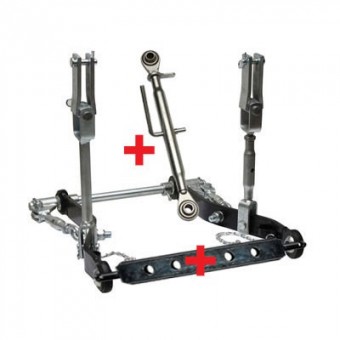

I am thinking of adapting a cheap aftermarket 3-point hitch to my 2003 X495:
Dema Set Drei-Punkt-Aufh舅gung KAT1 mit verstellbarem Oberlenker + Ackerschiene
As I am working in a company with a steel and sheet metal shop, I could have the rockshaft manufactured here. Does anybode perhaps has some measurements/Dimensions of the rockshaft included in the Deere CAT 1 limited 3pt hitch kit?

Boy there's a lot of goofy parts in a typical 3ph kit. As for the rockshaft specs, there's a lot going on there as well. Special D shaped oilite type pivot bushings with matching retainer plates, Specific angles and geometry for the rockshaft slot downstop pivot, as well as the orientation of the top link connect point. Personally, I'd try to find a complete kit, but if that is out of the question I'd look to purchase the rockshaft from deere.
