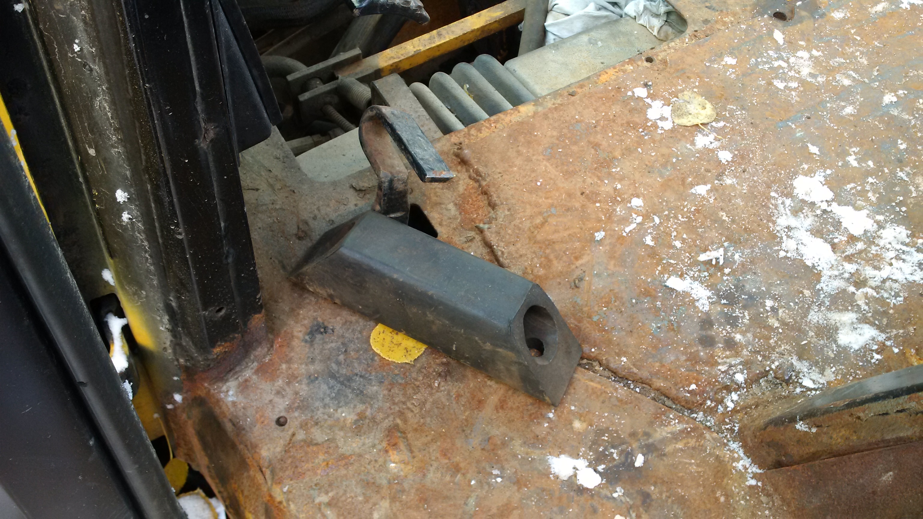

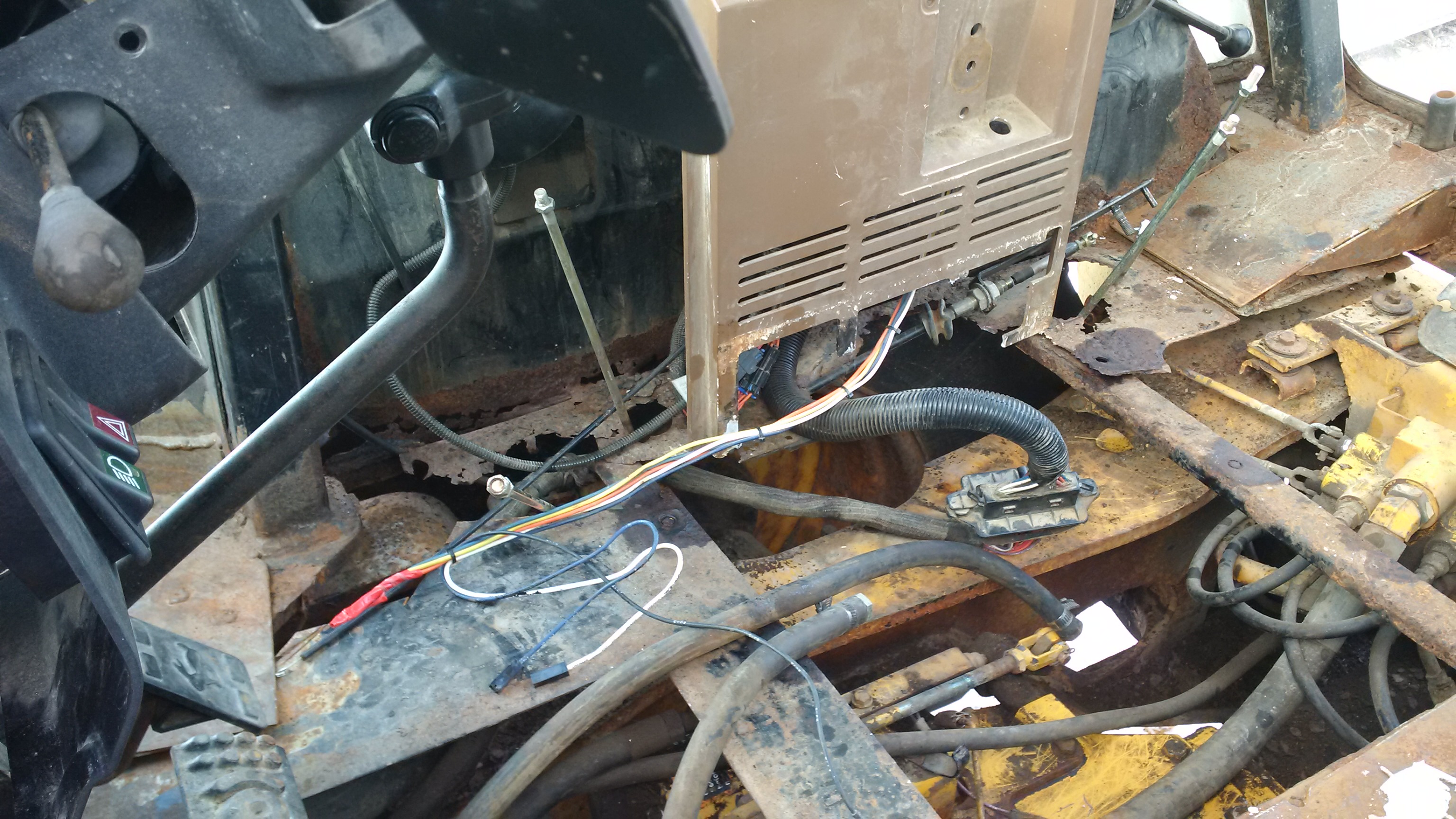

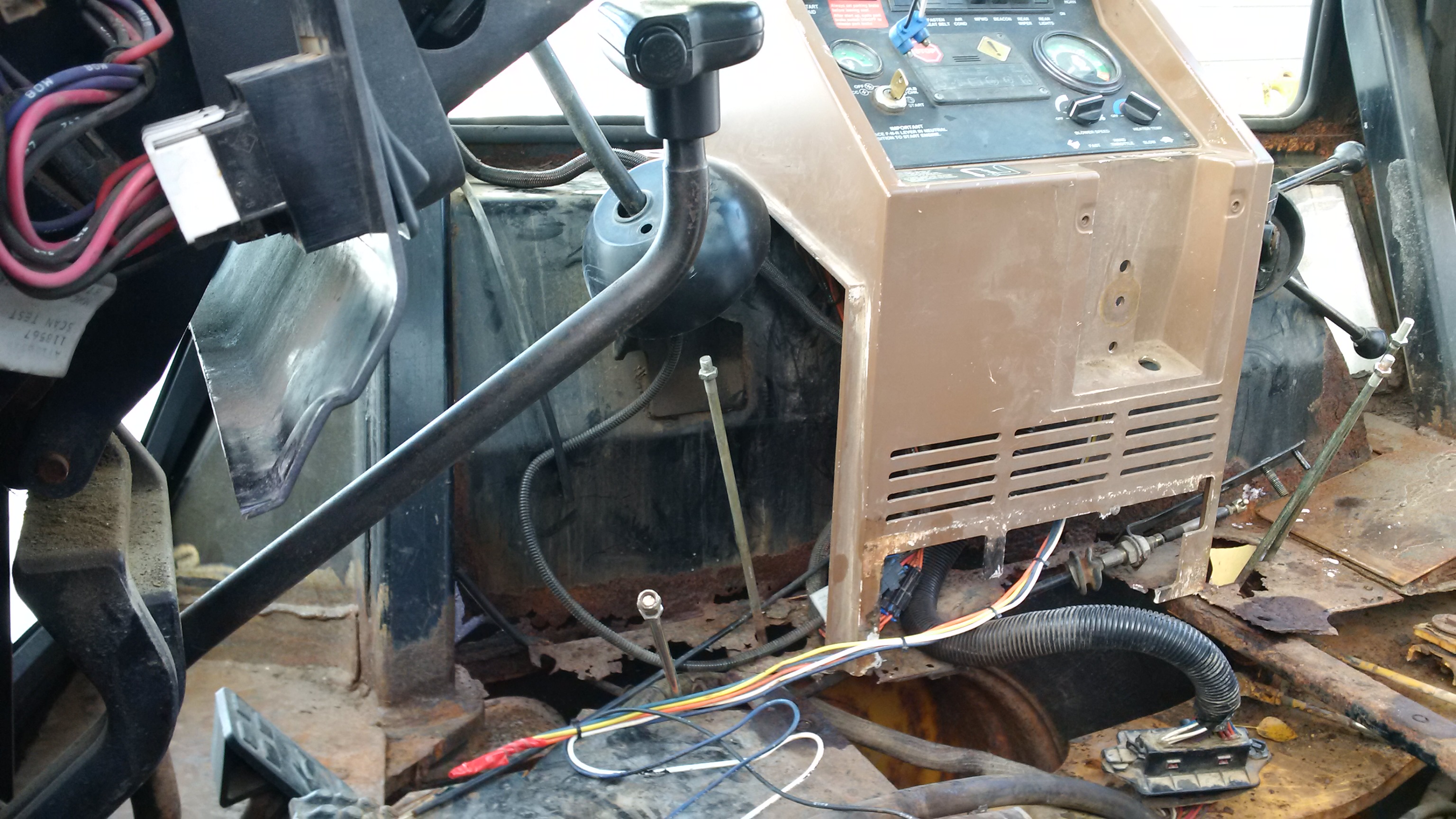

I have a 310D JD 1994 4WD model backhoe. I was paying a guy to do some fabrication work on the floor because it was really rusty, before he had chance to finish the job the guy got sick and past away. Currently the seat, heater box, instrument panel, bucket and outrigger controls are removed. I have no idea how to put the controls for the bucket and outriggers back together. Looking for drawings or pictures that may help. Please see attached and you will see the challenge that I'm facing.. I think the rubber mount in the picture is for the outrigger joy sticks but not certain. Thanks in advance for the help.

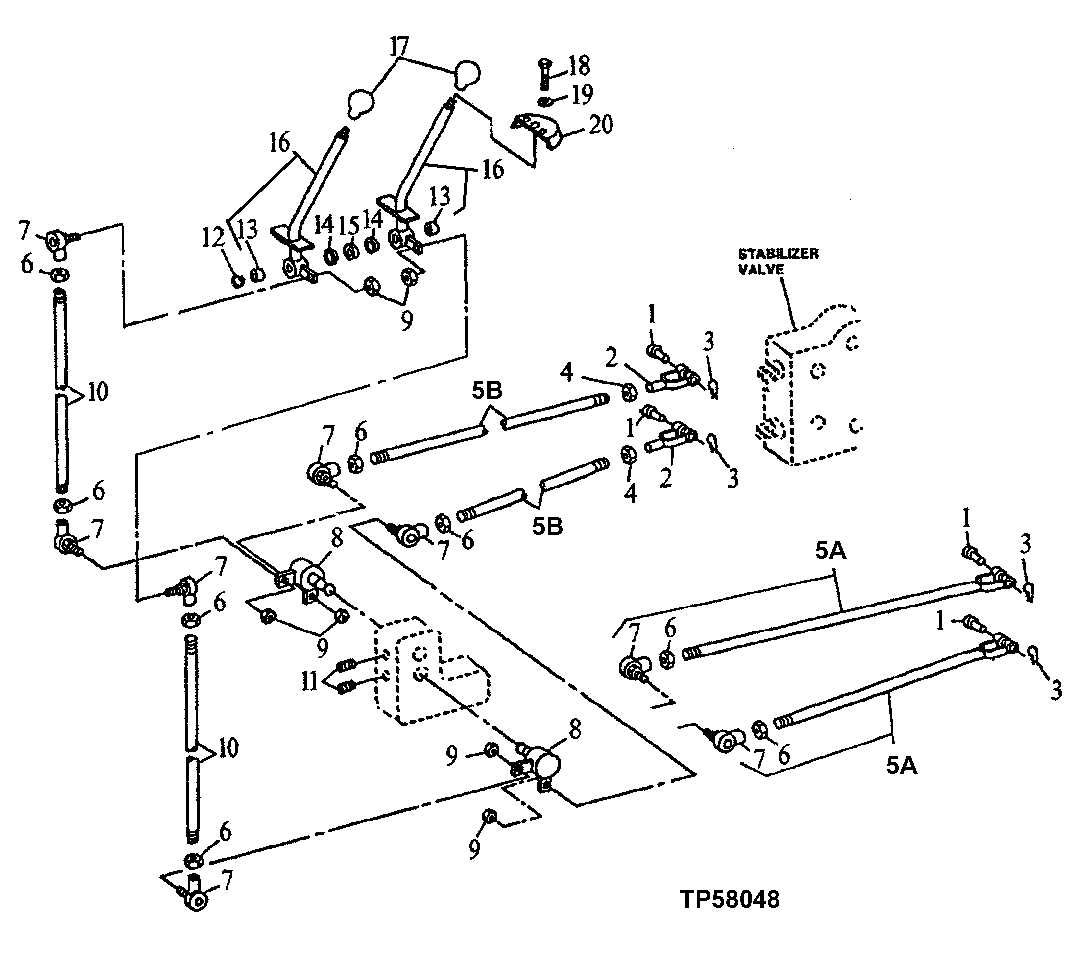

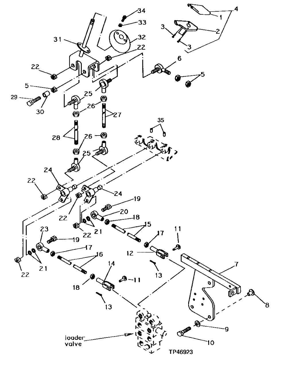

You need to go to jdparts.com Then put in your model 310D to find a parts catalog. There are several serial number breaks, so I just picked up to serial number 802199 for the drawings. These are examples of what's in the parts catalog online. First is stabilizer linkage, second is loader (I think that's what you wanted for bucket?) linkage.

If you need more drawings posted. Post your serial number so I can get the correct drawings. A John Deere dealer parts department can also print out these drawings. They should be able to show them to you on a computer screen and print the ones you want.
