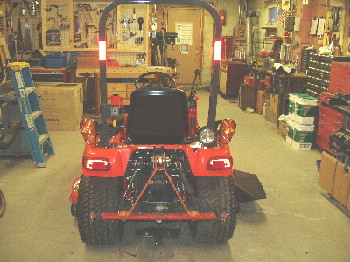

I am a little new at using a draw bar. I want to install a draw bar with a 2” ball so I can move my trailer around the yard. I’m assuming this would work? I also want to put a hook on there so I am able to drag some brush. Am I able to use a drawbar and my 3pt hitch this way. Will it hurt anything?
Is there any special way to connect it? Looks like I just connect to the swing arms and the top link is not used.
/ Drawbar??????? #2
You want to set it up this way for towing. See attachment
/ Drawbar??????? #3
Terminology.. I call a drawbar the thick bar thingy that connects under the center of the tractor and extends to the rear. Typically there are several settings that determine the length it extends to the rear. This bar has a large hole at the back end and will accept a trailer ball. It is ideal for moving trailers around... and you can also loop a chain over it and use it to pull the chain.
This is the strongest and best connection for such activity. Low center of gravity, etc.
You can connect a bar between your lower swing arms and that WILL work but you will discover that a bar on your 3pt hitch arms will rotate and thus it is difficult to align and connect a trailer hitch to the ball. The advantage is that the height is adjustable via 3PH.
However, you will need a way to stabalize the drawbar and trailer ball if you are going to do this a lot... there are various methods to do this. Most involve an addition that connects to the top hitch and thus prevents drawbar rotation.
/ Drawbar??????? #4
You really need your top link connected,if you use just a draw bar between 3pt arms can get real dangerous as draw bar can rotate ball can be forced off trailer and could ride up back of tractor going down grade. Do it like the picture no problem's. Have a good day

What everybody else said. A drawbar is great for plain pulling, but you need an upper link attachment to use a ball hitch. Otherwise the drawbar will spin out from under the trailer receiver.
I bought a "handi hitch" from redlandhill, they're all over e-bay. Basic model is $108+ship, photo attached.

for moving my boat trailers around I like my Paynes Forks clamp on trailer hitch, that way I can leave whatever is on the 3 pt on there or even the bh, one of my boats is around 5,000 pounds, BMT, and it moves around with no problem, this was $110 or so
when I do use my drawbar my dealer fabbed up a simple bracket that slides on over the drawbar and one of the 3pt arms to keep the drawbar from spinning, I will forward a photo when I get it, cost was about $8.00

This is something where you can go two ways: go fancy with something like the Handi-Hitch or the unit advertised here on TBN or go to a dealer such as Agri Supply and get draw bar lock for substantially less money, approx. $25 vs $100.
The lock that Agri Supply sell slips over the draw bar and clamps or bolts on the lower 3pt arm. Either approach works and each has different advantages.

You just need a drawbar lock to keep it from turning and you can use the drawbar just on the two bottom links. You can make a drawbar lock, or buy one. About this middle of this page is one picture.
