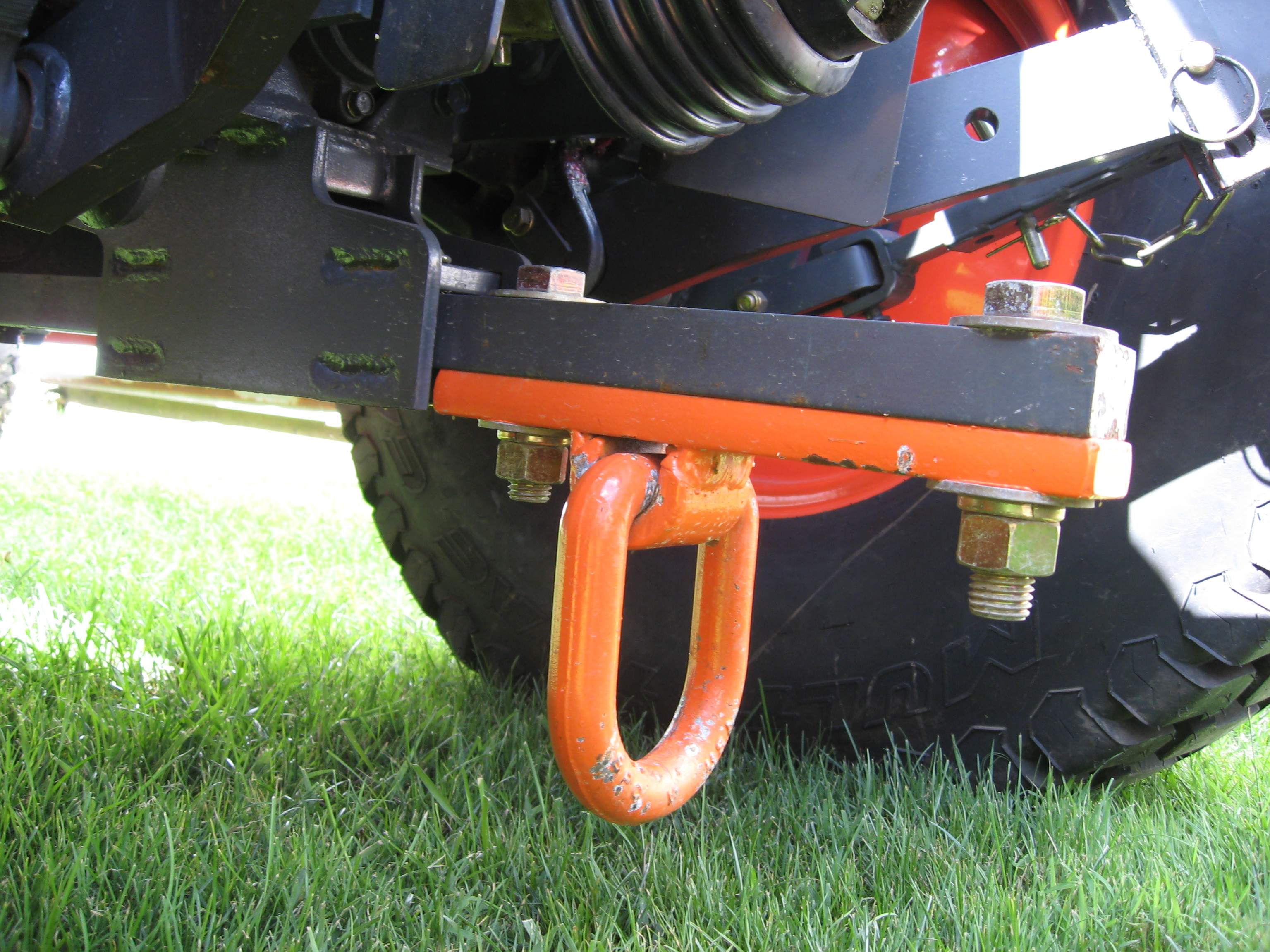

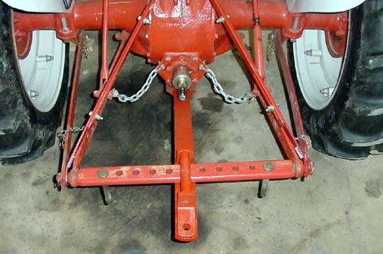

/ drawbar? #9
The 1st pic is what most people call a drawbar, mounts under the axle housing. The 2nd pic is a 11 hole drawbar that mounts to the lift arms. The 11 hole lift arm mounting drawbar is all tractor supply will have. The common drawbar (in 1st pic) will be Kubota oem or fabricated yourself. Fabrication is not too hard, I have made several for custom designs. Material can be ordered from McMaster Carr, then you just need a good drill press. Make sure you have the drawbar mounting under your axle. Philip.

/ drawbar? #14
There is a lot more engineering in a drawbar than many people believe.
This is a safety issue since the tractor can overturn in a heartbeat if a hard pull is hooked up incorrectly. Just getting it "below the axle" is no guarantee of safety no matter what anyone tells you.
The only drawbar I would ever use is a factory drawbar designed for the exact make and model of tractor it is used on. If a factory drawbar were available, a homemade exact copy might be acceptable, but the properties of the steel involved would always be a question.

/ drawbar? #17
CurlyDave makes a good point. Please take this into consideration. A sudden rotation of the tractor around the rear axle can have a lot of force and you want a proper drawbar in place "just in case."
/ drawbar? #18
The B3300SU in fact does NOT come with a draw bar but has the mounting point. You just have to supply your own draw bar. They left it out of the package for the same reason they left out the mid PTO and cruise control; giving customers a choice of what they want included in a package with pricing differences.
Like Verticaltrx said, they are not that expensive from the dealer if you choose to add it.
