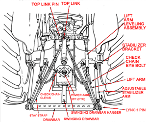

Has anyone ever had problems with a drawbar rolling over while attached to a trailer? Is there an easy way to keep it from rolling?

If you are talking about the drawbar on a 3 pt hitch, you can stop this in two ways. You can buy a bracket that attaches to each end.
Since, I don't want the drawbar to raise up going down hill you can also buy solid straps that run from the end of the lower arms up to where the top link would attached to the tractor. I use these and welded the drawbar to them at the appropiate angle.

(Drawbar lock for category 1 tractors; prevents drawbar on 3-point hitch from rotating)
Do a search of "SpeeCo" on TBN and you'll see multiple posts of this...
SpeeCo's picture of "drawbar" and "swinging drawbar"...

To answer your question specifically, a drawbar that attaches "only" to the two lower lift arms is not designed for this purpose. If you want to use it with a ball, you'll need to accomodate an attachment to the third point to stablize it's position or use some special brackets that work down at the attachment points to the lower arms. I'll add that using the configuration it appears you are trying can actually be dangerous if whatever you are towing "disconnects" and either goes backwards in an uncontrolled fashion, or comes foward toward "you" with the hitching point raised in the air.

I have a draw bar lock like others have described and pictured. It works fairly well untill you start heading downhill and gravity forces the trailer towards your tractor and the lift arms raise up in response. Twisted up the drawbar lock and did minor damage to the tounge of the trailer. I now use a fixed drawbar.
