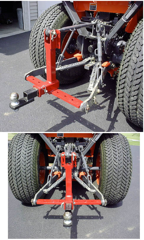

Anyone have any experiance with cross drawbars? Would like to use one on a quick hitch.

I use them but only problem is u need
so kind of anti-roll device if using a ball
type hitch.
Also trailer can push up on hitch if not
enough tongue weight.
There are plenty of posts on this before.

How you would ever use this on a quick hitch is a mystery to me, because it seems it would get really complicated.

I do not want to take the quick hitch off since I use this a great deal. I was hoping the cross bar would attach at the lower two points the same way any other impliment would attach /w3tcompact/icons/frown.gif. Thanks for the information /w3tcompact/icons/smile.gif

You could try one of these. (see photos attached) I made this one last summer.

The draw bar would attach in 2 lower
links, does your Q-T have sleeves that
go over the lower links.
What are u going to pull w/ drawbar?
   / Drawbar Question
#9
There are sleves that go over the lower links. Would like to be able to pull a small trailer that I used with my old lawn tractor.
