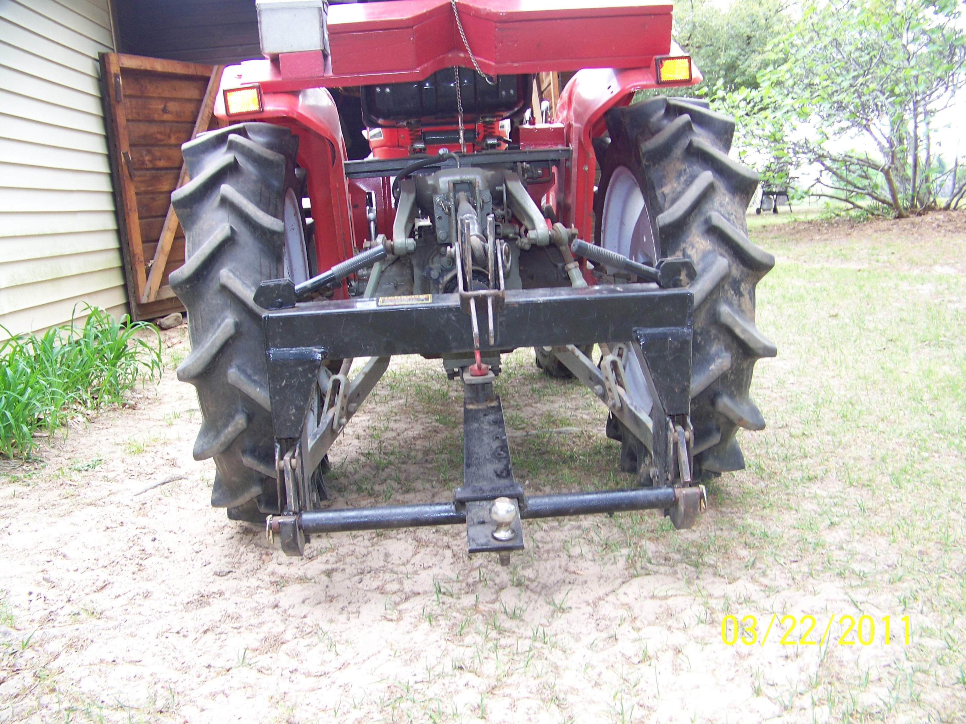

Here's what I did
I've got a bunch of other attachements including a winch, grab hook, shackle. I wanted to have a longer hitch for safety reasons. I figure the tractor's not going to tip over backwards if the hitch is long enough.
More pics here:
Rear Hitch pictures by jasch - Photobucket
Jim
