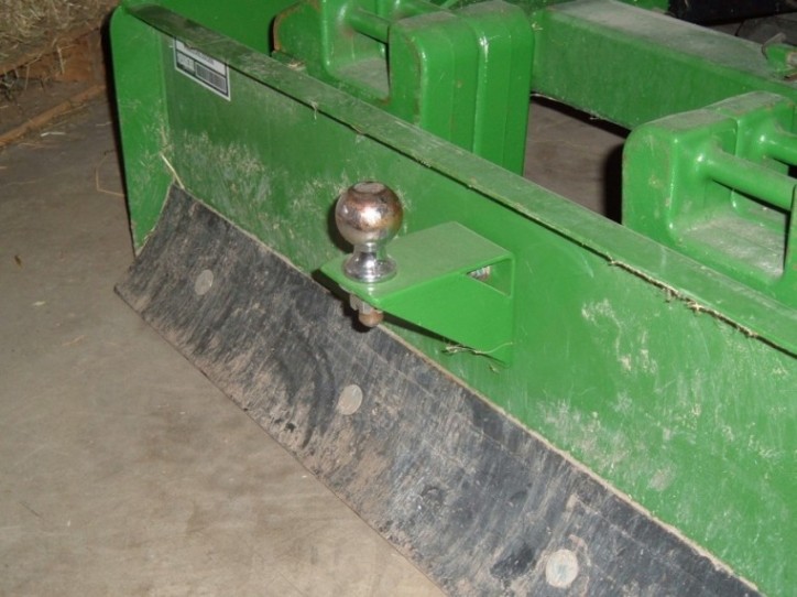

   / Drawbar for moving trailers around property? #8

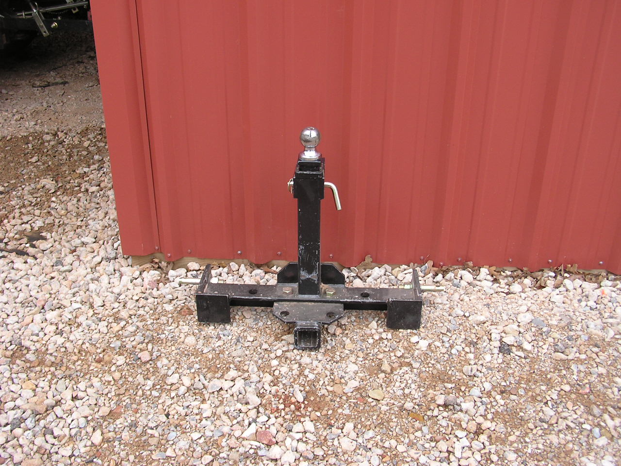

It's not too hard to make an attachment for existing implements.

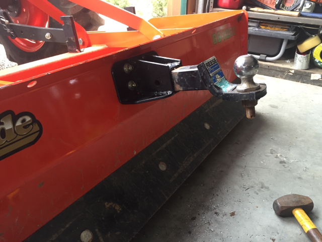

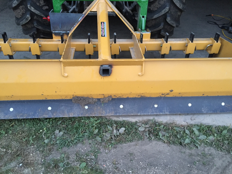

   / Drawbar for moving trailers around property? #9

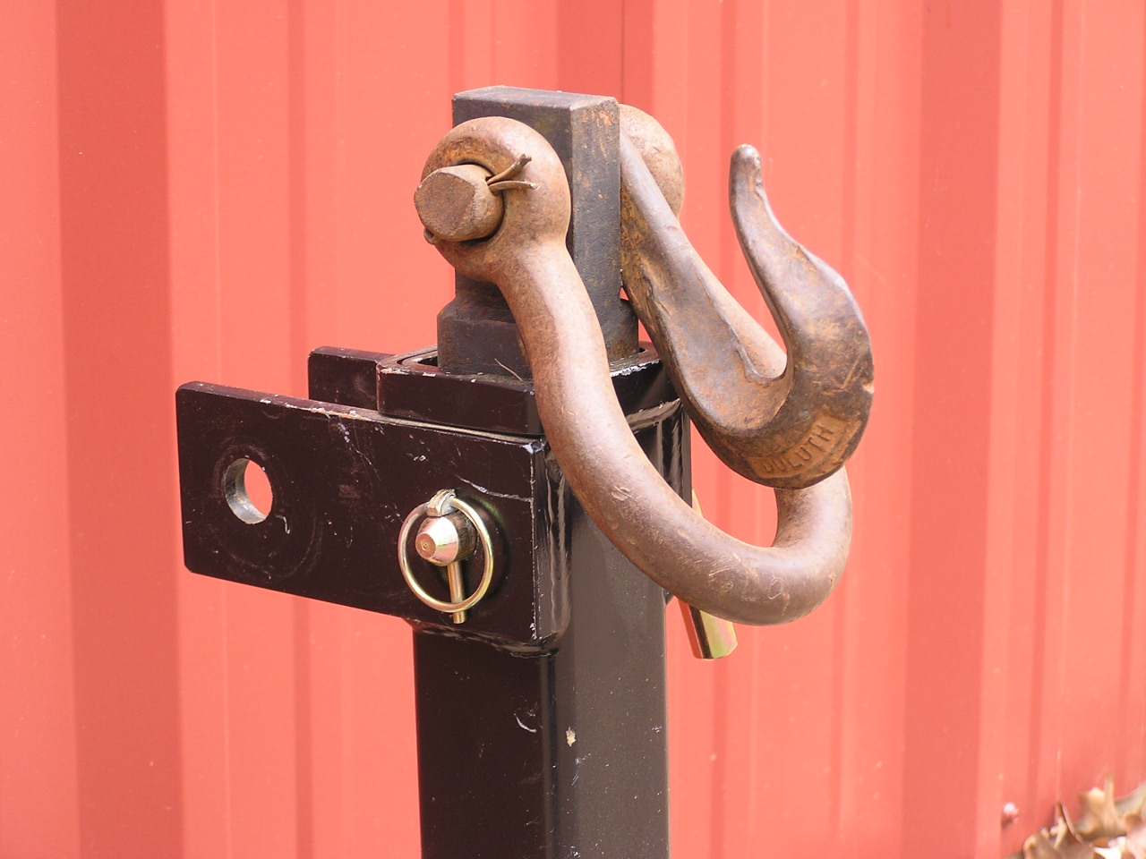

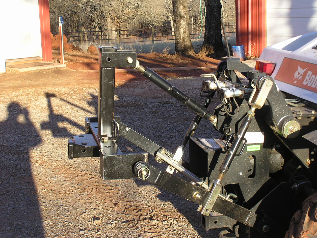

I use this one all the time.
