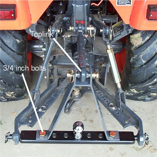

The fixed draw bar on the BX2200 is impossible to use with a ball hitch. Where can you find a CAT-1 3-Point draw bar that uses the top link also.
   / Draw Bar for BX2200 #2
Look at the one from BAd River
See if it will work for you. You have to supply the drawbar, but they're $20 at TSC.

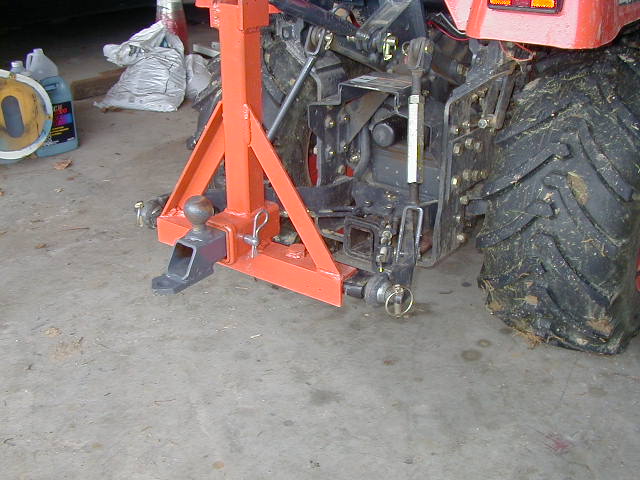

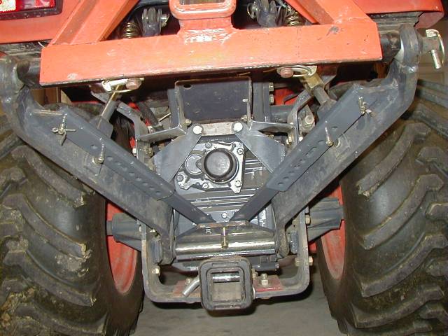

   / Draw Bar for BX2200 #3
Here is a homemade one.

   / Draw Bar for BX2200 #5
</font><font color="blue" class="small">( E-Bay $69 plus shipping
E-BAY )</font>
For the slight difference in price, the quality of the Mad River unit is far superior. With the one on e bay, you have the problem of the trailer pushing on the bar and the bar rising. Mad River has resolved that problem with their design.
   / Draw Bar for BX2200 #6
Another problem with the ebay one and the one that I made is that when you make a sharp turn the trailer tongue hits the the support. It works OK as is but you have to be careful when making turns. I plan to solve the problem by adding an extension off the draw bar to mount my trailer ball on. The Bad River unit is a better design.
#9
Thanks for all the replies. Checked with 3 different dealers today JD,MF/Kobota, and Case and none had any type of factory attachment for a trailer. My dealer, Kubota has been welding clips to a TS drawbar to pickup on the gussets on the lift arms. I am not going this route as the trailer ball would not be square to the world. Think I will try the Bad River attachement even though I did not want a receiver hitch. Thanks again for your help. By the way, checked out the 2230 today and it is only a 2200 with cruise control. Big Deal!
