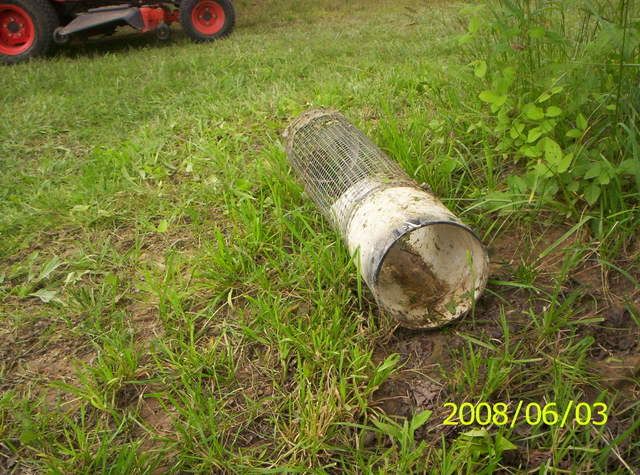

This is what I use to keep leaves from getting into my Culverts and Drain Pipes and plugging them up.
   / DRAIN PIPE & CULVERT Leaf Screen #2
Nice Idea.
I would also used it for keeping the critters out.
field mice etc..
nice job.
johnnylight said:
Nice Idea.
field mice etc..
*nice job.
* Thanks.
If I had it to do over agan i would not have drilled the holes in the cap as the screening is plenty of opening into the pipe.
The screening is held in place by two large hose clamps one on each end of the screening.
