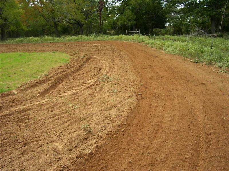

I will be using my tractor to drag it. The only use I have for it is to cover up seed in wildlife food plots after discing.

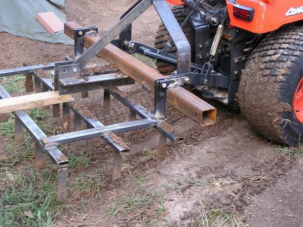

Here's one I built. The thing I like about it is I can use it forward AND reverse. Works well when I'm getting ready to plant grass seed in an enclosed yard.

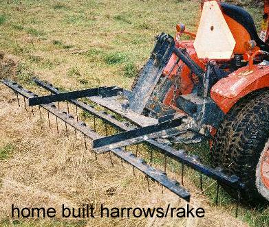

Maybe I can come up with a mod to my King Kutter el cheapo rake to use it as a harrow.
Pat

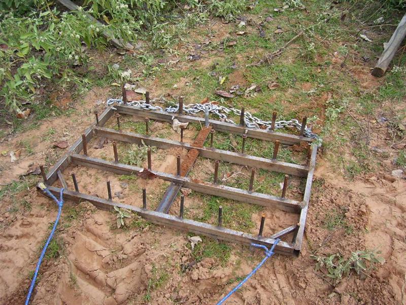

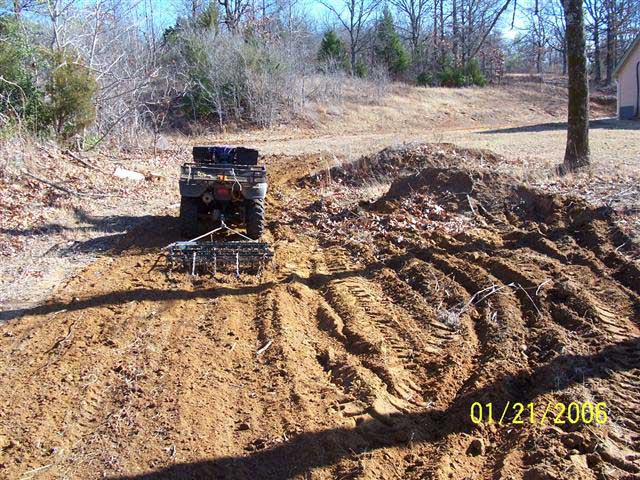

They are pretty easy to make. Basically just a frame with a couple cross members so you get 4 rows. Then weld some spikes alternating them each row. This is my old one but I don't have a picture of the new one. 1x2 tubing instead of some cut up T posts. On the new one I used some metal spikes (1/2" solid). When I ran out of those I used some old head bolts that were about 6" long. The new one looks better but they both work the same. They REALLY help smooth out things with the alternating spikes.
And I like to pull it behind the ATV, easier and faster.

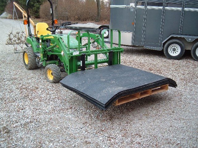

I do the same thing Davkir does. These are sometimes refered to as a chain harrow. I got mine thru a local tractor dealer. It is 6' wide by about 5' long and If I recall it cost around $200. If you go this route,You want to look for the rod material that they are made out of to be 1/2" to 5/8" in diameter. I have 2" heavy wall pipe thru the loops at both the front and the rear of mine. The front pipe has a length of chain from each end to a ring that attaches to the drawbar. The rear pipe has a length of chain from each end that attaches to the end of the boom from my post hole digger. My PHD boom doubles as a nice utility boom when the PHD gear head is removed. Being attached to the boom in this fashion serves two purposes. I can lift the whole thing up off the ground to back up. I can also drag it backwards if I want. Being attached out at the end of the boom, the boom forces the harrow to the side and keeps the forward drag chain from catching and being drawn up onto the rear tire treads if you try and corner too tightly with the drag on the ground.
I like the chain harrow as it is versatile. The teeth are at an angle on one side only. You can drag it teeth up for smoothing such as I do on my gravel drive from time to time. You can drag it teeth down and pointing to the rear. This roughs up and moves the soil around a bit but dosn't catch too much debris. Or you can drag it with teeth down and angled forward. This is a more agressive cut and picks up a fair ammount of debris in the teeth. When mine loads up, I just lift the boom on the 3PH and most of the debris just drops out. I have started doing this around my brush piles to bring in quite a bit of the smaller stuff and dead grass weeds and branches.

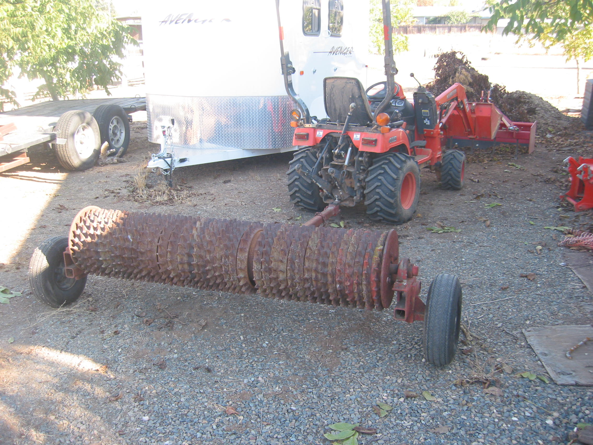

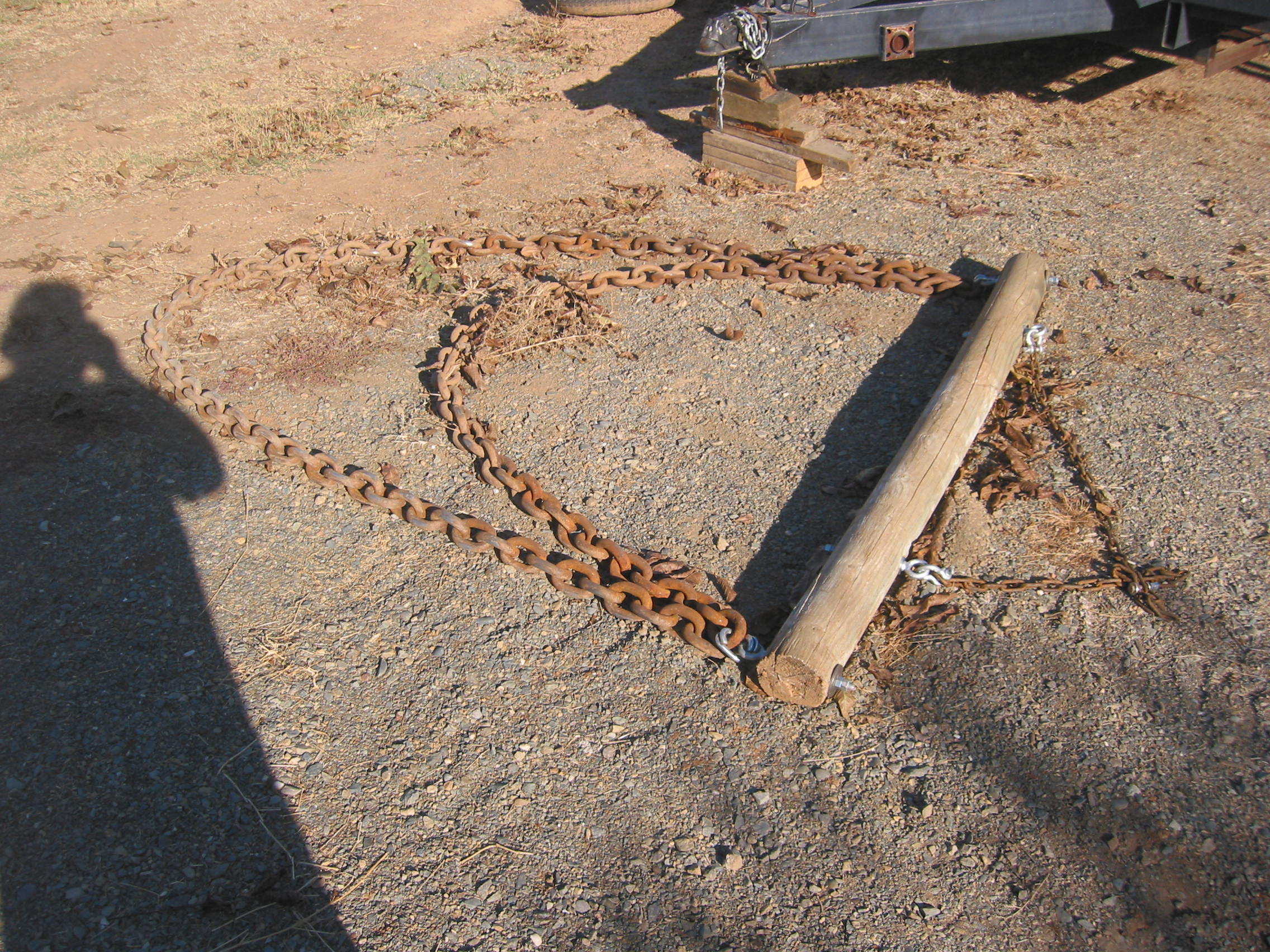

I made this drag out of some 5/8" chain I that was on a pallet of stuff I wanted at an auction. I have added three more old posts and looped the chain around again for three lenghs of drag. Works real good leveling and breaking up/spreading horse droppings
http://www.tractorbynet.com/forums/attachment.php?attachmentid=63608&stc=1&d=1162088424
but for breaking up clods and covering seed I love my ring roller.http://www.tractorbynet.com/forums/attachment.php?attachmentid=63609&stc=1&d=1162088476

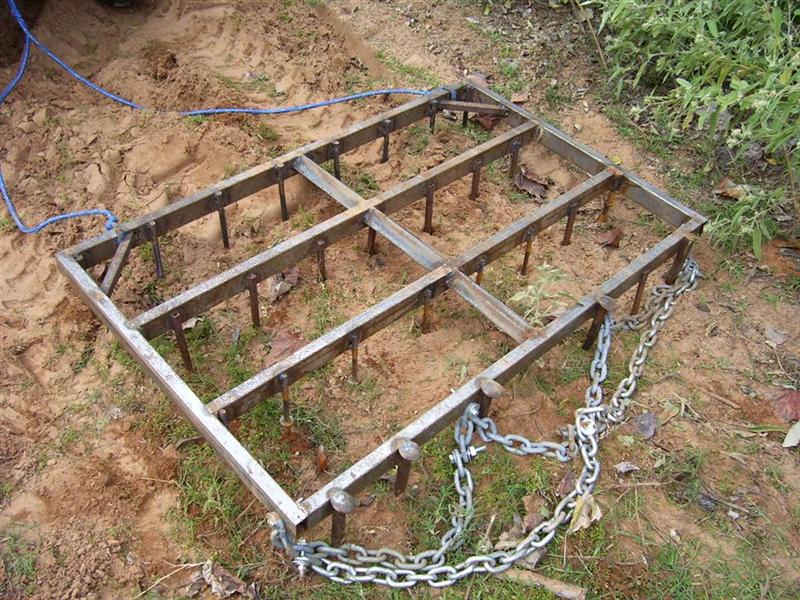

Here is my new one as mentioned. Works best behind my ATV.
