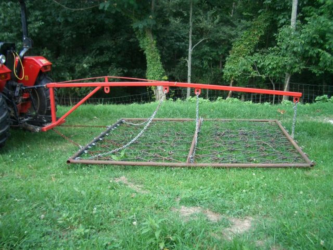

GregG:
Can you post a picture of your chain drag with details on chain size and the speed you drive.

/ Drag Harrow #7
gordon21 said:
GregG:
No problem. By chain size, perhaps you mean diameter - I wouldn't recommend investing in anything less than 5/8" hardened chisel point steel. Keep in mind though, all this takes horsepower to pull.
Speed? Fast as I can for the conditions. You can go a lot faster over a level gravel driveway than you can pulling through pasture grass uphill.
//greg//

/ Drag Harrow #9
I use the same as Greg and Dap (5/8" chain harrow) with the tines up for the driveway. Works great. I like these cause they can be used tines up for smoothing, tines down and back for lighter cutting/harrowing and tines down and forward for a more agressive cut. Mine is made by Rankin equipment co but there are several manufacturers out there. Mine is 6' wide and 4' long. And I can just get away with pulling it on the driveway with a 27HP sears garden tactor. The 28 Horse Diesel dosn't even know it is there:) Cost a little over $200 for just the harrow mat. I used some scrap pipe and chain to connect it to the tractor and I use the boom pole assembly from my post hole digger to lift it off the ground.
