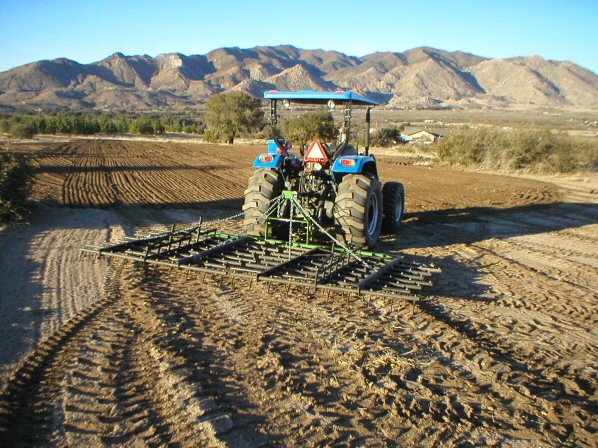

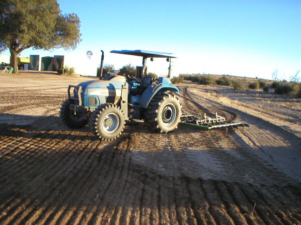

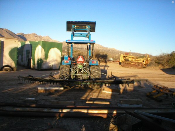

I have a 15'x6' spiked tooth harrow . Are you looking for something more rigid or a chain harrow?
