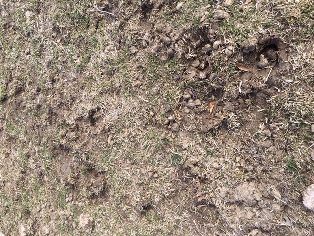

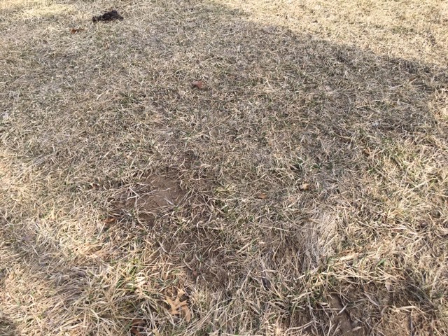

Well here's what the field looks like now in and outside the pasture area. IDK as was mentioned grass seed is expensive and it wasn't in terrible shape last year I'm just wanting to keep things up so it doesn't get that way. Planning on spraying a pasture safe herbicide as the weeds start coming up.... they're not terrible but I have some huge swaths of goldenrod I want to get rid of- mowed them down last fall but it might have been too late. One method I'd been given for weed control was seeding in bare spots to keep weeds from having a place to take hold.
Like I said I want to keep it up but I don't want to throw many hundreds or even thousands into this for marginal improvements
here's what it looked like back in the fall...
