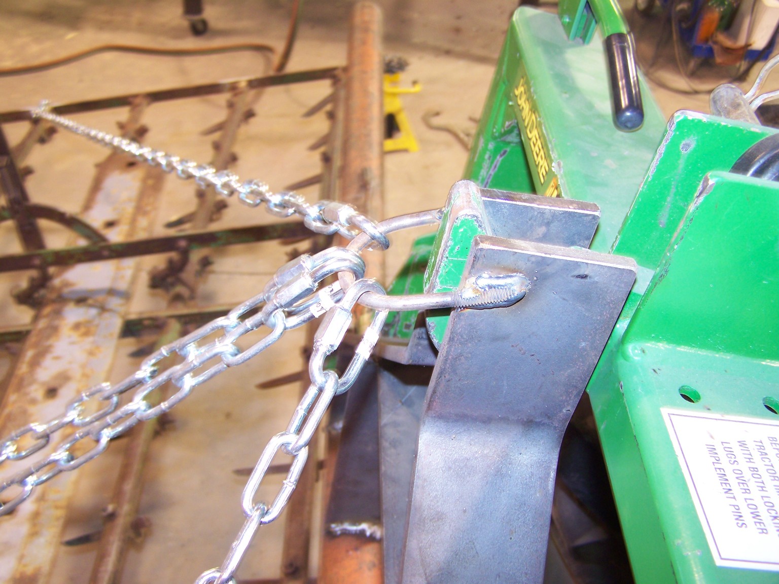

Update to the harrow conversion.....
Got the frame all bent and welded Friday nite, chains installed and tried them out on Sat for a bit. Still need to adjust the chains a bit, but with the qwik links I can adjust that easy enuf. So far I love the idea of finally being able to cross my gravel drive without tearing it to shreds, and being able to use reverse to get to ALL corners of pastures and around the barn!!!!!
I used 3/8" x 3" flat bar for the frame and added the additional square box inside the A-frame to help stiffen things up. Here's a couple pics....
