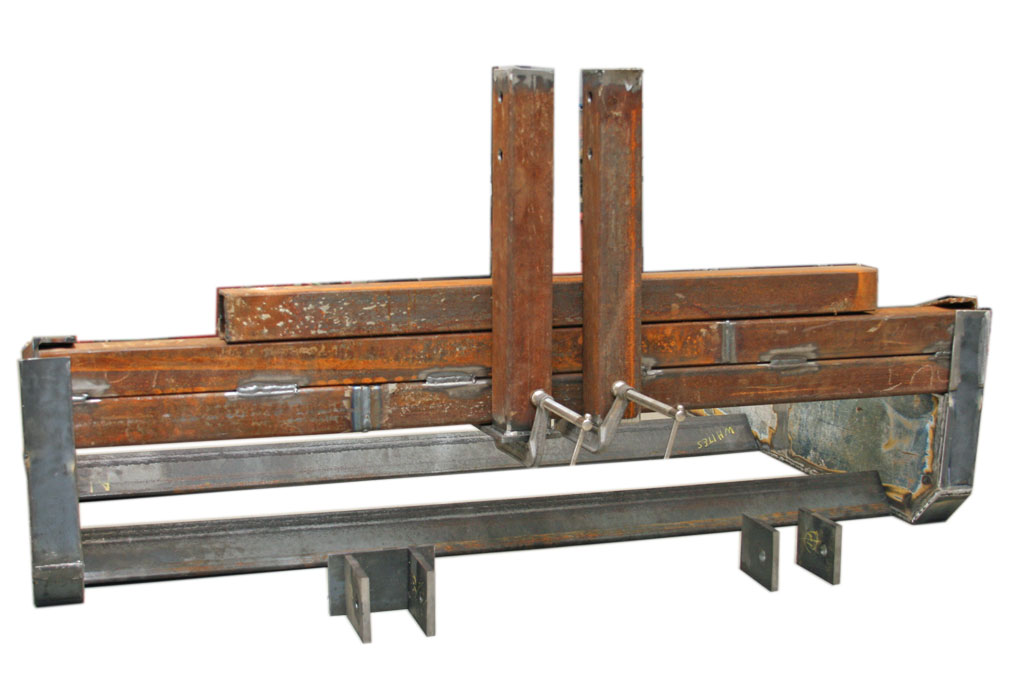

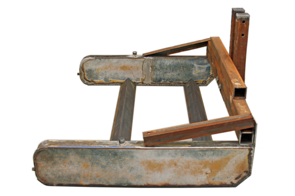

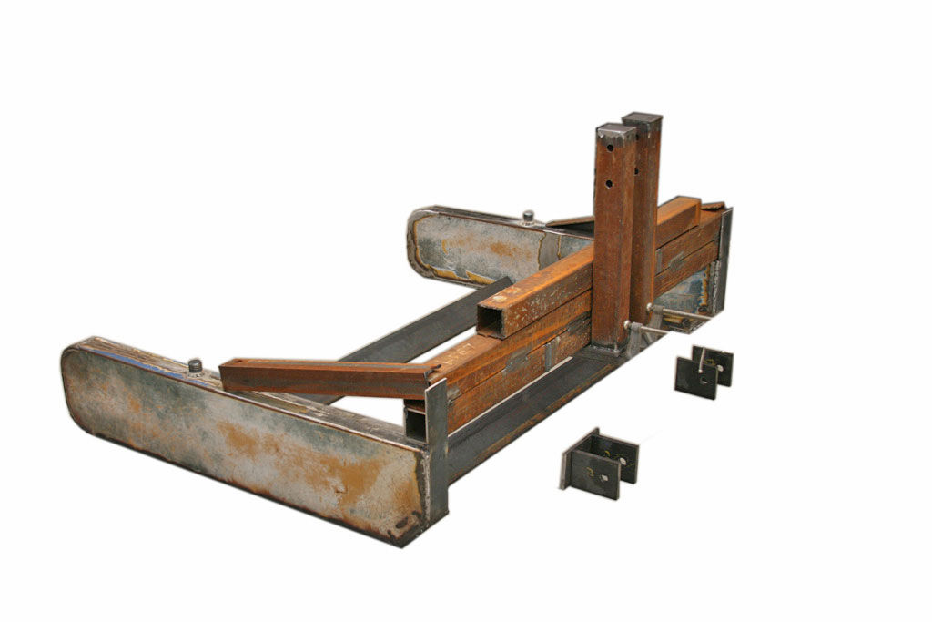

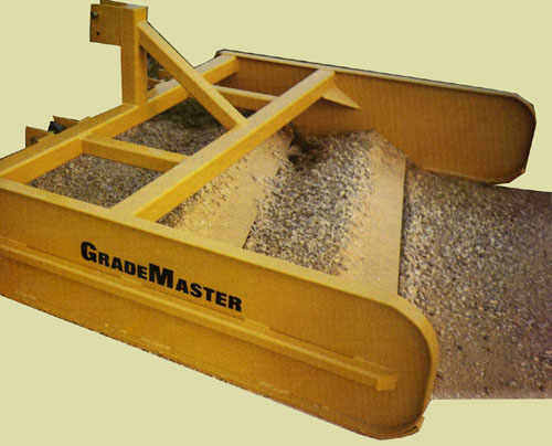

I underway with my drag grader project. The side rails are made from some old seats from a school food service lunch table. They're 10 ga and I welded them together to form a hollow cavity. I added a 1/4"x3" wear rail on the bottom. They are designed to hold water for additional ballast, 100# by actual measure. The cross rail and uprights are 3x3x3/16" square tube. The "cutters" are 4x4x3/8" angle which I will triangulate with a 1/4x6" plate. Total weight will be about 440# dry, 550# wet. The reason for the ballast is that the dirt out here in the desert on the roads is so hard that it's impossible to drive a steel stake into it. Some places I have to use a single ripper on the box blade to cut it.
The assembly is just dry fitted to review my continued options. I still have to add some additional cross braces but that will happen later.
I plan to make the cutters adjustable from 0" to 1"below the rails.
Give me your thoughts on whether I should place the cutters perpendicular to the rails or on a 5 to 10 degree angle. Our local dirt roads do not have a crown as most are lower than the shoulders. During rains (which we only see a couple of times a year), they actually become drainage swales. Fortunately, even during heavy rains, you can drive on them due to the nature of the soil.
I've never actually seen one of these and am working from pictures.
I'm open to any suggestions.

My thoughts would be to have the teeth on a a angle,this way they will dig and lift the dirt instead of pushing it.
   / Drag grader project #3
I recently built one 8' wide with straight blades. Works great, a very beneficial tool to have.
From my experience you need about 100 lbs/ft of width, mine is about 120 lbs/ft at 950 lbs. The 4x4x3/8 angle should work well to mount the grader blades to, just be sure to do a mockup assembly to address clearance of the blade bolts.
I have my blades set about 1/8" below the wear skids now but started out with 1/2" this cut too much all the time so I reduced it.

Looking at the pics, why not make use of the stack of tubing structurally as a frame instead of just stacking it up?

When I made mine I put the blades at a similar angle. But it wasn't enough to move much dirt across.
I like to grade after a rain. The road is so much easier to work with when it is damp. It grades nice and then packs back down nice. If you can get out and grade after one of those couples of rains don't grade when there are puddles. The potholes turn into soup bowls and the muck splashes right back out.

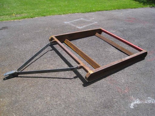

As in all design, triangles are your friends. As this thing rides over high spots, it's whole weight will be setting on the rear, and pushing downward on the lower pivot points where it attaches to the lower 3PH arms. This concentrates the forces at the top post where it attaches to the toplink and try and bend this top post to the rear. When you lift it for transit, just the opposite happens with all the weight on the 3PH arms, the rear of the grader will want to bend downward/bend the tower forward. I think some form of strut from the top of the towers down to the rear of the grader is in order. Below is a pic of how I did mine.
I need to fill the sidewalls on mine, as it is a little light, but still very effective. If you don't always want a crown, I would put the blades straight as once they are at an angle, you are stuck with shifting the material to the side. On an as desired basis, If you want material moved to one side or the other, you can put a large link chain across diagonally from one end of the front blade, the the other end of the rear. This will shift the material to the side as it passes thru the grader. You can also put a loop of chain from the ends of the front blade. A loop of chain will direct the loose material to the center of the box as it passes thru the grader. I intend on adding some weld on hooks just above the blade ends on mine to make rigging this easier.
I put the front cutter about 3/4" below the side rails, and the rear blade is flush with the side rails. This has worked real well for me. I made my cutters the same way out of angle and flat strap, with a weld bead front edge. This worked great with the edge holding up good, and the blade triangles able to roll basketball sized rocks out of the ground without deforming. The toplink allows VERY precise control of how much gets cut. I can go from full cut to no cut in about 3 turns of the toplink...
