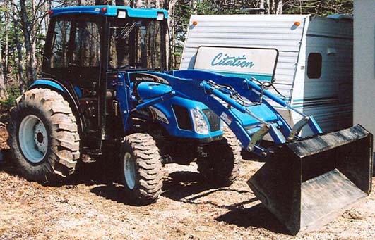

Do you have a cab on your tc 55 da????
I have never seen one do you have a picture of it??
thanks

Yes, I do have an aftermarket cab made by Laurin on my TC55DA. Looks and works good too. Here is a pic.

Oh my, would you look at the size of the bucket on that thang! It' a Vopper. Cab's nice toooo...... /forums/images/graemlins/grin.gif

Wasn't sure, but I figured it wouldn't... would of been too nice!
   / draft control #8
thanks,
nice pic of a nice cab /forums/images/graemlins/laugh.gif /forums/images/graemlins/laugh.gif
