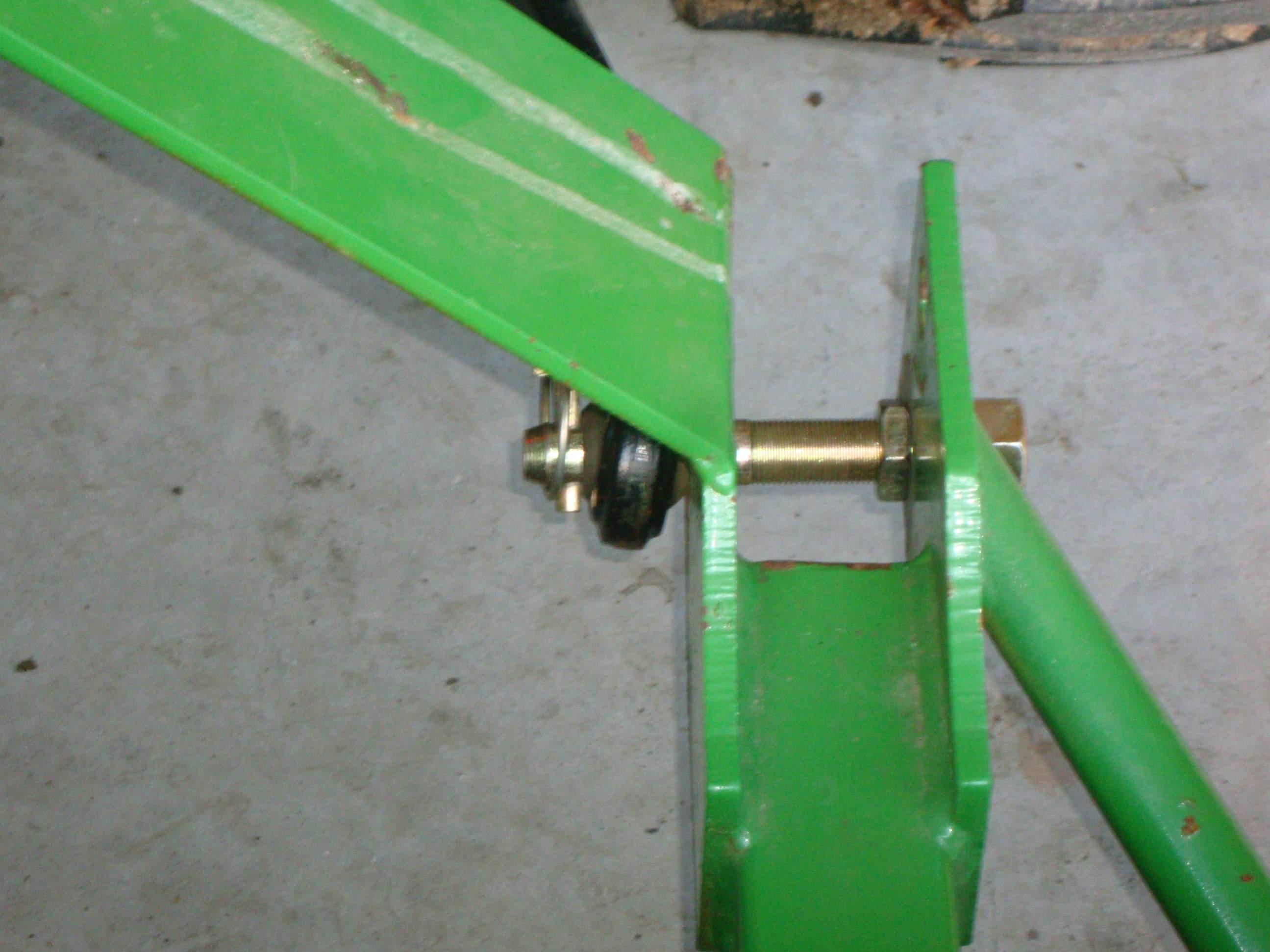

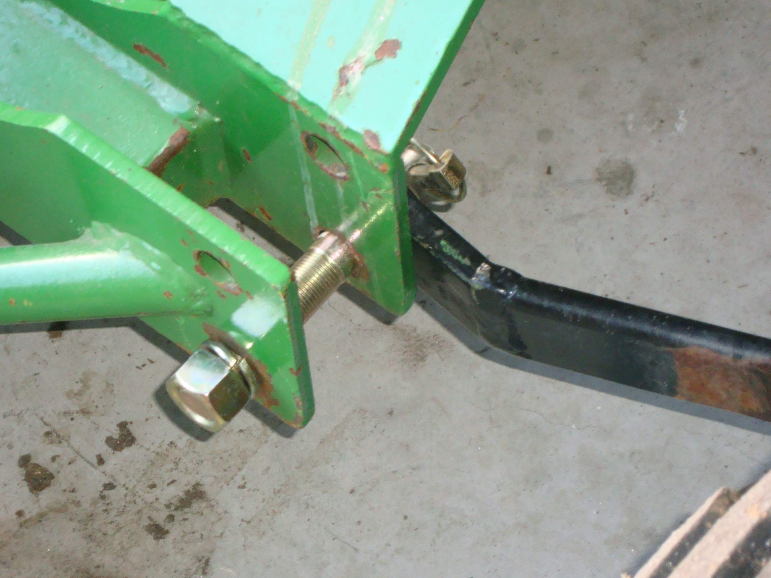

I have the older style of draft arms on my 2520 that rub on the tires and of course being a 2006 John Deere won't do anything for me. Always had a problem with the arms rubbing on the tires when the rear blower was attached. Actually read it on this forum last year where someone suggested using a longer pin and putting the arms on the inside of the blower frame.
I just hooked up the blower for the snow season and it looks like it will work. The snow we got didn't last long so I have not tried it out yet but I don't think there should be any problems. If anyone has an opinion it would be appreciated.
   / Draft Arms Rubbing On 2520 #2
Looks like that mod should work well for you.
Think I'd tighten the nut shown in the second pic, but then it may just be hand tightened now. ;)
   / Draft Arms Rubbing On 2520 #3
Are your tires in the widest position? That will give you some extra clearance. If they are, then the tire values would be on the inside.
   / Draft Arms Rubbing On 2520 #4
I relocated the arms on my I-Match too and that cured my issues. I run a set of V bar chains on my 2520 and they have never touched the arms. :thumbsup:
   / Draft Arms Rubbing On 2520 #5
Snug up the turnbuckles on the 3 pt arms, and flip the rear tires/wheels around so the valve stems are on the inside and the arms should not rub.
