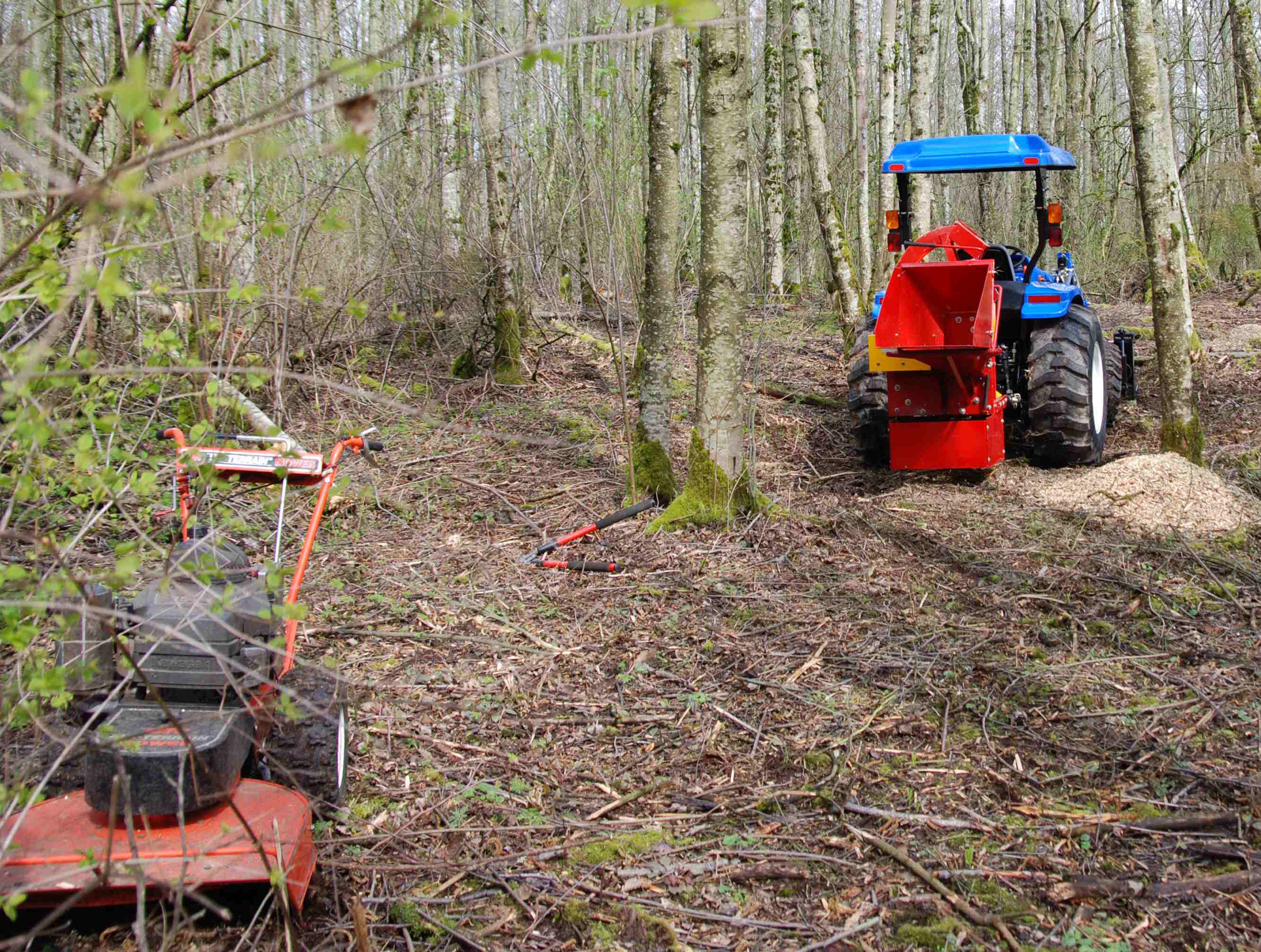

I have owned the 14 horse for 6 years. It works great and Country Home Products really stand behind their products. Great company to do business with. Here is a picture of my DR and tractor. It is a great companion for the tractor :)
