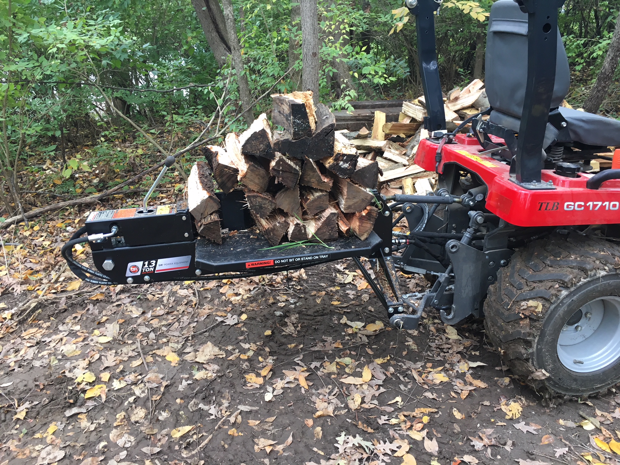

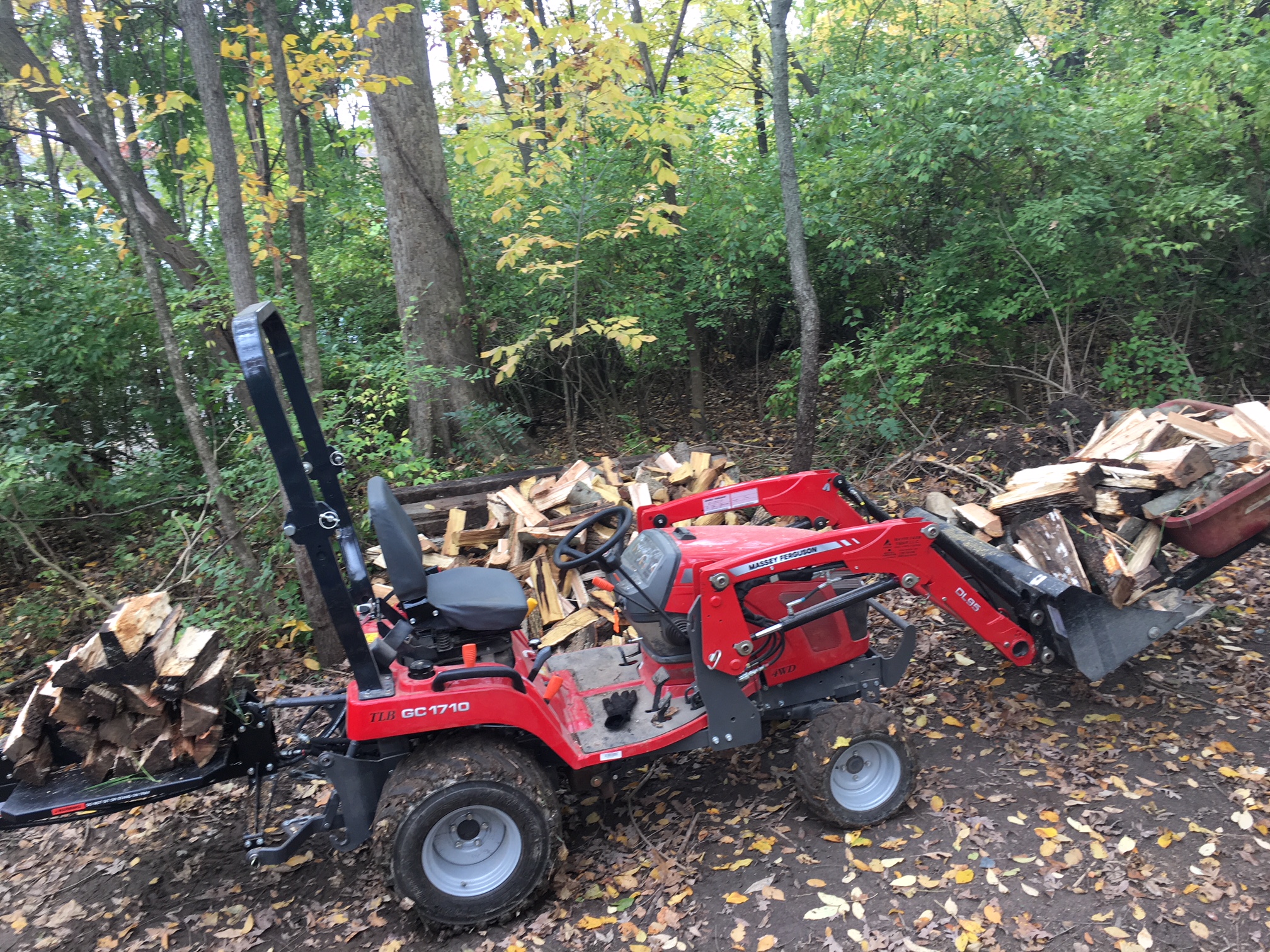

**Update pics and videos***
Here is a timelapse, and an actual video of it in use today. I couldn't be happier with the performance. Cut and split a lot of timber today!

View attachment 526568View attachment 526569View attachment 526570View attachment 526571
