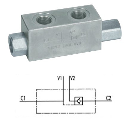

Does anyone happen to know the US equivalent of this UK supplier of DPOCV's? I'm wearing Google out trying to find these in the same small form factor. Lots of the giant versions available in the US, but haven't located the small ones yet.
Flowfit DOUBLE PILOT OPERATED CHECK VALVES
I've found dozens of suppliers in Turkey, India, Serbia, China, etc. Surely there has to be a stocking distributor somewhere in the USA.

Sun Hydraulics in Sarasota Florida, HydraForce in Lincolnshire Il, Delta Power Co., Rockford IL. Parker Hannifin, Eaton. All of these companies make DPOCV's in various sizes and flow rates.
You will have to find a distributor for them in your area though.

I appreciate you gentlemen trying to help, but as best I can tell none of those outfits, and none of the places I've looked at for the past week) have the small form factor valve I'm looking for. The valve I want has a body that's only about 2-1/2" long, 1-1/2" tall, and 1-1/4" thick. It's plumbed to a cylinder as in the photo, and is most commonly used for hydraulic top and side link applications. All those mentioned companies do make functionally similar valves, but their physical configurations don't allow this type of compact installation.
As I said before, these are common overseas, and I can get one from an outfit in the UK via Ebay (see item #310249502175) for $72 shipped (the shipping costs more than the valve, LOL!). I was just thinking I might find a stocking distributor in the good 'ol USA, but no luck. It goes against my grain to have stuff shipped from overseas, but this time it's looking like that's the way to go.

You could perhaps contact the distributor of the cyl with the DPOCV and ask questions. like would you sell me just the DPOC, or where can I order one?
At the bottom of the page for CCM, they will sell any part of the TNT system.
http://www.ccmachinery.com/TNT.htm

You won't find them...Use MadReferee (May he RIP) went through this years ago and could not find a US supplier.
Now, OTOH, user 3RRL (Rob) did buy some from CCM to put on his backhoe stabilizers. Read this starting at post #13: Backhoe Feet - TractorByNet.com
You can search either of their usernames and the term "DPOCV" for lots of reading.
