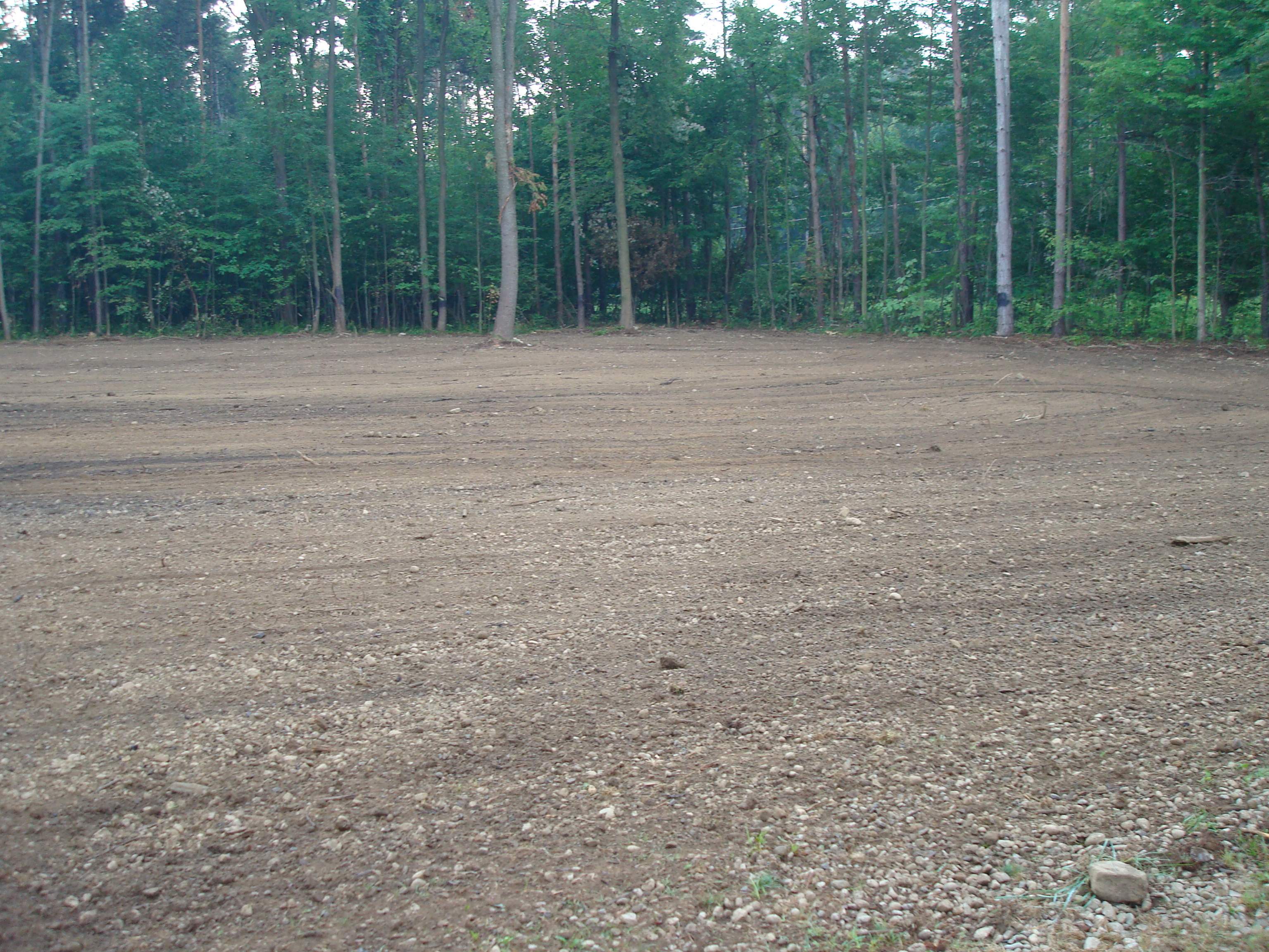

excavator hands down. 30,000 pounds and up. I just cleared 2+ acres of dense trees. two work days and it was done. they shook the dirt off the stumps and burnt them. no hauling and no burying of stumps. here's a photo. we had a dozer back drag and do some light grading. this photo is one week after the clearing.
