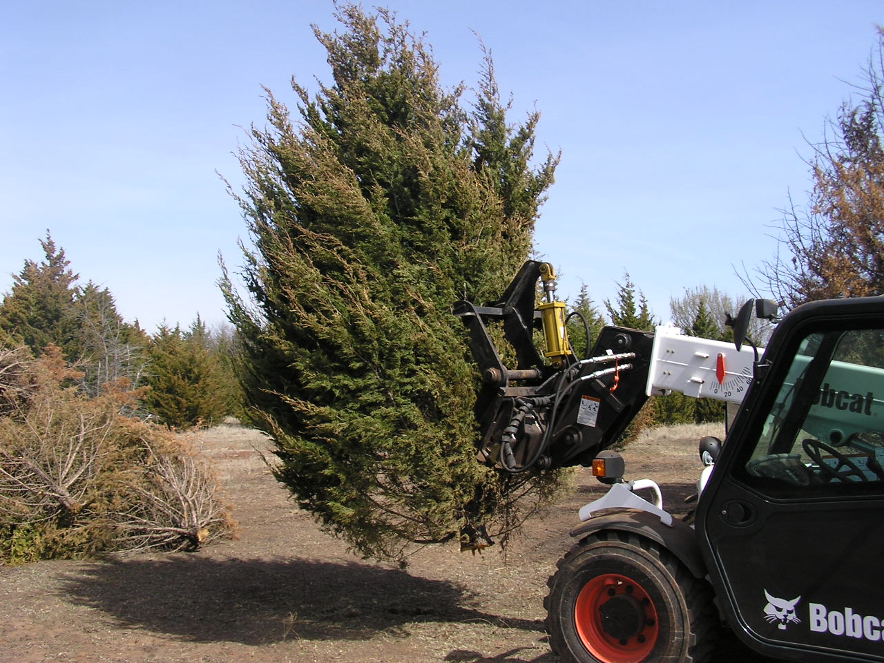

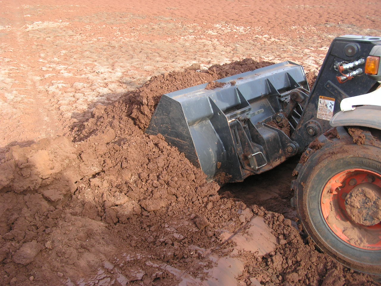

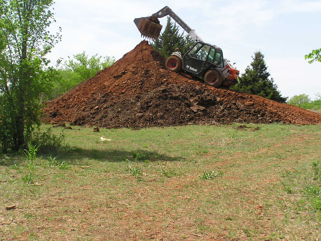

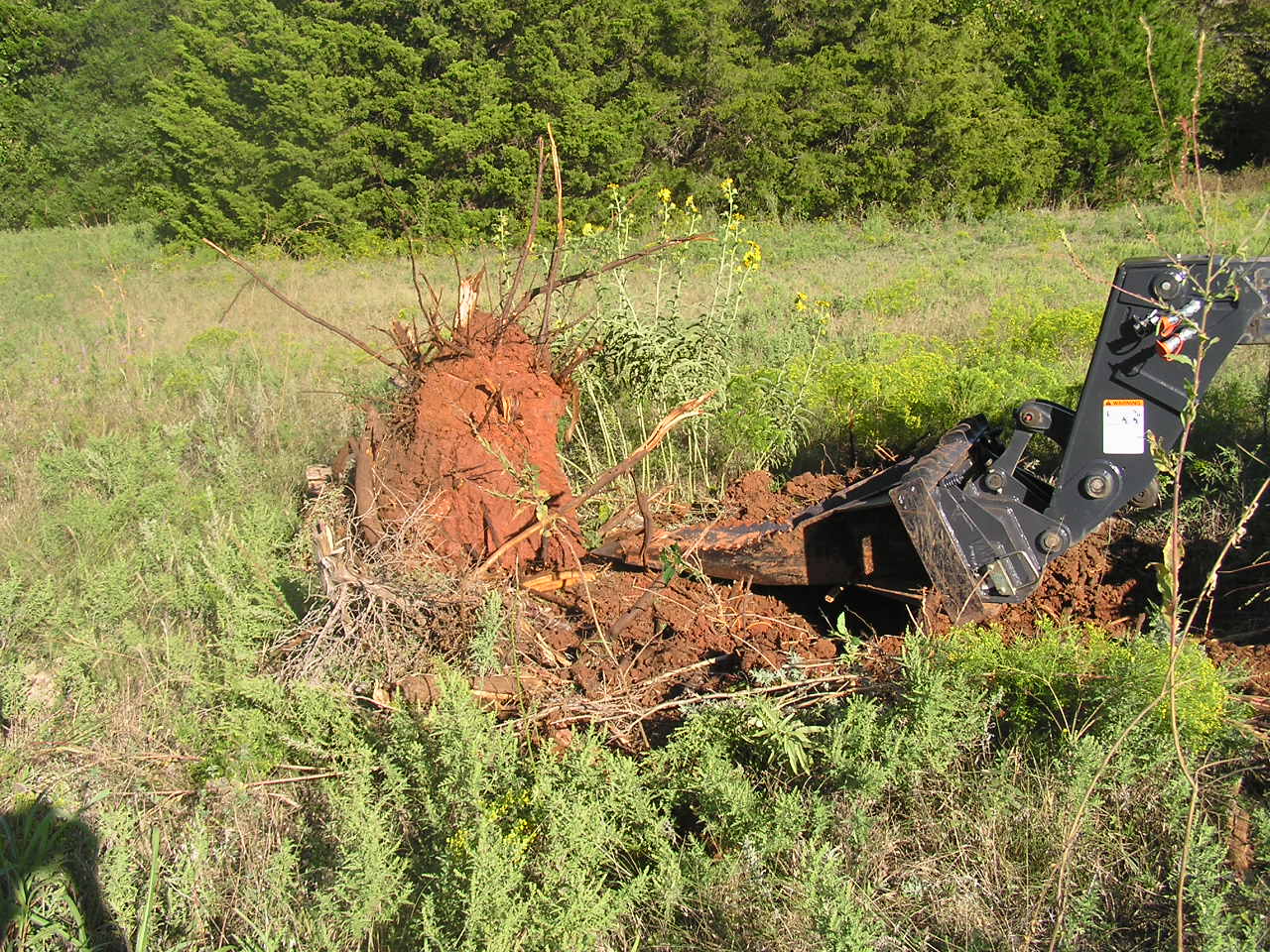

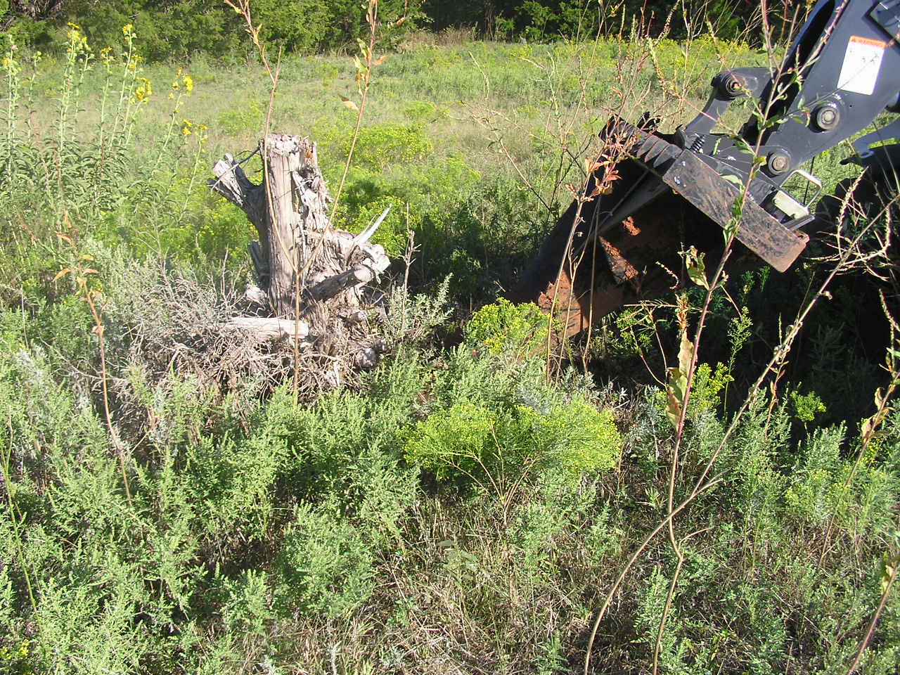

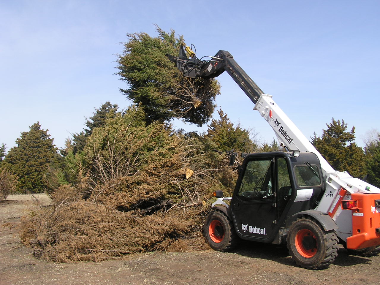

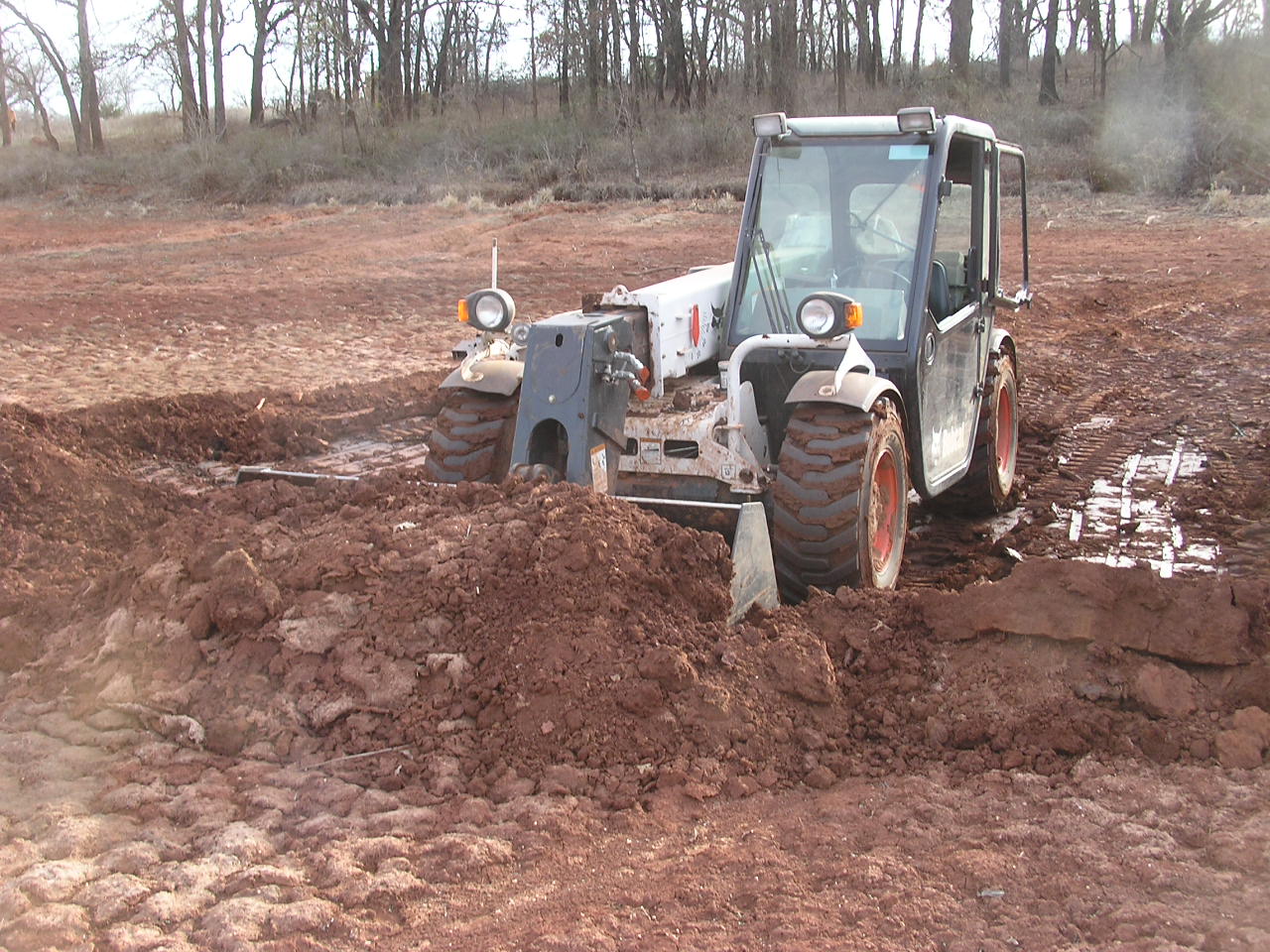

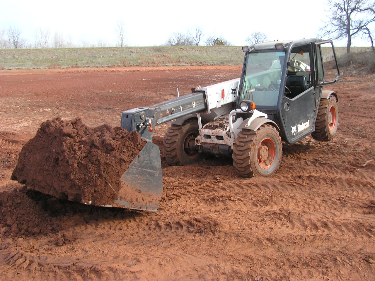

Try a compact telehandler and your gut won't say dozer :D
It will move dirt!

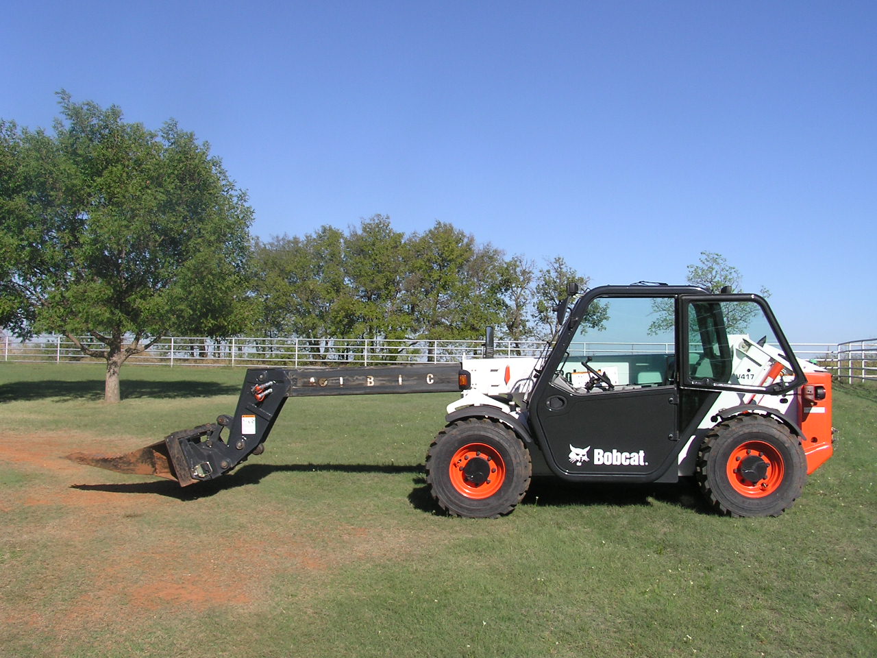

The stump bucket removing a stump.

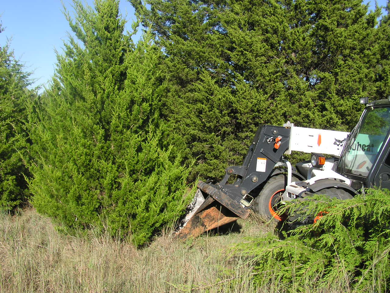

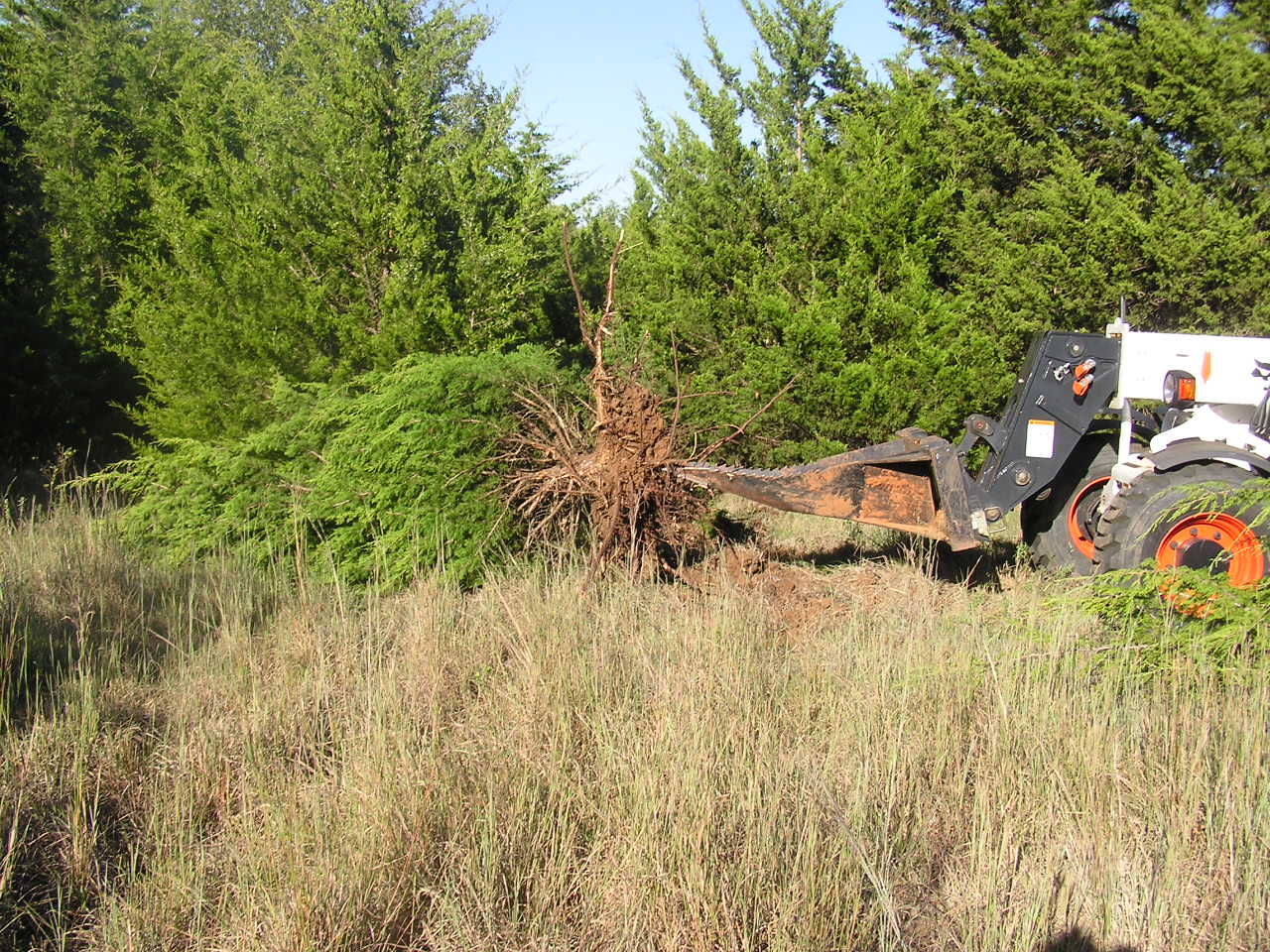

The stump bucket removing a cedar tree.

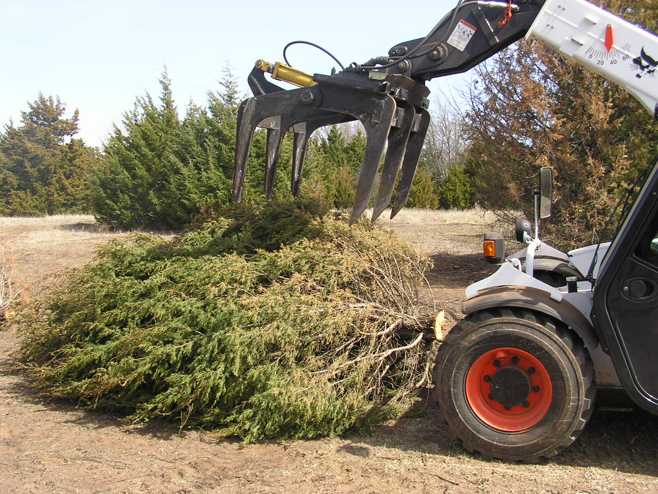

Stacking cedars on a burn pile with the Gorilla Grapple.

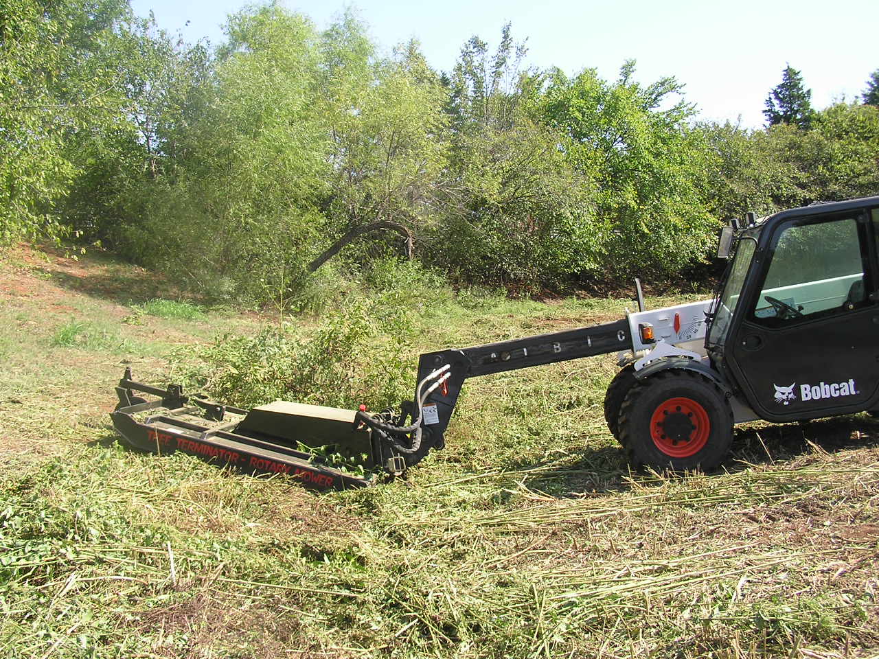

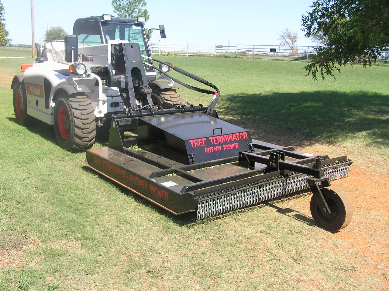

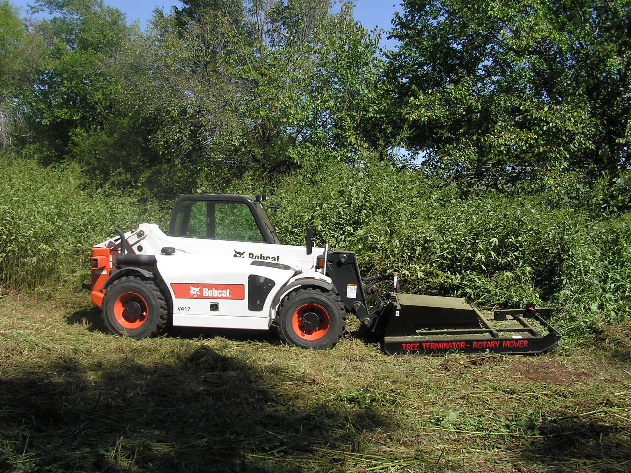

The 7' brush hog.
