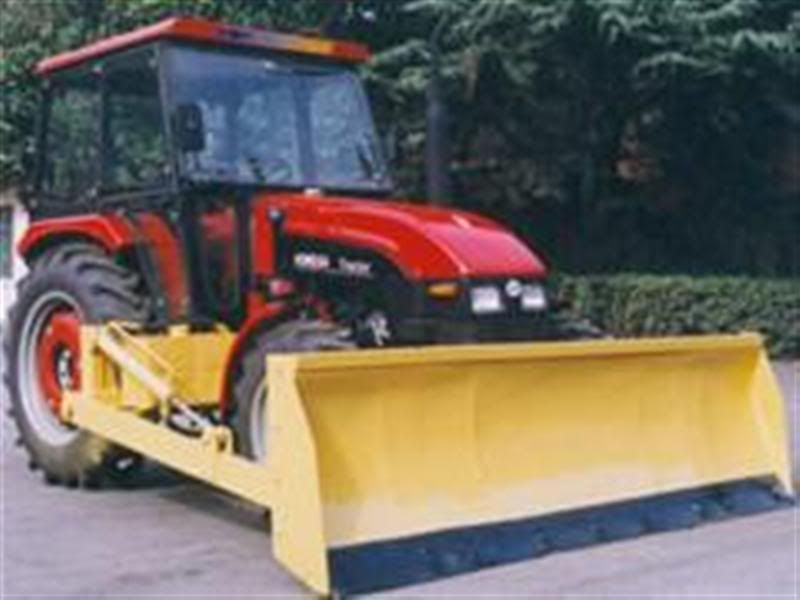

I dont know that much about FEL, but I just bought a tractor that has one. This is the first FEL I have ever had, although I have had several tractors in the past. I am looking for something like a Dozer blade that replaces the FEL bucket. I have about 12 acres that I am turning into pasture land and I had a logging company come in and cut the trees. I am looking for an attachment that replaces the bucket that I can just push all the stuff into a pile and burn it. I have been doing it with the FEL bucket and I was wondering if a dozer type blade on the FEL would do better. ANy advice would be greatly appreciated.

Saw this on a Kama website.
Looks pretty beefy and notice where it's connected. It's not like an fel connection.
