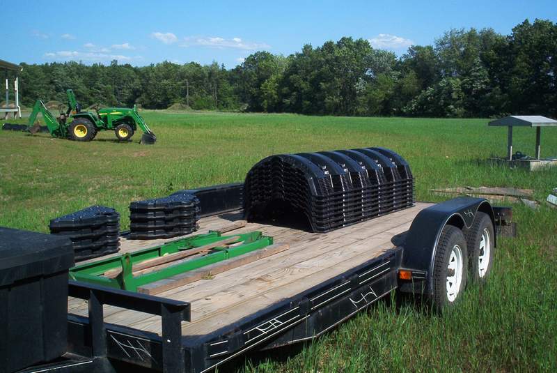

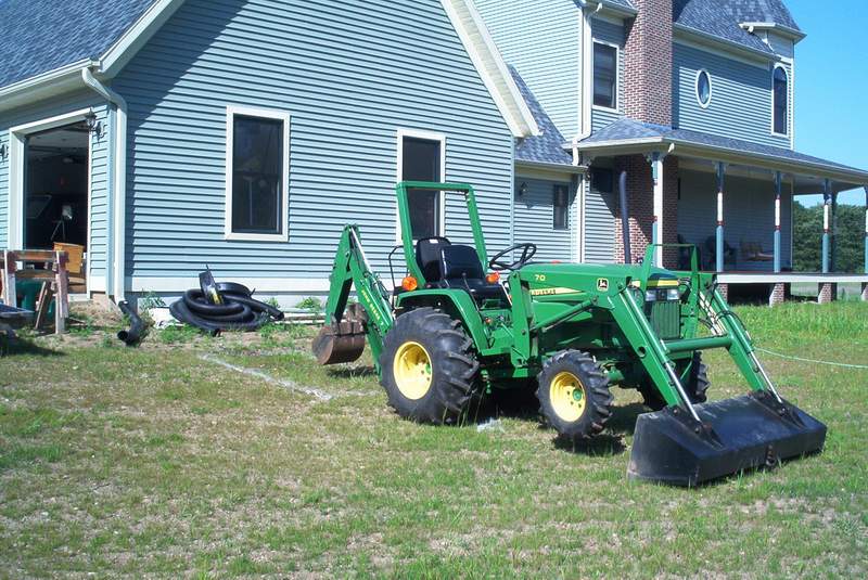

Here are some pictures of my weekend project. I put in five drywells to handle our gutter/downspout runoff. I had already buried the drains but left the ends above ground.
This first shot shows my supplies for the project. I used Infiltrator chambers designed for septic. I know, it's overkill but they were reasonably priced and easy to install. Also, they provide a lot more capacity than a rock filled trench as the area under the chamber is wide open /forums/images/graemlins/smile.gif

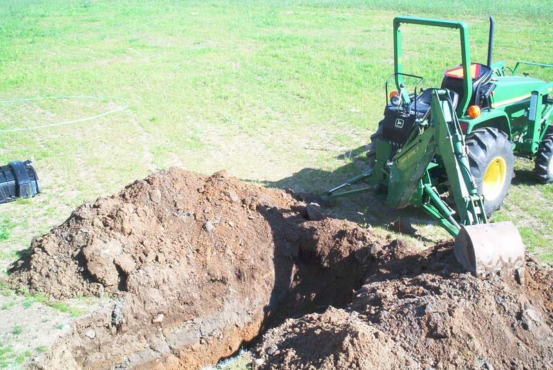

Here I am poised and ready to start the digging, well at least my tractor is /forums/images/graemlins/smile.gif

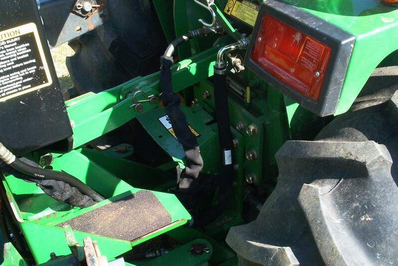

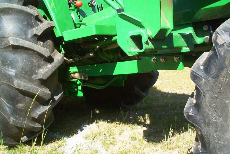

Not really related to the project, this is a close up of the subframe for a #7 hoe on a 790 Deere. The permanent subframe runs horizontally from the rear axle casting to the loader mounts. The hoe frame quick-hitches into the tractor subframe just about even with the forward edge of the back tire. The gold colored handle with the spring is the quick-hitch lever /forums/images/graemlins/smile.gif

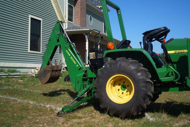

Here's another shot of the hoe/tractor mounting. A busy picture of the rear area but it really doesn't show much. Power Beyond connections and the top link bracket are most obvious. What doesn't show is the lower mount which seems to take the brunt of the hoe load. It's a beefy piece of iron securely bolted to the PTO case. It's back to the project after this /forums/images/graemlins/smile.gif

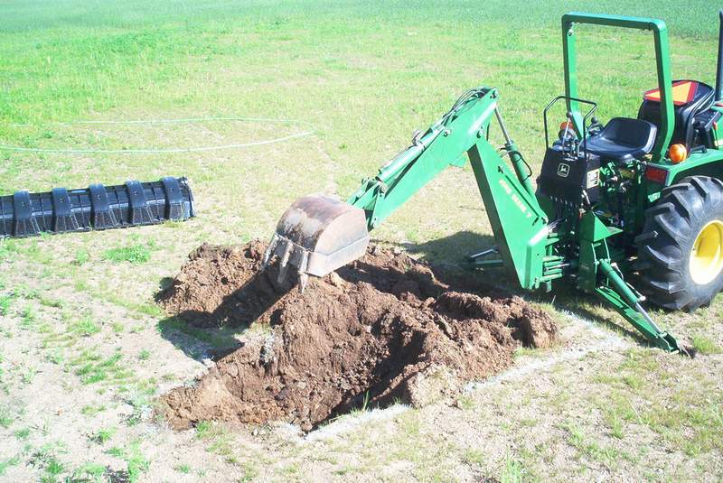

Well I thought we were ready to dig but you can never have too many prep pictures. Besides, Norm always says "Measure twice, cut once and take a whole bunch of pictures because you'll forget to once you get started" /forums/images/graemlins/smile.gif

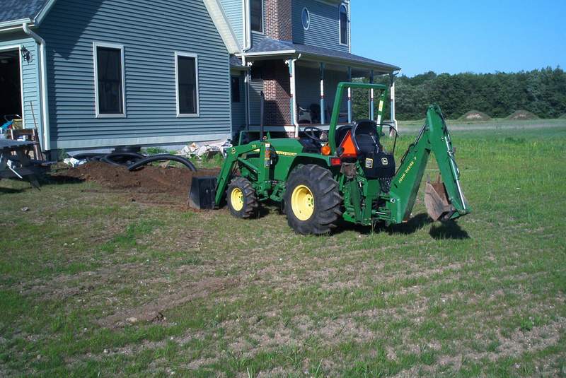

Hey, we're finally moving some dirt! This is pretty fun. Our soil is pretty sandy so it's easy digging except that it's a tad dry lately. Just a couple of inches of hard crust to break through then we're home free /forums/images/graemlins/smile.gif

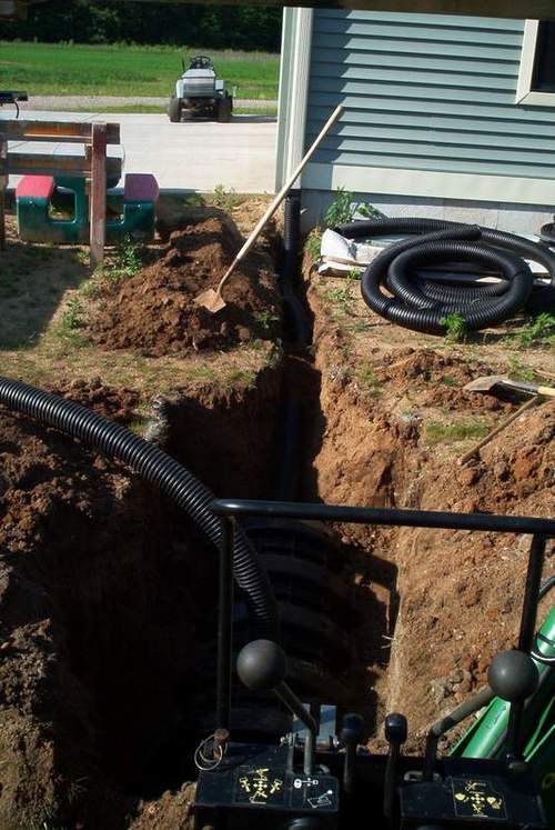

Just about done digging this trench. If the picture uploads as well as it shows on my PC you can see the layers of our soil clearly. Topsoil is sand/clay/loam then the dreaded layer of hardpan (grey in the photo). Our site was a field for decades and this layer forms at the bottom of the tilled layer. It's all the fines from years of plowing forming an impermeable layer of hard clay. Fortunately, below that is nice sandy subsoil so my drywells should drain just fine /forums/images/graemlins/smile.gif

And finally, the backfill. I've since taken the hoe off, put my landscape rake on and smoothed it out more (knowing it will settle some). The pipe sticking out of the ground is the overflow which gets cut off at grade and capped with a drain grate. Five drywells, nine total Infiltrator chambers and about 12 hours total time. I'm pretty sure I was smiling the whole time too /forums/images/graemlins/smile.gif
