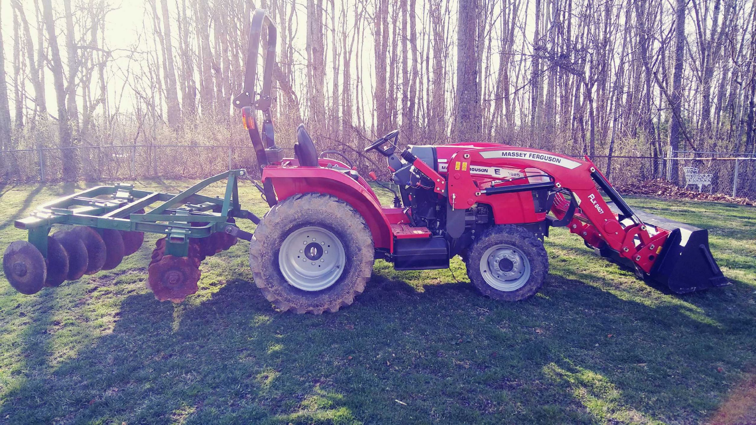

I really think that you will be disappointed in a light 4ft disc. I watched my dad and uncles pile on cinder blocks, metal or anything else they could find to weight the disc down so it would cut. When it came time for me to buy a disc, I bought the heaviest one I could find in the size my tractor would handle. I bought an older large frame International Harvester 120 Disc Harrow. It weighs around 800-900lbs and has a 7ft cut. It does a great job and my tractor handles it very well. I have a Massey Ferguson 1825E which is similar to your Kubota L2501.
