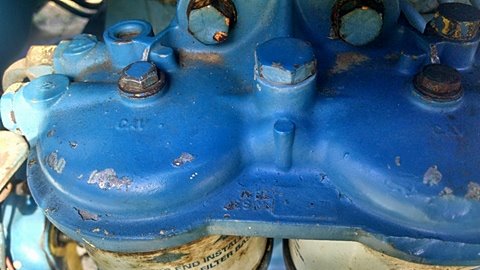

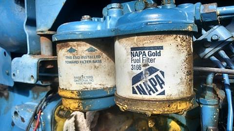

I need to replace the fuel filters on my 1989 ford 4610 diesel tractor. I can see the part number on the filter on the right but the part number has worn off the filter on the left. I was told that they are different filters with different parts numbers and that the filter on the left is to filter out water and larger particles and the one on the right is to filter smaller particles.. I have been searching online for hours trying to find out what filter I should get for the one on the left and have not been able to find it. Is there anyone here that can help me with that?
I have an owners manual but it doesn't have the parts listed. It really doesn't cover much except how to operate the tractor.

Here is the WIX info you need. Both filter cartridges are the same. This style of fuel filter is common to most tractors of that era.
The filter is not a spin on style like a car oil filter, rather is is a cartridge that seals to the upper and lower parts of the filter assembly with rubber seals with the assembly squeezed together by a long center bolt..
On some of the lower cap for the filter cartridges there was a drain so you could drain and water out that settled in the filter. Usually it was the left filter as it was first in line.
Sometimes the lower cap was glass so you could see any water but these were often broken and replaced with metal so you cannot see any water accumulation
The WIX web site is: WIX Filters - Products Catalog Home
which has a where to find section to show you where their dealers are. Most dealers of other brands of filters can cross reference the WIX# to say FRAM
Note that the Napa # of 3166 is the same as the WIX # but WIX adds a 3 at the front so it is 33166.

Thank you! This is exactly the information I have been looking for. I checked with Oreilly's Auto parts store in my home town and they carry these filter's. I will be picking them up tomorrow!
