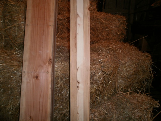

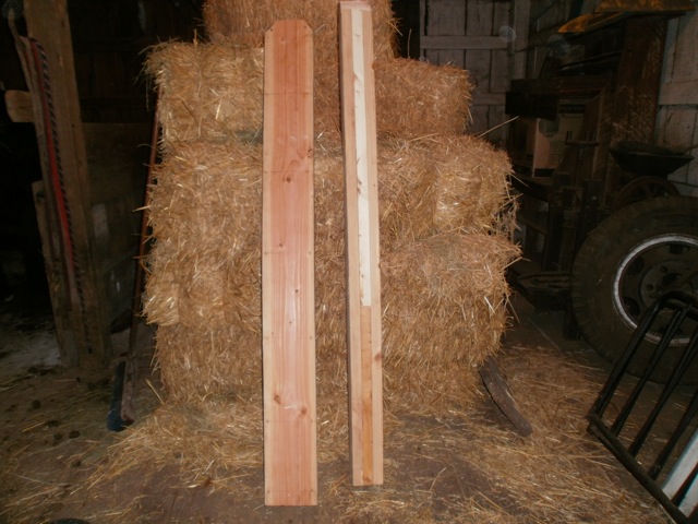

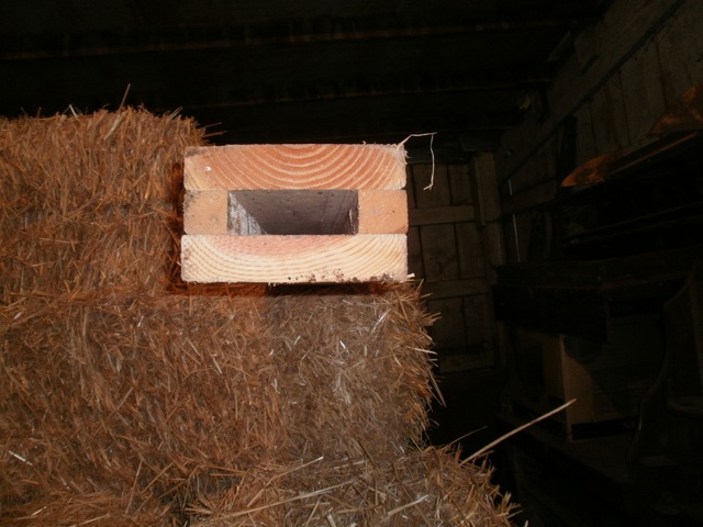

currently l4400 stick
two by eights six feet long.
two by four six feet long, ripped.
douglas fir
star head exterior wood screws
works fine for me,
I have tried repeatedly to post photos and to no avail. Done it lots of tiems before, but for some reason, they don't come through.
Anyway they slip on the forks like square wooded tubes. They won't fit in pallets, but you can lift and get under lots of stuff.

Thanks for your advice on the new posting info. got it!
