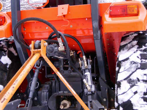

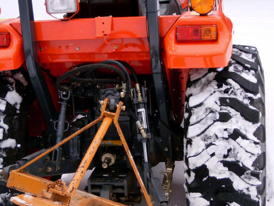

It was a L4300 . Like I said , Nice but not that nice . I also might need to talk with you about where you got your top and tilt rams when you set up your rig . I was thinking of looking in Northern Tool to see what might work as rams . I am looking at box scrapers now . I picked up a used 70" snowblower today and a bush hog post digger .So a grapple and 72" box blade are the last two items I need to be set up .

For my top link I used a 2 1/2" x 8" throw tie rod cylinder from Tracor Supply Co. The cylinder was around $65 but required cutting the ends and welding on ends from a bent top link I had.
Cylinder, hoses , fittngs and quick couplers total around $120.
The tilt cylinder was a 2" x 4" surplus tie rod cylinder from Prince Direct. Part # SAE-8404-0.
$35 for cylinder, Where the top of the cylinder attached I needed a differant pin and made bushings. Where the bottom attached I removed the end that came with the cylinder and found nuts that would thread on then welded and drilled new brackets to the nuts.
The tilt cylinder, fittings, hoses, quick couplers total around $100.
Both cylinders were painted , Rust O leum charcoal gray is a close match to the Kioti gray.

I attached a photo of the top and tilt cylinders

One more
