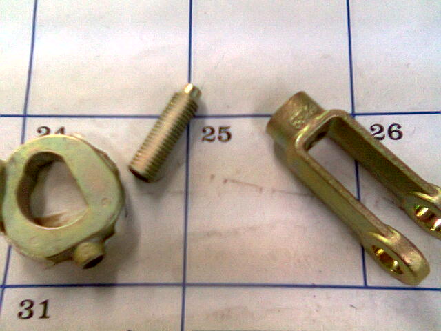

Against my better judgement i did mow with anti scalp wheels down on unlevel yard, and this is what happen:mad:
this occured on my 2320 that i installed independent lift on. I didnt notice this untill i went to raise the deck, one side went up and ofcourse the other did not!! What a dummy!!
Make me feel better.... anyone else don it???

I don't get it, did you have the wheels in constant contact with the ground? Isn't that a suspended deck (like the 2305's 54" deck)?
Sounds like a big "oopsy", to me... :)
   / Dont mow w/ wheels down!!! (54d)
Yes they were in contact 90% of the time. i think this happened when i turned and the right side wheels dug into the ground. it is a suspended deck but i did not have it suspended!!!! i had the deck set at a low setting and the wheels were on the ground. I did order 2 more hook bolts this morning from dealer (one spare) i would suggest that every one keep a extra one in stock, even though i will not make this mistake again!!! part#m112361 probually same for all 20 series
