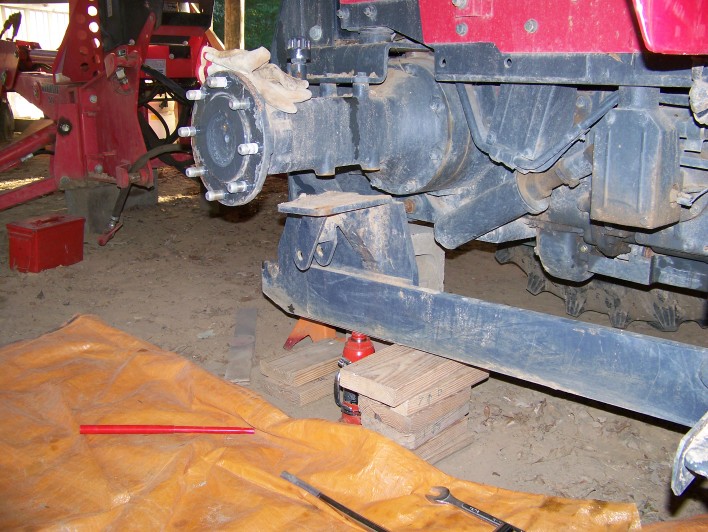

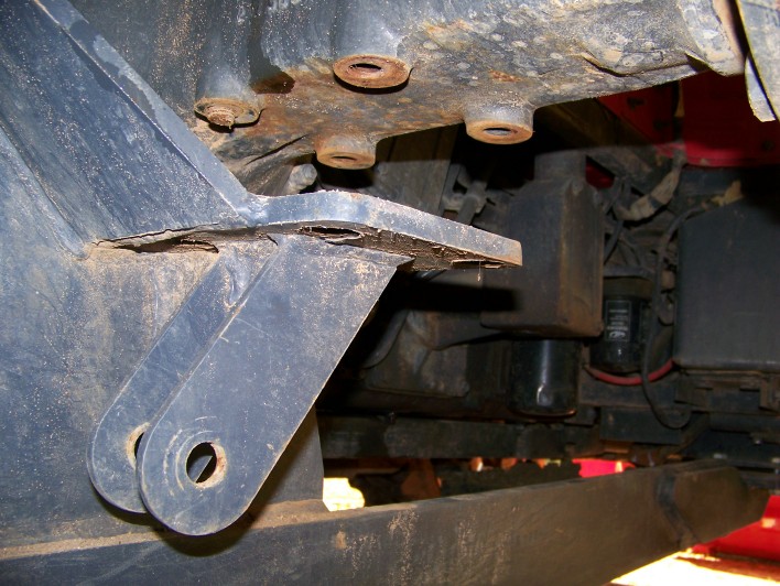

While changing transmission fluid today, for the first time. I notice a bolt missing on the right tractor subframe for my backhoe.:( I had the backhoe already off to mount the 3PH arms and the brushog. When I got a mirror to look up in the hole, I saw that the bolt was sheared.:eek: It looked like it had enough meat left to remove it with vise grips;) after getting the subframe loose and moved over. I loosened and removed all bolts, but the two forward bolts. I lowered the subframe (one inch thick and HEAVY) with a bottle jack in back while the two loose forward bolts kept it from falling off the jack. I had to heat the bolt (all threads were saturated in locktite paste on installation 2 & 1/2 years ago) to break the locktite bond. :eek: After a little heat, I tightened a pipe wrench on it and slowly removed it.:D This all after I had the tire off and the tractor blocked up in 3 places. I put it all back together while measuring the spacing for the left and right subframe halves to get them spaced right. Each time in the past, I had to pry one subframe half to get it to pop in the clevis when mounting the backhoe. Now it should drop right in place.:rolleyes:

What grade designation are on the heads of the attachment bolts?
Doesn't look like a fun job but you were fortunate a portion of the broken bolt was still accessible.

I kept reading my parts manual and backhoe installation instructions, to see if they called out the bolt. It might be metric:confused:, as the front loader and brush guard bolts are, as I needed to buy a tap to clean them up, after modifying my brush guard. I finally found a statement in the instructions that the bolts were existing bolts.:( I didn't look at the head after that. I took one out after tightening all bolts and left it in the truck for my next trip to town. I will buy a case hardened bolt then. The bolt that sheared has to be started and tightened first as it goes beside the 65 or 70 degree mt. flange for the telescopic link. The left side's bolt is half way out and jammed into the mt. flange.:eek: I will have to buy a 15/16th crows foot to tighten it up as my crows feet at the hangar only go up to 7/8.:rolleyes: The right one I reinstalled last night has enough room to get a 1/2 inch drive socket on it, but not a 3/4 drive, because of the side to side slot for adjustment. So I took a chance with my 1/2 inch breaker bar and the 4 foot cheater pipe on breaking it, but it only flexed real good.:D Yes, I was blessed in having meat to grip. Otherwise I would have had to drill and hope not to break an extractor in removing it.

On the bolt head...........LPS. Also it says 10 9 with the numbers underlined and the 9 seems to be a little smaller. Sounds to me that it is metric. Won't know until tomorrow night when I get to the hangar, where all my taps and dies are.

Yes the 10.9 is a medium carbon steel bolt that has been quenched and tempered and is approximately equal to a SAE grade 8 bolt.
It has minimum yield strength of 940 MPa ( mega pascals) or approximately 136,000 psi.
It also has a minimum tensile strength of 1040 MPa or about 150,000 PSI.
These specs are almost identical to a SAE grade 8.
A stronger alternative would be a 12.9 metric bolt with 160,000 psi min yield and 177,000 psi min tensile strength.
The problem is that you lose ductility as the strength and hardness increase. If heavily overloaded it is more likely to shear rather than stretch or bend. It also may also transfer more load to the threads increasing the chance of stripping the threads or cracking the casting.
The fact that the original 10.9 bolt sheared indicates a harder bolt may not be the solution.
Bolt strength selection is a balancing act... but I'm sure the Mahindra engineers made the selection based on good engineering practice and sound judgment.
I would stick to a 10.9 bolt from a known quality supplier.

I installed 8 new bolts today with Locktite 242 Threadlocker.............the blue stuff. I had to lower both subframes with the rear tires off. I am so glad that is over. I had to take a 15/16th wrench to my welding shop to have it heated and bent to fit the hard to reach bolt. I also put Theadlocker on the front bolt threads. I throughly coated all the bolt threads.
