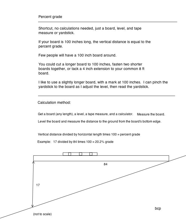

Don't guess what percent grade you have, measure it.
   / Don't guess what percent grade you have, measure it. #1

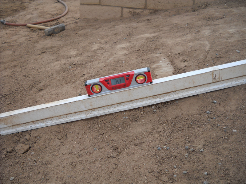

Or...
15.3 degrees. Also reads in % or in/ft
