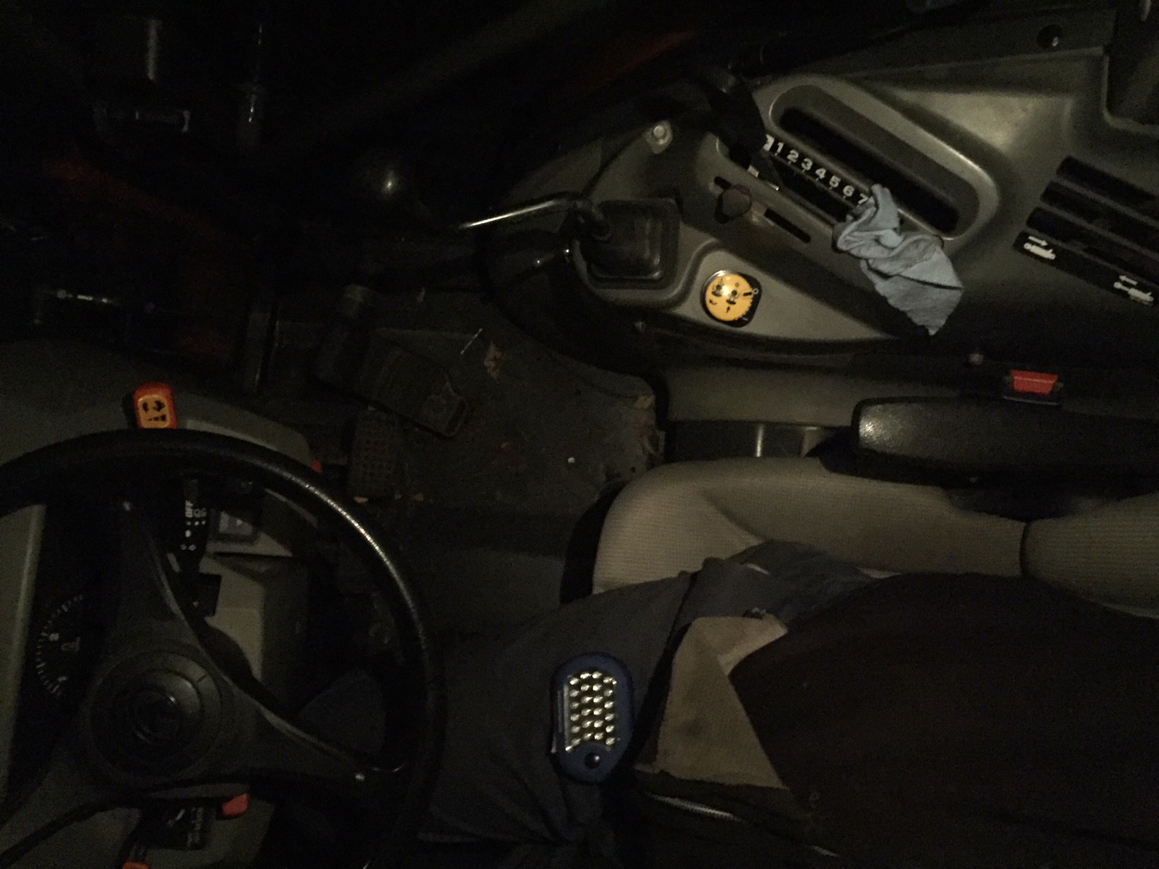

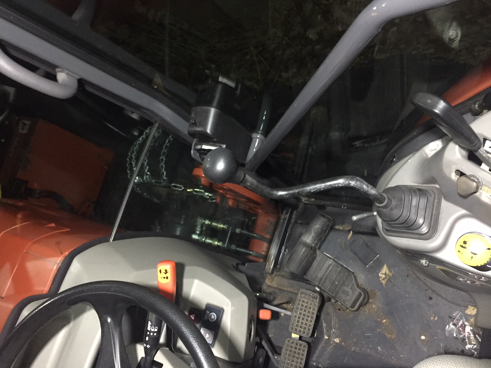

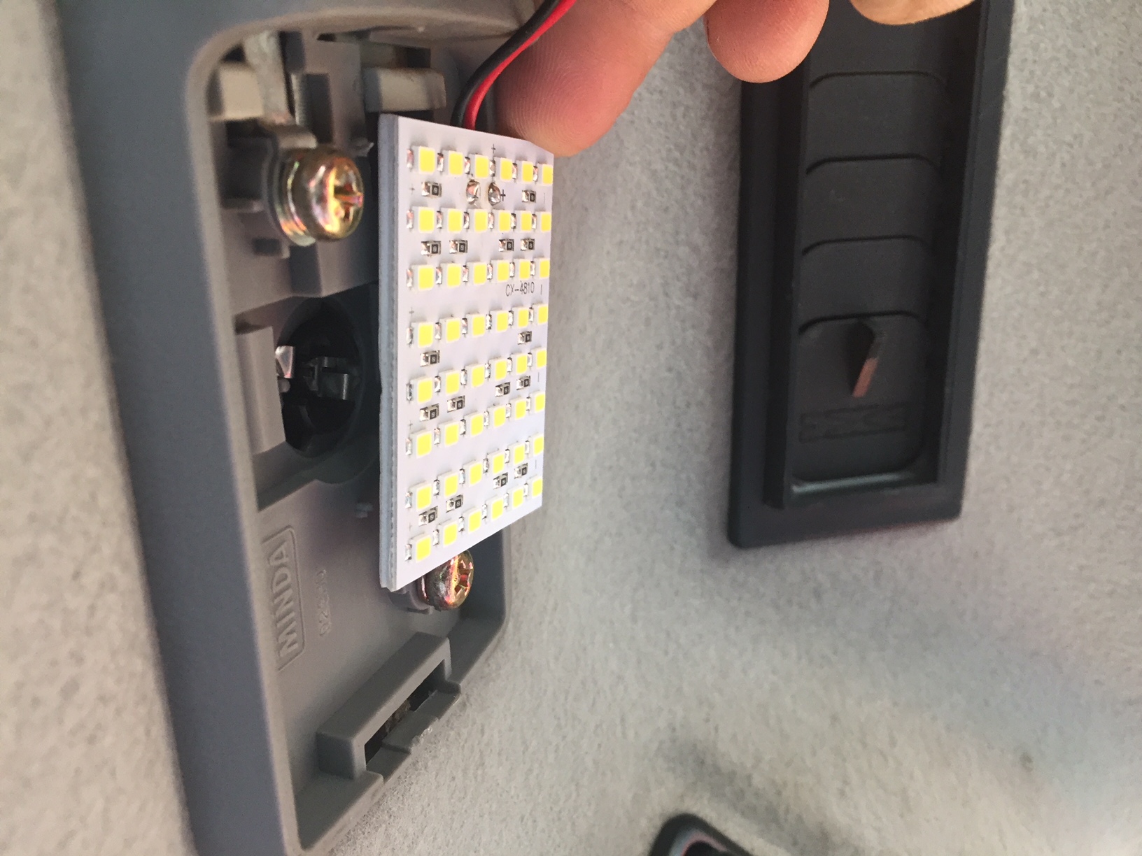

For what it is worth the Grand L30's and L40's came with the door switch, but it seems it was omitted on the newer model.
I converted the incandescent lamp to LED and it made a very dramatic difference in light output.
Nice!! I should do that.
