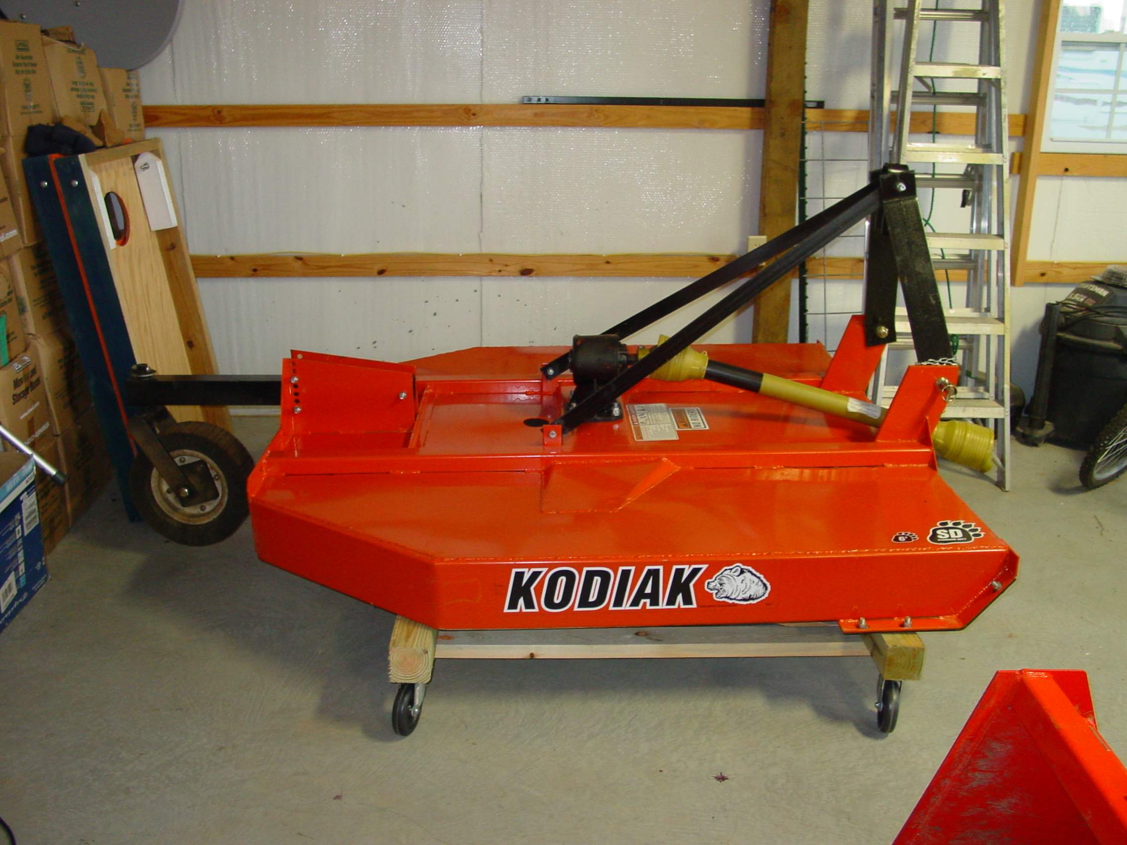

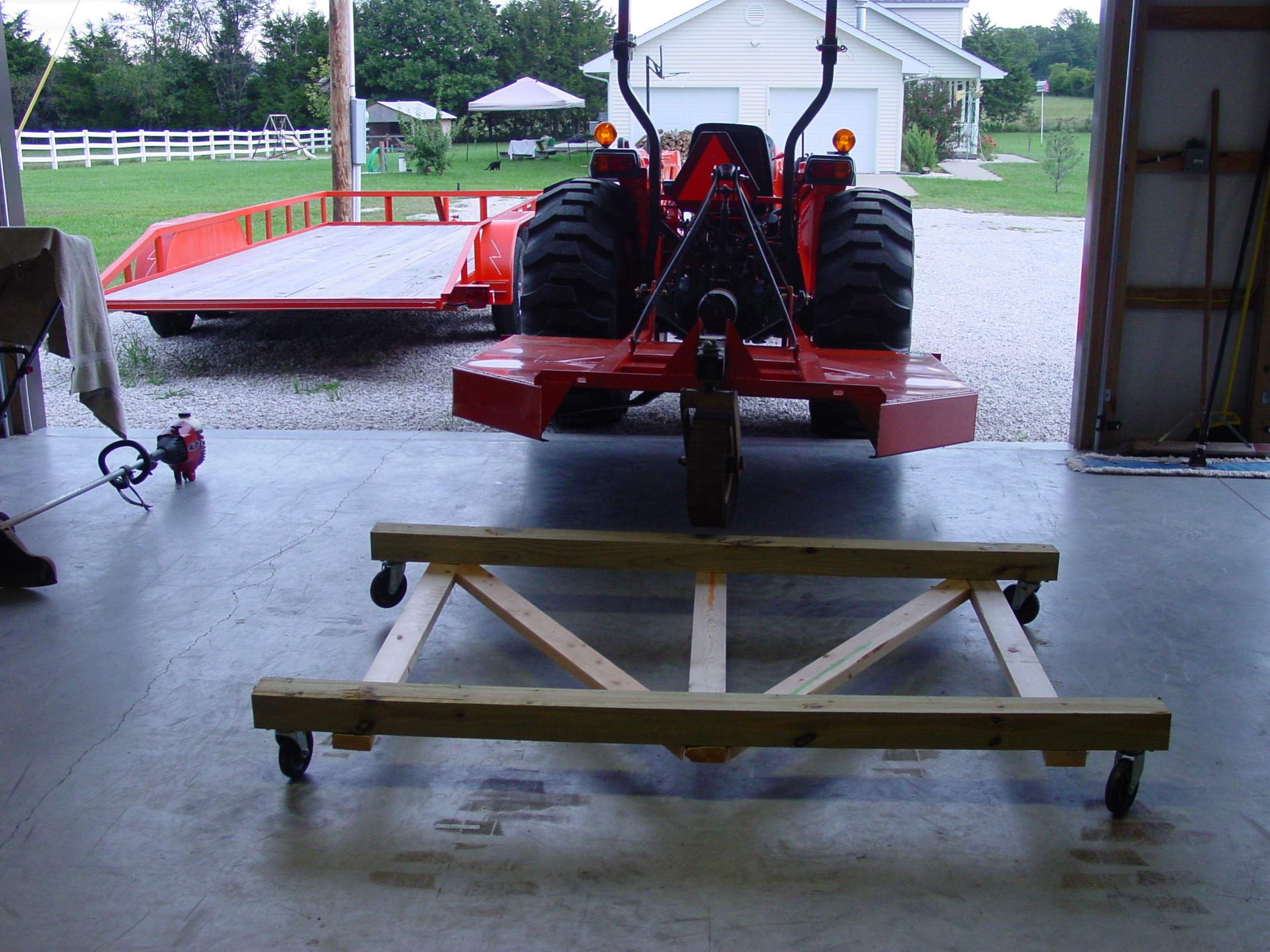

I decided to build a dolly for my rotary cutter in order to make it easier to hook up to my Kubota. I made it using 4X4's, 2X4's, and 4 fully rotating casters. What a difference in hookup! It took me less than 10 minutes to get the cutter hooked up including the driveshaft. With the fully rotating casters, I could easily move it to make minor adjustments in hookup. Removing the cutter was easy too, just slide the dolly underneath and unhook; then stow the cutter out of the way. Pics below give an idea of what it looks like, and can be built to suit various sizes of attachments. Mike

Very nice.
I see you have the bean bag toss game. :thumbsup:

Yeah, it's a bean bag toss game. My son made it last summer when he came out for a visit. Notice the colors, he's a Broncos fan! We must have played that game every evening for the week he was here.

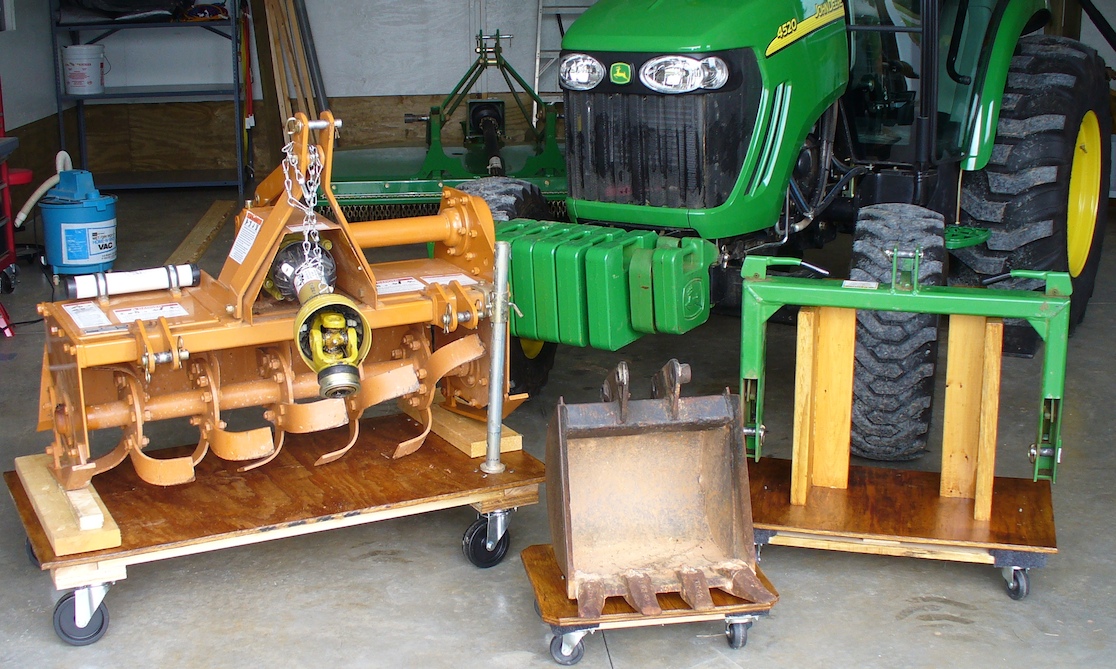

Mike, Buckeye here are some dollies I've done.
Mike, that looks good :thumbsup: I went the iMatch and TNT route, so I don't have a dolly for my MX6 cutter, sickle bar mower, box blade or land plane.

Mike, I only have dollies for attachments I can't use the with the iMatch. The tiller is so small that I can only use it with my 21 HP Kubota B21 TLB. The post hole digger (PHD) can't be used with the iMatch, so it's on a dolly. And when I use the PHD I have to take off the iMatch, so it has a dolly.
My other bucket for the backhoe weights a lot, so putting it on a dolly helps when I change out to that and helps store it. My front blade and blower for the JD 318 garden tractor are on funny looking low deck dollies so they can be put on with relative ease.
But the box blade, MX6 rotary cutter, sickle bar, and land plane are iMacth and have no dollies- I have to put them where I want them. You can see in the PHD picture the MX6 and sickle bar in the background. Part of what makes the iMatch work is having the attachment on the ground so you can push against it. It would be harder to put an attachment on with the iMatch if it was on a dolly than if it was on the ground. The top and tilt on the 3 point hitch also makes backing into the attachment and hooking it easy. Yes, you could lock the casters but I think you'd be stressing the casters and dolly every time you hooked up.
It's a good mix- enough stuff can move around that it can be stored efficiently. I've got one dolly left to make- I've got a 6' landscape rake that can only be used with the B21, so it needs to be on a dolly to make it easier to attach. Also, the older I get the more I like dollies and my iMatch :).
