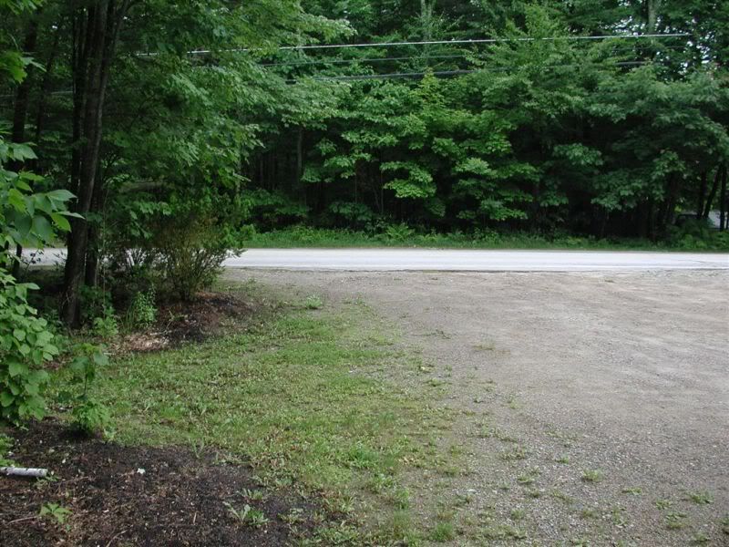

I don't have a lot of really good usable pictures up but I have 2 online. These are both shots before we refreshed the driveway which had growth at the edges.
This one is from the side of the garage looking at the street. Might be hard to tell the steepness of the driveway - but its steep.

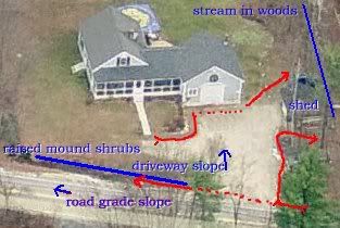

And another I captured from a birds eye view on bing making notes:
Red: mentioned drainage notes/changes, dotted is driven over.
blue: what's there.
Street run off to driveway drainage channel would be directed on the other side of a built up mound with bushes avoiding the driveway altogether and ending up in the woods on the other side of the property.
Other drainage would run to a stream in the woods next to the house (diverting around a shed there now I didn't mark)
Garage is raised maybe 3 inches from driveway and has a poured concrete apron. Drain channel also ensures if I topcoat water has a place to go instead of all in the garage.
blue: what's there.

Looking at your overhead pic: standing on the road and facing the garage, I would make a drainage swale on the right side of the driveway and direct the water into the woods towards the stream.
The swale should be at it deepest/lowest point at least 3 or 4 car lengths out from your overhead door, then continue the swale to the garage rising up from that low point. The swale should be gentle enough to be mowable in summer.
Then do what you can to put a crown on the driveway keeping the crown more to the left side of the driveway farthest from the swale.
Getting your drainage setup is required no matter what you do later and will help right away. If you get the drainage working well, you will have a much better idea about what is needed. I wouldn't use plastic pipe along a driveway, the frost will work it up over time.
