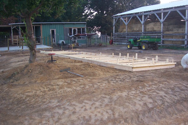

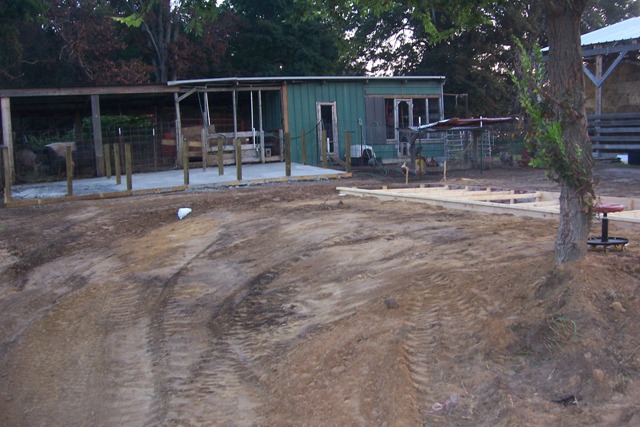

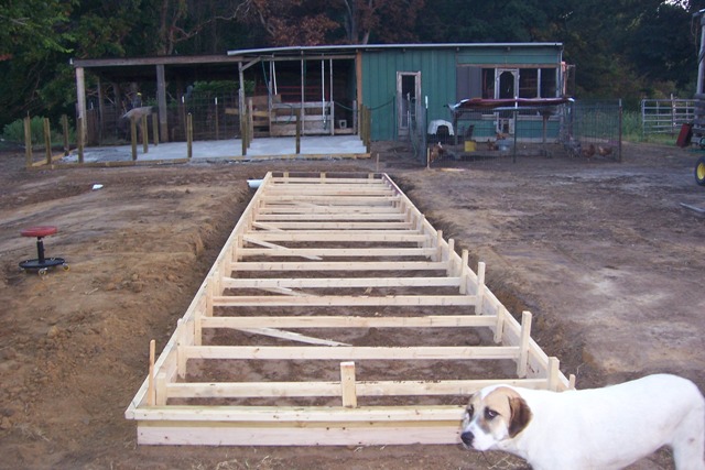

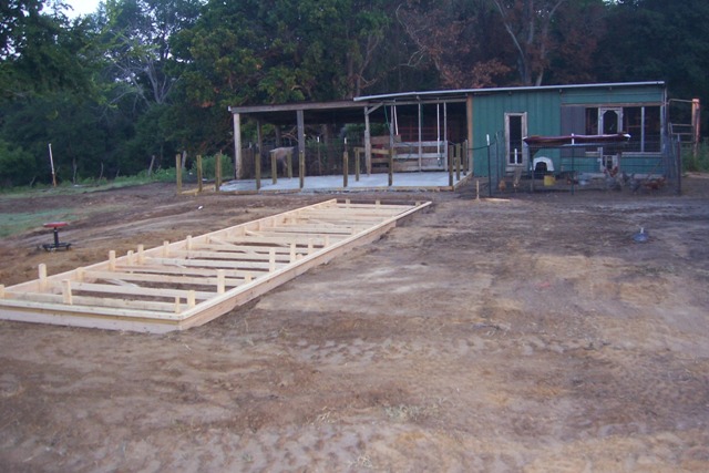

I needed some more outside pens for my pigs and decided to build a farrowing house ... here are some shots of what we are doing. In the background a slab with post (they will support the gates) a very large slop so the waste will run down to a pending gutter.
The forms in the foreground are where the gutter will be for the farrowing crates ... I need to form the slab for the building ... 18X40 finsihed inside and out. I have purchased the used farrowing crates, feeders, waters, fans ... the gutter under the crates will slope from 3.5" to 16" over 35' at the far end there is a 6" pvc pipe with a plug that will lead to the waste holding area ... where it will be allowed to "cake" and then loaded with the FEL into the manure spreader for fertilize on the pastures and meadows.
I had a great time using my backhoe on the JD 5520 ... getting better everyday!! Hoping tomorrow to finish the forming for the rest of it and then pour Friday Morning ... hope to remember to take more pictures.

Is the castered shop stool for the dog to sit on while supervising?

Yes sir ... that dog knows excatly when to take a break ... I'm always saying get your lazy arse back to protecting the chickens !!!! Thats just too funny of a story ... imagine being checked in at county in a feed sack!!

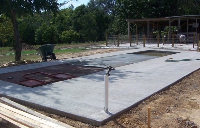

Poured 14 yards this week ... $84 a yard ... still have to pour the gutter then the building will go up.
I know ... Picture's ... soon I promise.

Got the gutter poured and started putting the floor frames and the mats down... hoping to dig in the electric lines next week.103_7897.JPG
