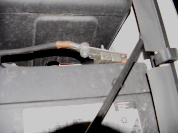

Donny,
Here is a (very poor) photo of the winch connection on my car. It is 2-50amp circuit breakers wired directly to the side post on my car battery with #6 wire. Hope this helps.
Greg

   / Does the B7500 have a fuse box??? #10
I'd be interested in seeing the connection proposed by the person you spoke with.........................chim
