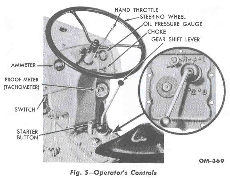

Jodi, I have an old 8N Operators Manual and I'll try to help you. I'm attaching a photo to this post that shows all the main operator controls. You also need to know the location of all oil dipsticks, where to add oil and what type to use, air cleaner servicing, and how to clean your radiator and check the fluid. these are all normal things that need to be checked often on an old tractor. If you can get some help from your dealer or someone else who can give you one-on-one help, it would be the best. Otherwise, I'm sure if you have a specific question, you can get a great answer right here on TBN.
<font color="blue">
Some people replace the old ignition switch with a standard one that doesn't use the starter button. They do that because of problems with the standard starter button or for other reasons. You can check that by turning the key past the ON postion to see if the engine cranks. If it does, you don't need to use the starter button as noted below. Can you see a wire coming from the base of the starter button? If not, it may not be hooked up. Also, the old starter solenoids had a button on the bottom you could push up and that would power the starter. That's probably too much info for now, but if you know what a starter solenoid looks like, it is under the battery in front of the steering column. You can see it by looking behind the air cleaner area.</font> <font color="purple">Oops! The solenoid on an 8N is in front of the battery on the left side, I believe. /forums/images/graemlins/blush.gif </font>
Here is the procedure in the OM for starting the engine:
"To start the engine, turn the ignition switch ON, and partially open the throttle (Hand throttle below steering wheel - pull toward you to open, push away to close). Hold the clutch pedal down and put the shifter into Neutral. (The procedure says to continue to hold the clutch down during starting, but if it is not very, very cold, you can realease the clutch after putting the shifter in Neutral.) When the engine is not warm, pull the choke out and hold it while pressing the Starter Button on the top of the transmission casing. (If the transmission is not in neutral, the starter button will not operate the starter.) After the engine starts, use the choke as required to keep the engine running smoothly until it warms up."
When the engine is warm, starting the engine does not require use of the choke. As a matter of fact, choking the engine excessively may cause flooding and the spark plugs may have to be removed, dried, and the cylinders vented. Also, these older Fords are notorious for having condensation collect in the distributor and cause hard starting. If you can keep your tractor in a dry place, it will make it much more reliable.
I'm going to try to not give you too much info at once. This and what others have said should get you started. I'm sure Soundguy will also have some excellent advice. Good luck with your 8N. The only thing I might remind you is that the 8N is a gasoline engine. Don't make the mistake of filling the tank with diesel. /forums/images/graemlins/blush.gif /forums/images/graemlins/smile.gif
