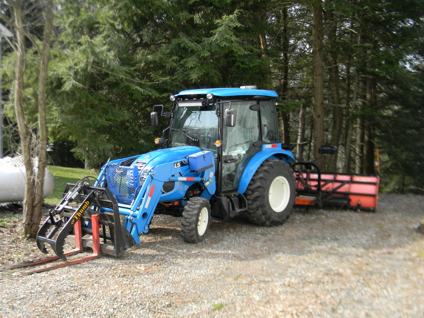

As mentioned, Skid Steer attachments run at higher GPM than your standard compact utility tractor but there are companies making and selling hydraulic implements that will run on lower GPM tractors. The basic tractor GPM will not be enough to run SS equipment.

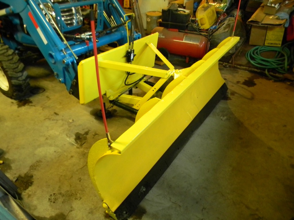

My tractor came with 2 sets of rear remotes. I bought my own hose and quick connect fittings and ran the hoses from one pair of remotes under the tractor to the front. Now I can hook up my QA snow plow and use the remote lever to angle the blade. I also have a hydraulic thumb on my forks that I can operate with the same remote lever. Here's a couple pics of mine.
There are PTO driven pumps with a separate reserve tank available that can be plumbed to the front with hoses that will run any high GPM SS equipment.
Universal SSQA only means that Skid steer attachments can attach to the loader arms. Things like buckets, forks, bale spears, etc. will attach and be ready to use as is but SS attachments that require hydraulics won't work very well due to not enough GPM on the tractor.
