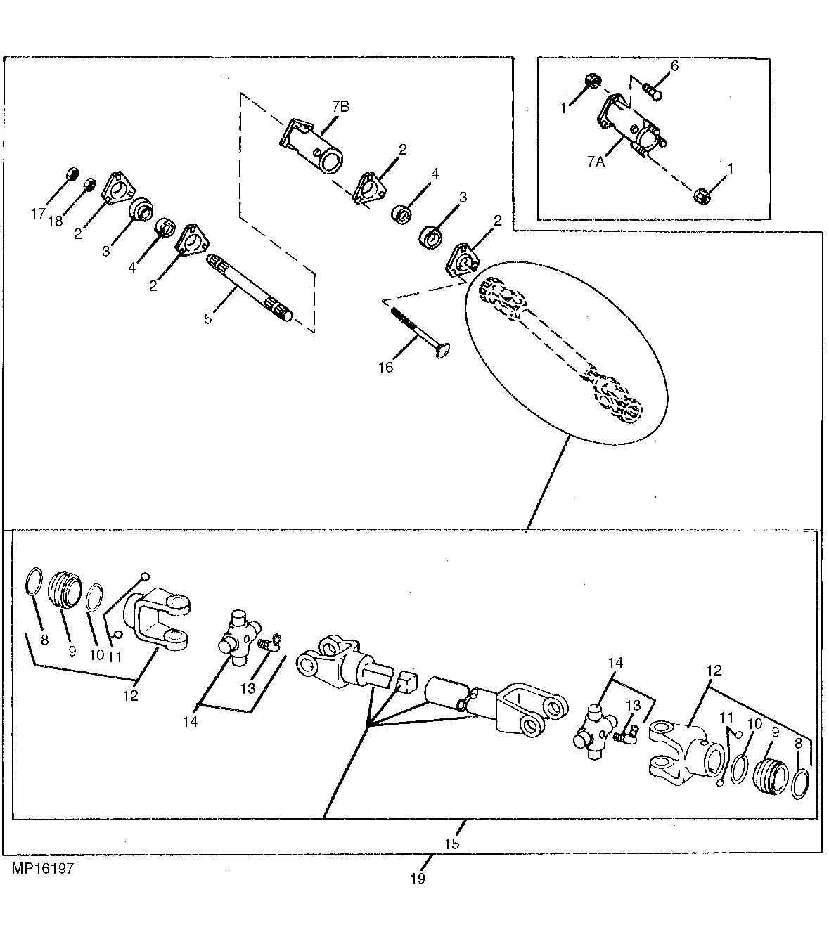

As the title says, I have an older Yanmar 1602D, which has the same engine as the 755, and I would like to add a front PTO (which I'm going to have to build).
It would be a big help if any has (or can take) some pictures of the front PTO (from the motor out) on their 755.
Thanks,
Rob
   / Does anyone have pictures of the Front PTO on their 755? #2
I didn't know they had "front" PTO's till I just looked in JDparts...but it appears to just hook through the front quick hitch and connects to the mid-PTO to power a snowblower or a broom.
I don't think there is a front PTO that is driven from the engine?
That's not what I was looking for : )
I was hoping that it was off the front shaft of the motor....
Back to the drawing board....

   / Does anyone have pictures of the Front PTO on their 755? #5
KennyD is correct. No separate front PTO. All front implements are driven from the mid PTO with the long shaft he shows.

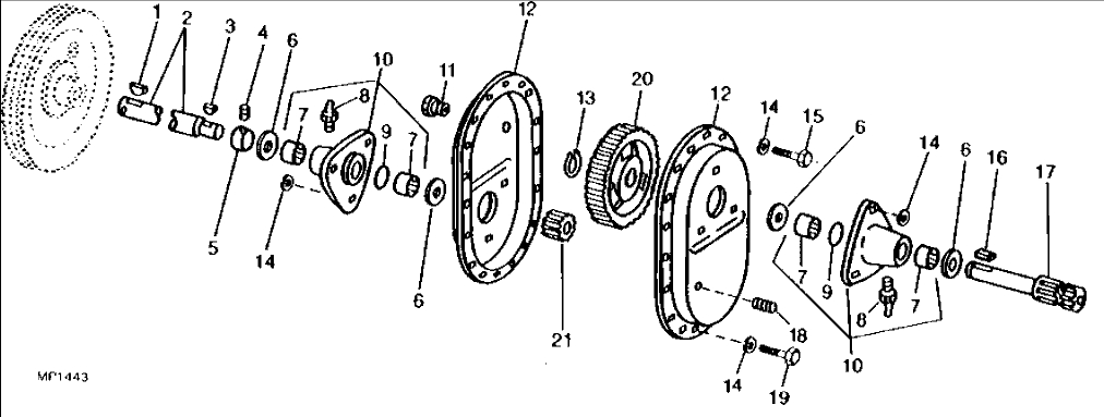

   / Does anyone have pictures of the Front PTO on their 755? #6
The JD 430 L&G tractor used that same engine and offered an optional front PTO kit. It required adding a separate gear case.

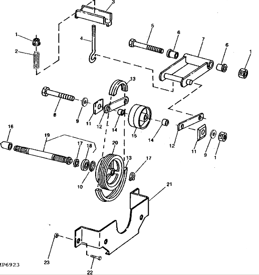

   / Does anyone have pictures of the Front PTO on their 755? #7
I remembered the full story on the 430. It had an engine belt driven PTO shaft below the front of the engine that would connect to the MMM. The gear case accessory would connect to the front end of that shaft and reduce the 2000 rpm to 540 rpm for front implements. There was an electromagnetic clutch on the belt drive. Overall, a garden tractor setup not at all like the transmission/clutch/PTO setup on the 755.
