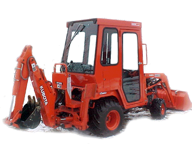

I am still trying to find a cab to fit the BX 22 and so far, I have only located one manufacturer. Laurin in Canada. Winter is coming and I know that it is going to be another cold one, so protection is definitely going to be needed.... thanks....
Laurin Cabs.......

rear view of cab......

I have a 2200 with a cab.....In the spring it takes but 10 minutes to remove it for summer work. It is a Sims and has a hard window in the back so using the BH with the cab would be next to impossible.
The cab has a heater, defroster, and two forward and two rear lights. Fit and finish is good. Keeps me warm and dry when plowing or blowing snow.
Sims is in Worcester I think

How much difference is there between the BX22 and BX2200? Sims has a cab for the 2200 and maybe one for the 22 if it is different. Give them a hollar. Here is their site Sims page
   / Does anyone have a cab on a BX22???
With the hoe off the tractor, the two (BX22 and the BX1800/2200) are the same tractor for all intent and purpose of fit, with the exception of the ROPS. The BX 22 has a higher ROPS than the others to accommodate the hoe. This is where the problem arises. The ROPS fits inside the cab and being higher on the BX22, this just won't work. I contacted Curtis in Worcester MA and asked them about it, but they at present don't have any intention of making a cab for the BX22/23 series, because of lack of sales interest. /forums/images/graemlins/frown.gif
   / Does anyone have a cab on a BX22??? #7
The ROPS on the 2200 fits outside and behind the sims cab. There are two brackets that bolt on the cab and fit around the rops. I am not sure if the hinge on the 2200's rops would cause a problem or not.....
   / Does anyone have a cab on a BX22??? #8
I have a Curtis Cab on my BX2200 and the ROPS is outside the cab. The cab should fit without the backhoe on the tractor but I would check with the cab manufacturer first.
