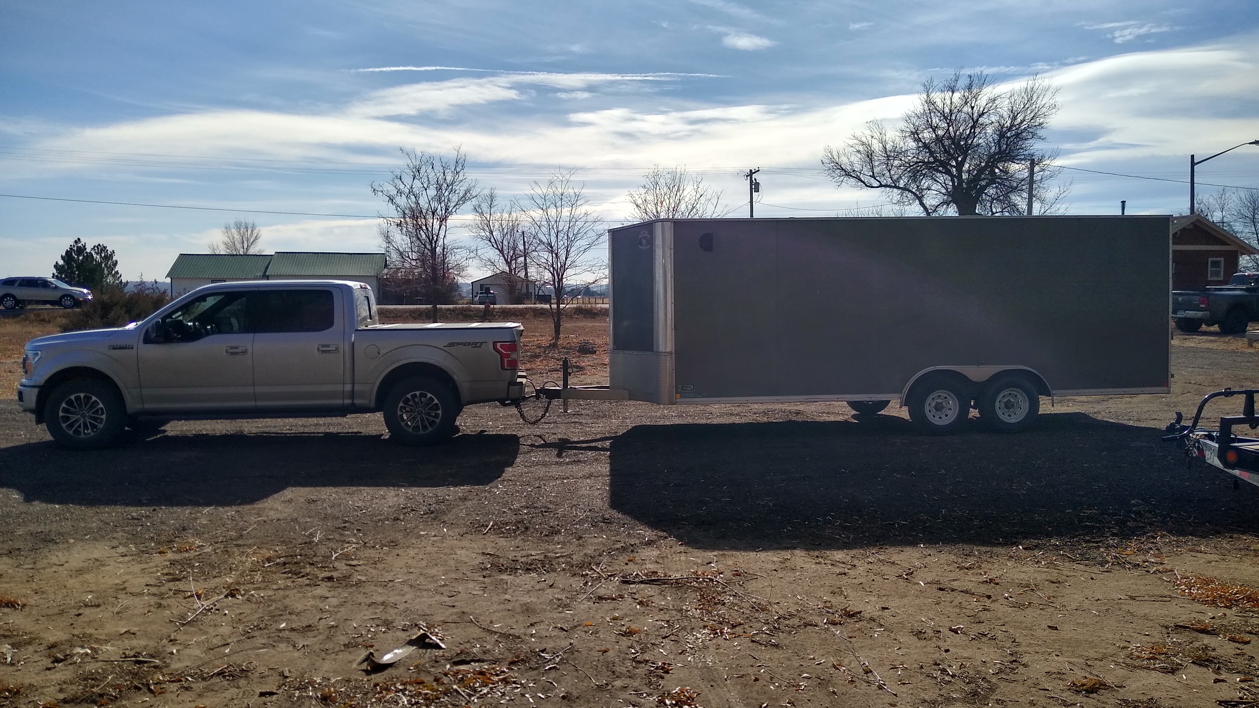

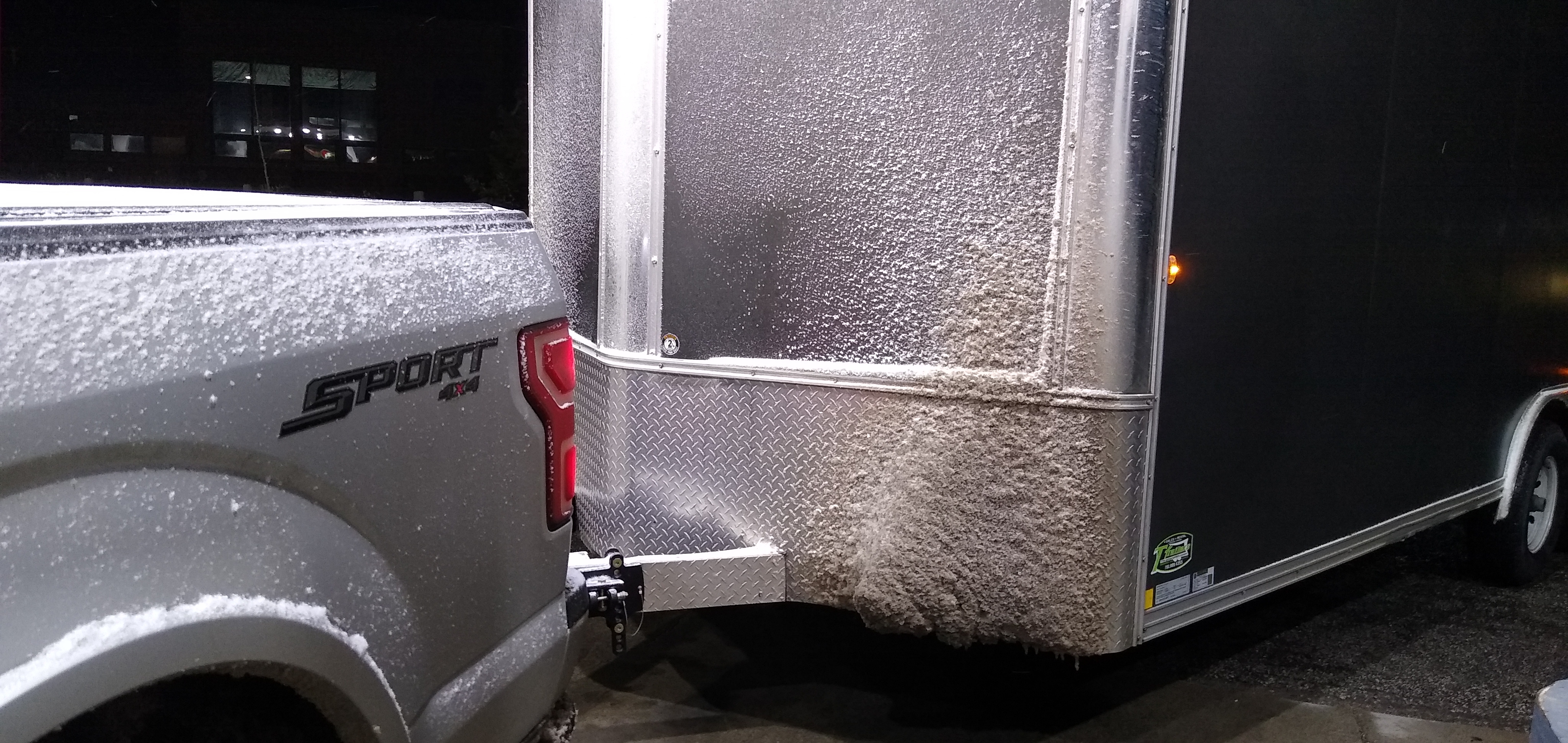

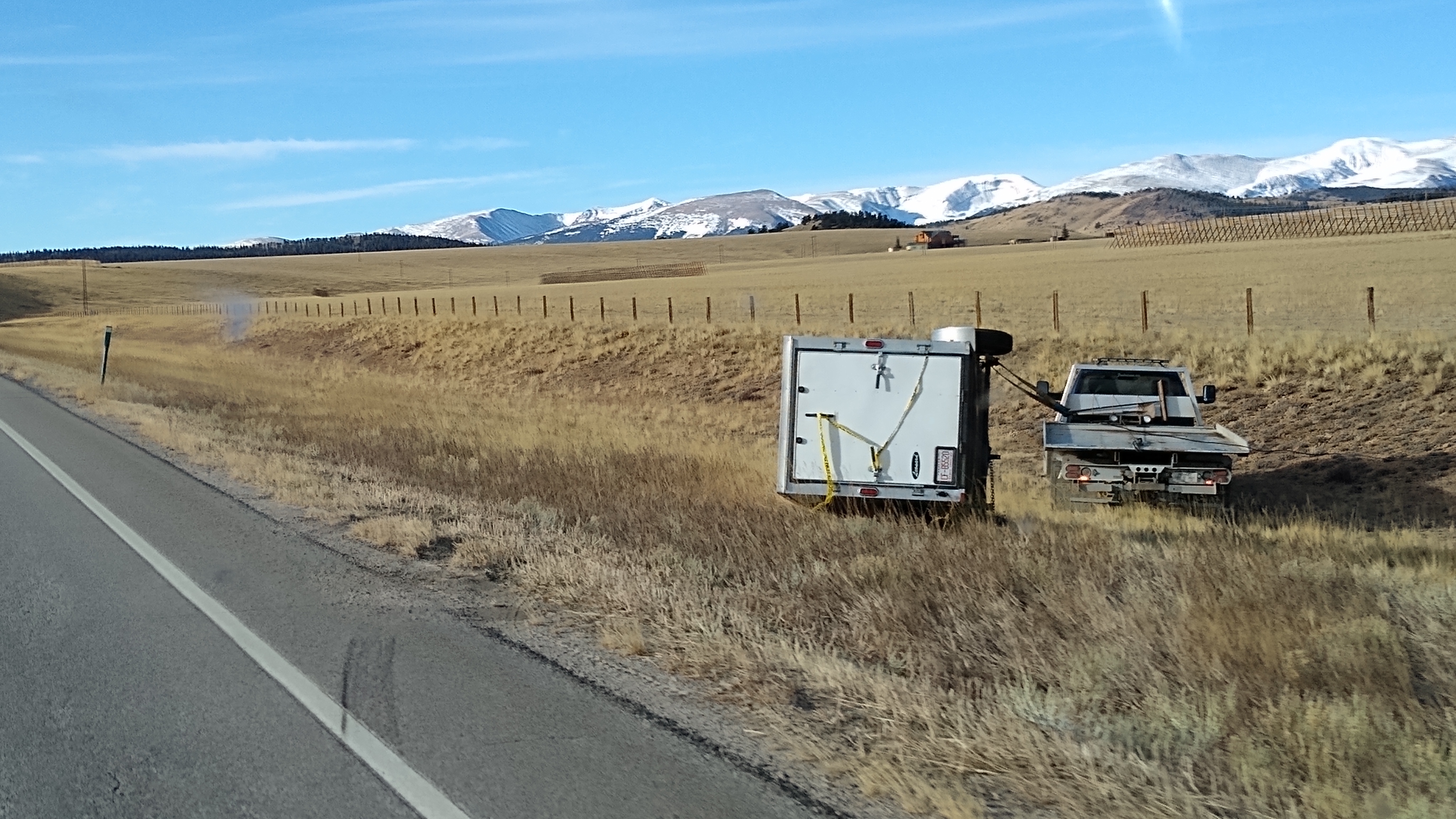

I had to complete a house move under the WORST circumstance imaginable a few years back. December in the Rockies at 9.5Kft with 100mph wind gusts. I had to go over several winding death drop passes, including Vail pass heading west. I rented a 25ft enclosed trailer, bought some E rated Nokian studded snow tires and a weight distribution hitch. 250 miles each way and had to do the trip five times to complete the move.
Oh and I'd never towed with this truck before (2018 4x4 f-150 with tow package and locking rear diff)
I own a lot of heavy crap and I estimated the trailer and contents at about 10-11,000lbs on a couple of the runs. The truck was rated to tow 12,000lbs IIRC.
I kept an eye on that wind forecast. You can see from the attached pics what the wind does to the unsuspecting.
Pretty sure I have PTSD from the experience. That wind will blow over a semi.
Anyway, the 3.5 EB had more than enough power. It controlled the speed on vail pass decent OK (2nd gear). But the suspension just wasn't up for it. Just the vacuum from passing RV's or box trucks would cause the rig to wander in lane. It was a harrowing experience that I don't want to have to repeat, but we did make it.
