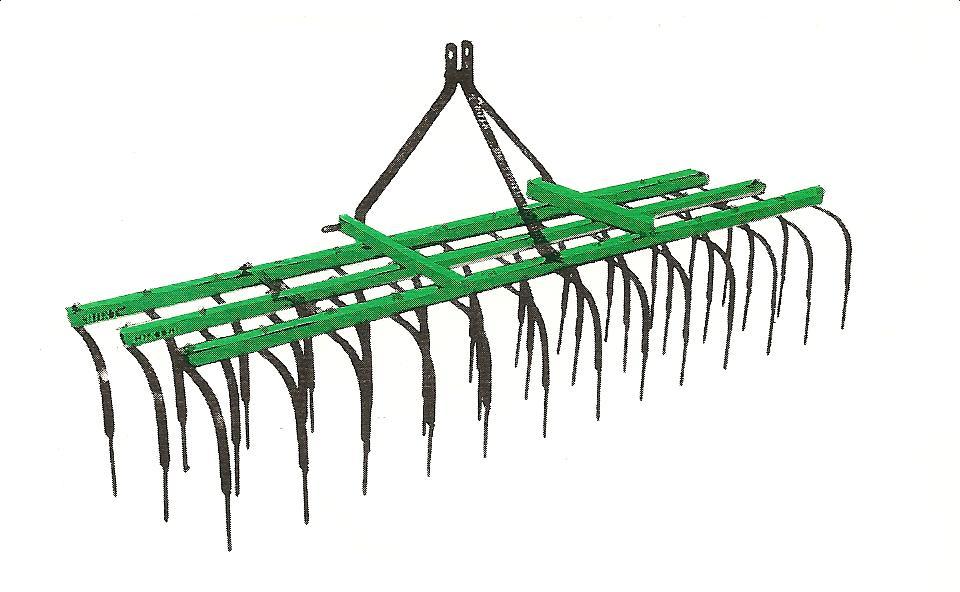

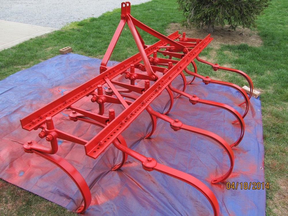

Does any angle steel come with holes in it? I'm building a small cultivator and could use some 1/4" thick angle iron punched with holes like the steel shown in the attached photo. I've searched the info I have and can't find anything with holes in it. I could use some of that super duty sign post material because it's pretty thick and punched with holes but stock steel would be better. Either that or drill a bunch of holes.
Anyone know if steel angle iron comes with holes in it?

flyerdan--I have to dill either 39 or 52 holes...most likely 39. Mudstopper...that's a great hole drilling idea but the cost for a one time use is too much.
There is a fab shop near me that would punch them but not sure there is enough room to get in there. The thought is 1 1/2" equal angle by 1/4" thick. Sounds like I'm drilling them.

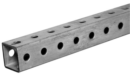

What about redesigning it to use larger perforated square tubing, which may be about the same strength as a smaller, thicker angle?
