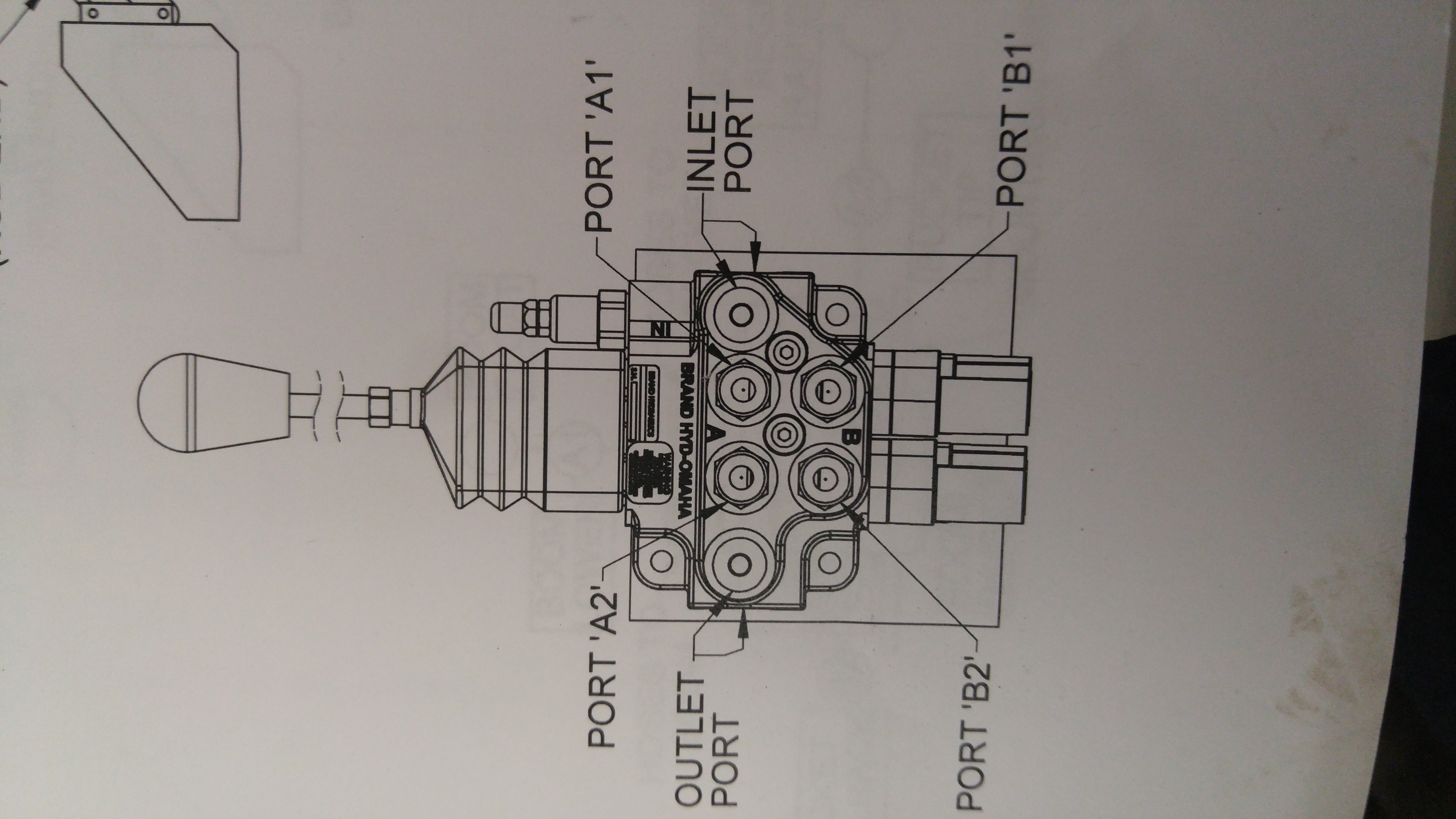

i installed a power beyond kit to power my backhoe and outriggers on a 1999 Earthforce tractor. it appears that screwing in the power beyond port kit blocks the tank port. this is on a brand hydraulics LV22RFSTKA2B. If so where would tank port go?

There is two in ports and two out ports. The power beyond is screwed in to the end of the valve on the out end of the valve. There are six ports on the face. Two for boom and two for the bucket. One of the remaining two ports is an in port and the one perpindicular to the power beyond plug can be used as a tank port.
   / Does a power beyond port kit block the tank port on loader control valve? Brand LV22R
using the picture, If I hear you correctly then the outlet port next to A2 can still be used as an outlet port?

thank you i guess the kit doesn't block the port totally and allows for ample fluid flow to tank.

Many of those PB plugs simply separate the tank line from PB.
