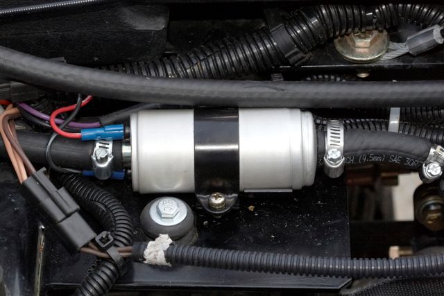

As in an earlier posting, this engine has a serious problem in that after using the Toro ZMaster which it powers is used for mowing for about 45 minutes, the fuel filter empties of fuel and the engine dies. Let it sit for 5-15 minutes (depending upon its mood) and it starts back up as good as new and then that repeats all day long. The fuel tank selector valve and fuel pump have been replaced. I have tried leaving the fuel tank caps loose as well as extra tight and the dying issue also happens with both tanks. This problem started at 52 hours on the hour meter, the dealer needs 2-3 weeks of wait time until they can get to it and another possible week to get parts if they can figure out what parts.

The fuel pump shuts down when the engine stalls (remember that it has been replaced). When the key is turned to the "prime the pump" position, the pump whines as usual and fills up the fuel filter -- but when the engine is starved for fuel, the fuel pump is HOT and even though the fuel pump fills the fuel filter, the fuel empties immpediately--usually bubbling as though it were boiling. Ten minutes later, the fuel pump will fill the fuel filter and it will start up and fun fine. I cannot help but wonder if it is the DFI controller that is having a senior moment--even at 52 hours.

Yes the gas we get here is blended. I'm not sure what the % is. As far as being careful on filling the tank thats not what I'm woried about. New tanks if they arnen't carefully cleaned at the factory you end up with plastic shards that get sucked up and stick to the intake screen. I checked our fuel pump after it runs a while you can't touch it. It's pretty warm. It sounds like there is a sensor problem telling the fuel pump to shut down. I didn't see any thermal switch to shut off the fuel pump. I guess vapor lock is possible... where is the fuel pump located on the machine?
Does the machine start right back up after it stalls? I was thinking you could instead of blowing back through the lines pull them out of the tank and check the ends of the lines for stuff. I'm pretty sure they use top draw on them.

The fuel pump is located just to the left of the seat behind the fuel filter and fuel tank selector valve -- easy to see and easy to get to.
The engine will not start up immediately after a stall -- the fuel pump attempt to fill the filter, but the filter empties as fast as the fuel enters it. After a 10 minute wait, it starts immediately and runs fine for another 30-45 minutes.
It sounds like a good idea to check for the plastic shards (sometimes such things are NOT cleaned out like the aluminum millings that were left in the transmission housing of my first JD 4400HST tractor which destroyed the hydraulics, hydrostatic tranny, brakes, etc.).
It is interesting that you are using blended gasoline. I found a Toro "Master" service center today that was glad to chase down the problem even though I did not purchase the ZTR from them -- eventually they ended up with some conversations not only with Toro tech support wondering about the blended fuel and vaporlock but Kawasaki stating that mine was the 6th such incident with that engine and that they were sending out a new fuel pump that was designed to solve the problem of vaporlock -- that the fix was a Kawasaki engine part number and not a Toro part number. At least there is now hope!!

This is an obvious clue. A good test would have been to use freon, co2 or water to cool the pump and see it it "cured" the problem.
Sounds like your nightmare is almost over.
